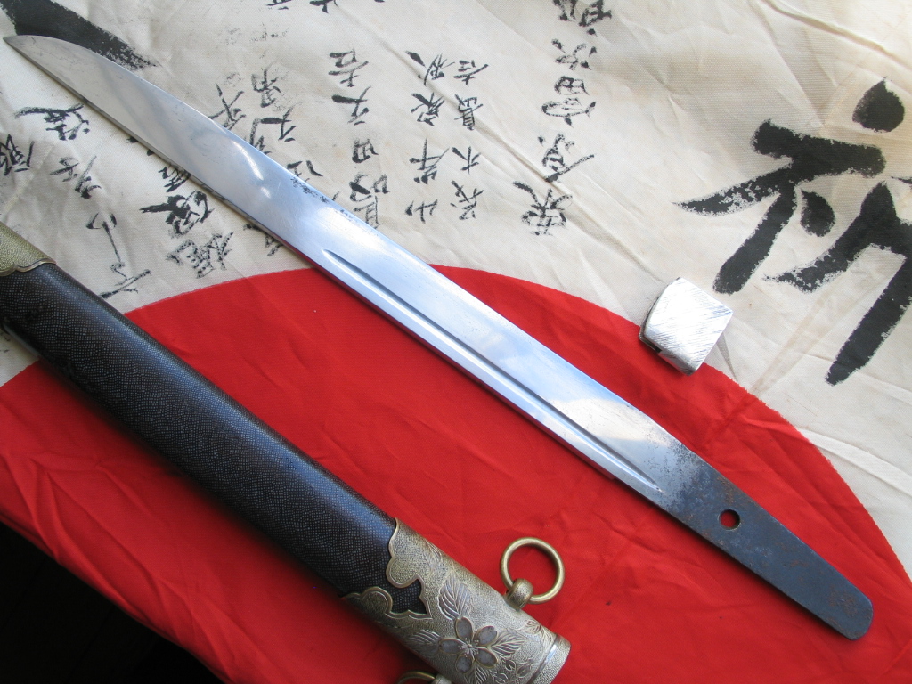

Hello Thomas!

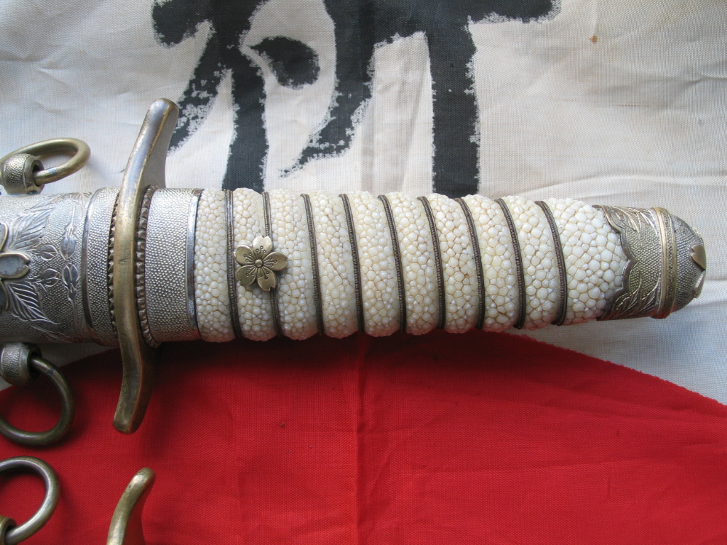

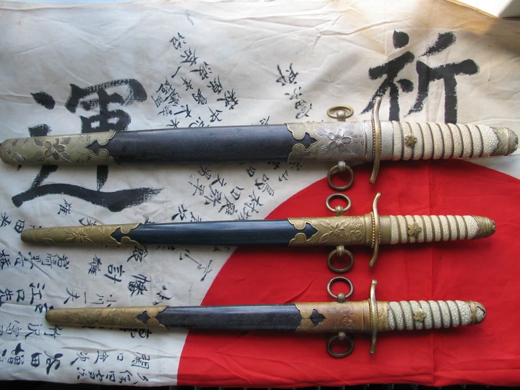

Impressive mounts!

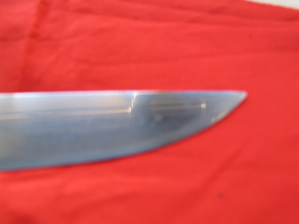

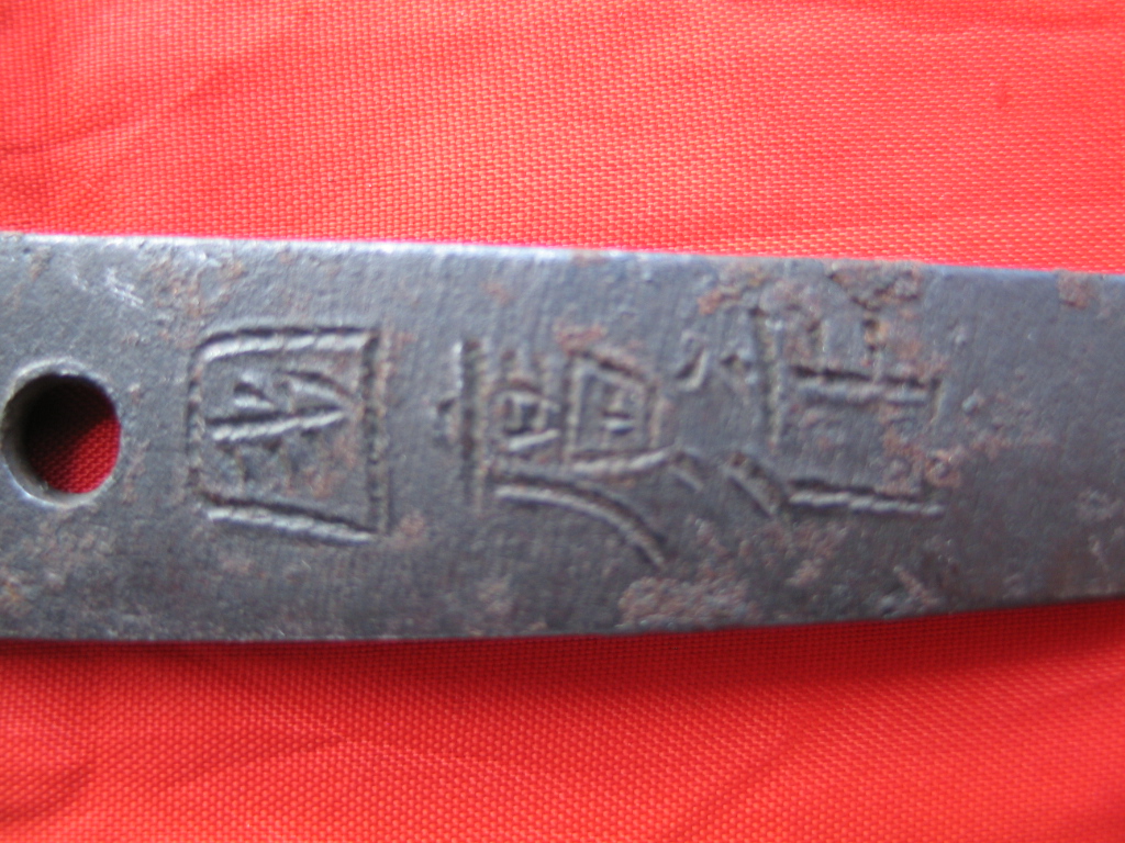

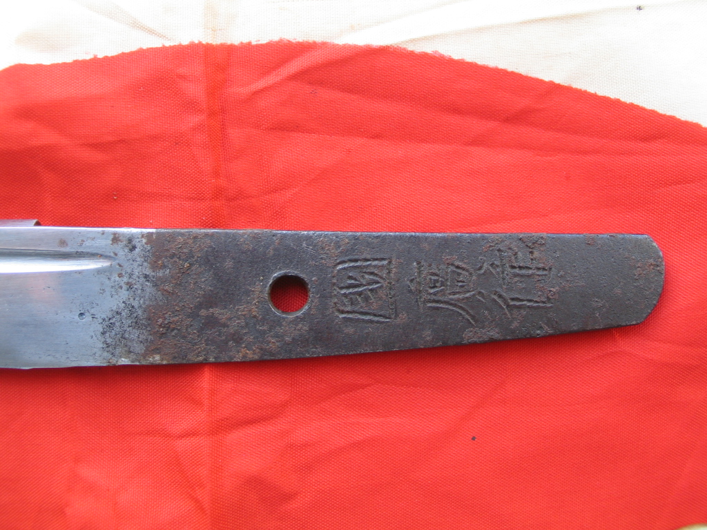

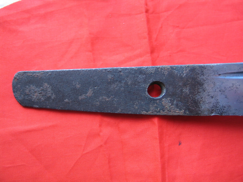

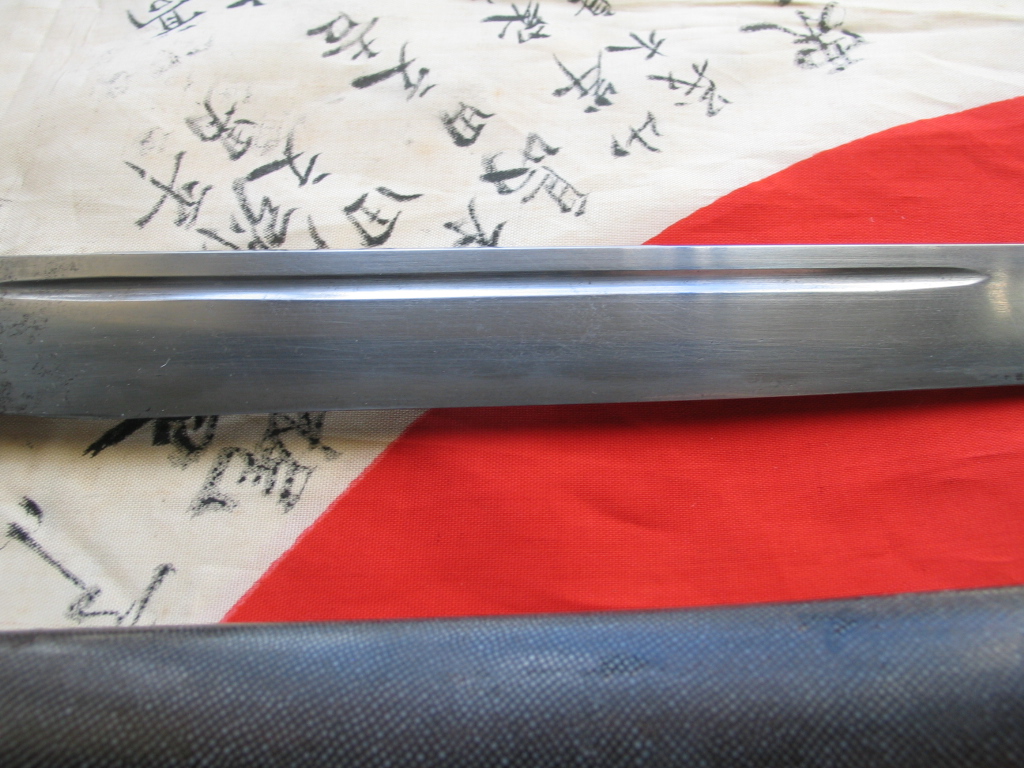

Somehow I get the feeling that the blade is from the 19th century (Hada is not really visible, habuchi is dim, and the mei looks rather young, and not too elegantly carved). I may be mistaken as well, but I'd say the blade is definitely not from the 14th century, probably not from the 16th, either. There was a number of Kunihiros also in the 19th century.
This is a personal and unlearned opinion only. Please wait for more knowledgeable answers!
BR, Veli
Yes ,its very impressive mounts.

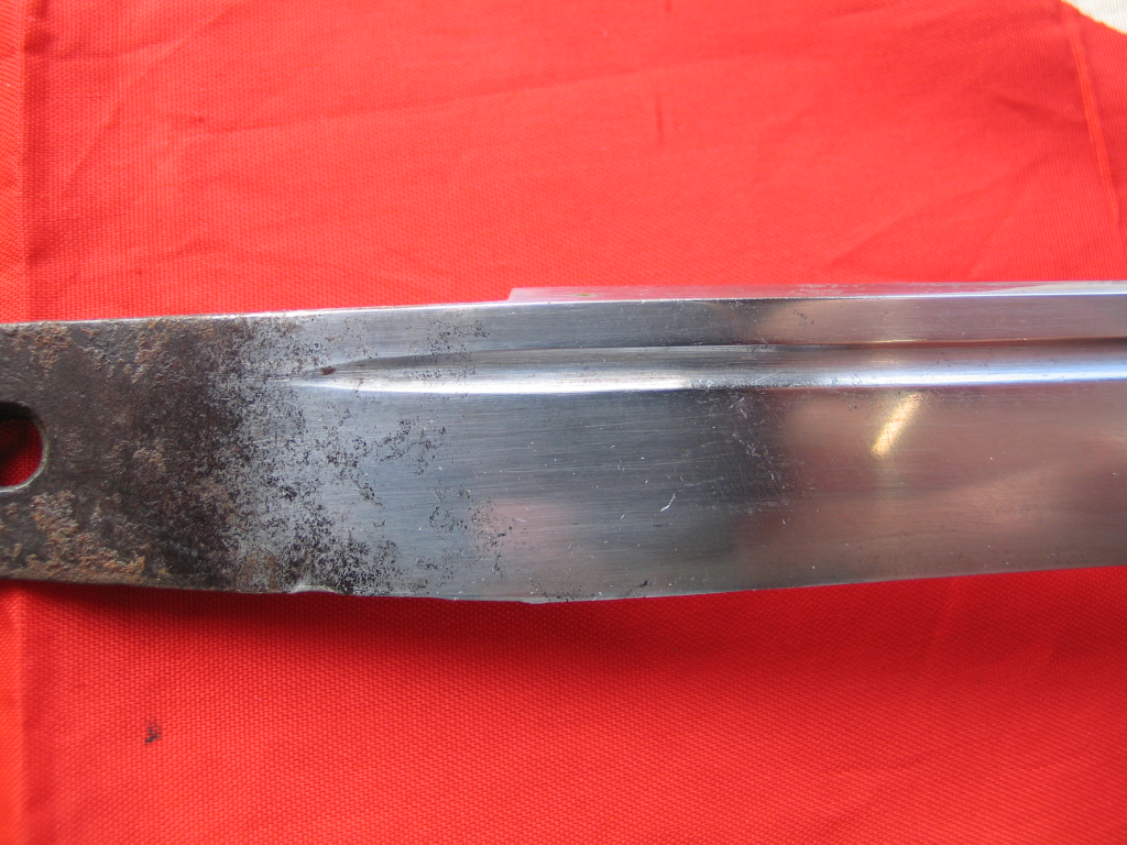

My pictures didnt catch the hada . but its there. It looks to have been polished many times due too the missing hamachi.
Compared to an another older blade I got with 3 mekugiana .this mei is very well done.
The blade is much thinner than the nakago , due to many years of polish.
Looking forward to se if theres any other blades out in the collections from the same smith.
Well, as I said its all guesswork. The nakago patina looks indeed older than 19th c., but the burr in the mei still has sharp features. Furthermore, there is only one mekugiana. The depth of the chiselling varies a lot, especially in the "作" -kanji.
BR, Veli

Is it possible too find out which Kunihiro it is?
What do I have too look for in the blade?
Any opinions helpful. Should I get it polished?

It may well be an older blade than what I first thought. However, tanto were rare from mid to late 17th century. Also what is peculiar, the blade seems to be polished several times, but there seems to be no hadaware visible in the photos (Thomas, can you see any ware when holding the blade in hand?). If the tanto would be a late koto one, I'd expect core steel and consequently some ware to show. The steel looks "tighter" than one would expect, which might indicate a late date of manufacture?
Maybe early shinto? Somehow I still think it is more recent, but I may well be wrong.
BR, Veli
