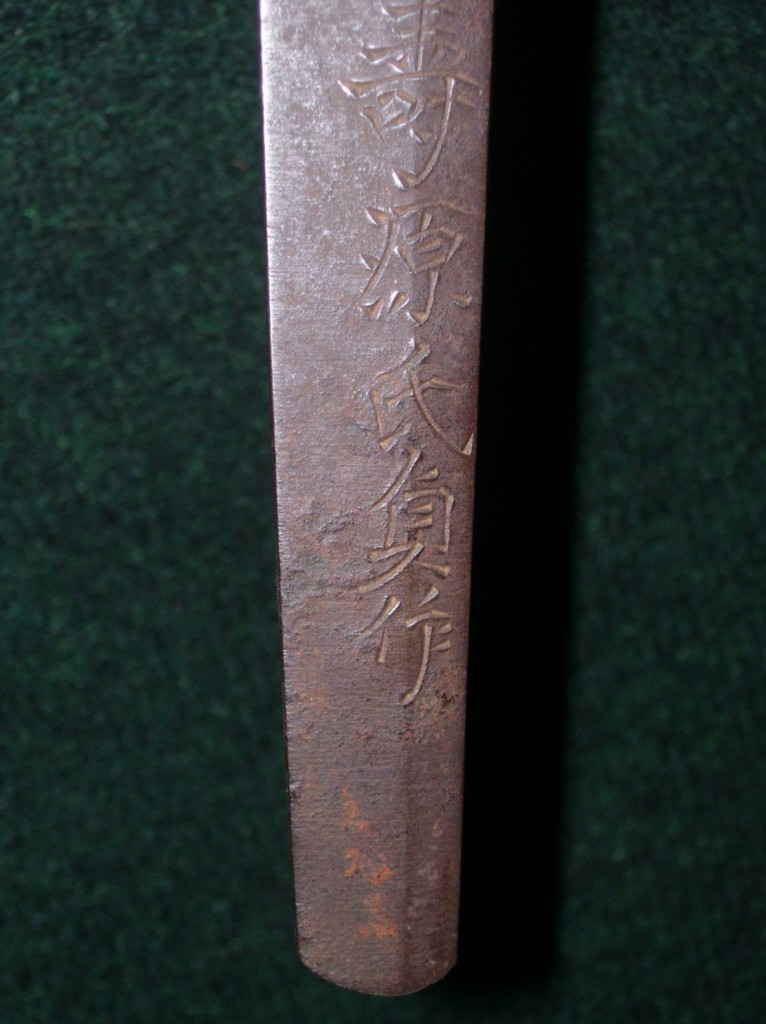

kfkonrad Posted September 27, 2010 Report Posted September 27, 2010 Greetings! My name is Kristian Franz Konrad. I need help reading and translating the mei on this blade: http://www.auctiva.com/hostedimages/sho ... 0&format=0 I believe this sword to be shinshinto, judging from the mei on the other side (One day in Februrary 1864 Genji). I am just a beginner at reading mei though, so please correct me if I'm wrong. Also... Any insights or rumors to the smith of this blade and his work would be of great help. Kris K.
Mark Posted September 27, 2010 Report Posted September 27, 2010 looks like maker is Ujisada but i twisted my neck looking at the pictures so did not check the rest
cabowen Posted September 27, 2010 Report Posted September 27, 2010 Ujisada of Matsuyama in Bitchu....
kfkonrad Posted September 27, 2010 Author Report Posted September 27, 2010 Thanks Mark and Chris! Any more info, or references to other blades by this smith and/or his school? Kris K.
kfkonrad Posted September 27, 2010 Author Report Posted September 27, 2010 Wow! Thank you for digging that up Jacques! I appreciate the help gentlemen. I normally don't bid on blades that are so beaten up, but for some reason, this one took my interest. The blade has serious hagire, and I can't imagine it to be worth much in it's condition, but I would love to study it. Thanks again for all the help guys. :D Kris K.

cabowen Posted September 28, 2010 Report Posted September 28, 2010 I own a blade my this smith. Picture below. It has a suguba yakidashi and large kobuse-choji hamon. Clearly there was a link to the Yokoyama Sukenaga group as this sword is nearly identical to their works...Very good sword. Dated Bunkyu 4.
