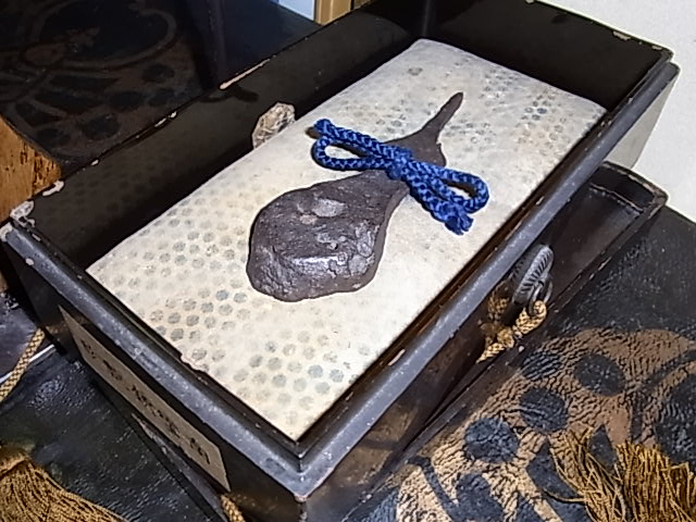

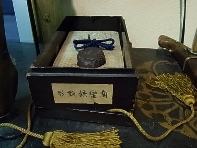

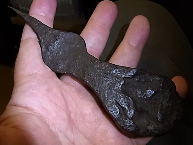

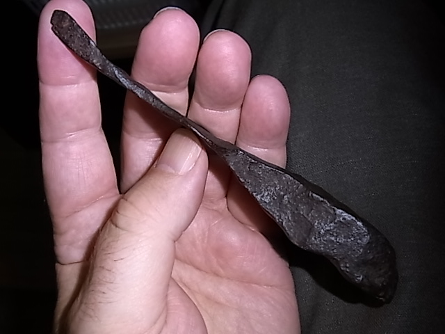

Bugyotsuji Posted September 25, 2010 Author Report Posted September 25, 2010 After a struggle I have somehow managed to get these pics. It is tied on a bed with a deerskin surface. Quote
Carlo Giuseppe Tacchini Posted September 25, 2010 Report Posted September 25, 2010 This is good to watch at how wootz looks like compared to folded steel, even if the crossguard doesn't show a proper Hada. Quote

Carlo Giuseppe Tacchini Posted September 25, 2010 Report Posted September 25, 2010 Bugyotsuji said: Aw heck, just missed it! Happy Birthday! :D No problem. I can wait the next one for your box. :D BTW, it got a nice patina, but this mean you'll never know if it's wootz. As it has been highlighted before, wootz pattern needs an etching procedure to be enhanced at its best. Quote
Bugyotsuji Posted September 25, 2010 Author Report Posted September 25, 2010 This box? You collect boxes too? Anyway, what makes you think I bought it? Quote

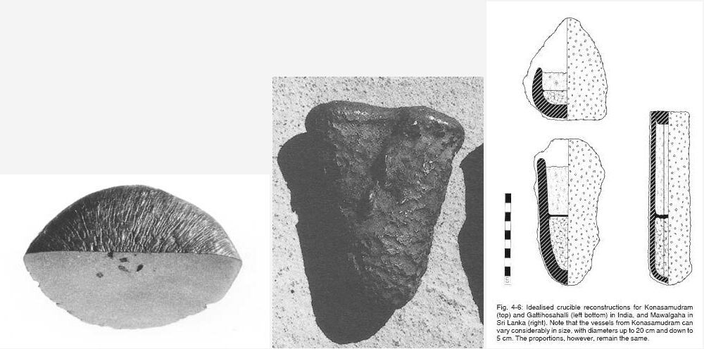

Carlo Giuseppe Tacchini Posted September 25, 2010 Report Posted September 25, 2010 Wootz ingots (unworked) should look like these ones posted by Mr. Pringles in another board. I had a pic of a more rounded one, almost perfectly emispherical, but I can't find it anymore. I guess the shape of the crucible could have changed from different locations. We should remember that crucible steel doesn't always means wootz, so the shape of the ingot is not definitive evidence. As suggested metallographic studies are the best way to sort out the matter. For comparison mr Pringles cites a paper by Verhoeven that summarizes data on genuine wootz as follows (to compare with Japanese data given in other posts/threads): Carbon 1.0-1.87% Manganese 0.005-0.014% Silica 0.005-0.11% Sulphur 0.007-0.038% Phosphorus 0.026-0.206% Copper 0.03-0.18% Cromium <0.01% Nichel 0.008-0.07% originally were : http://www.tms.org/pubs/journals/jom/98 ... -9809.html Quote
Carlo Giuseppe Tacchini Posted September 25, 2010 Report Posted September 25, 2010 Bugyotsuji said: This box? You collect boxes too? Anyway, what makes you think I bought it? hehehe.... you nailed me. Quote
Eric H Posted September 26, 2010 Report Posted September 26, 2010 When looking at the pictures kindly provided by Carlo, no similarity in comparison with the „Hyotan“ shape ingot is seen, and in the following article by J.D. Verhoeven and A. Pendray, Muse, 1998, those wootz ingots are described: „each ingot weighed about one pound“ or „as the quantities produced were in kilogram size cakes“. Further I cannot see any evidence in this article, that any trade with wootz has been made with Japan, the route of destination with wootz was ultimately Persia. It is likely that the age of steel using crucible processes began in India by the pre-Christian era leading to the wootz process. Thus the period spanning 300 BC to AD 1856 is termed as the First Age of Steel, whereby crucible steel making and cementation were two significant processes available for the production of steel. However, as the quantities produced were in kilogram size cakes applications were limited to small tools, cutlery and weapons such as swords. Tatara tama-hagane has been produced in Japan for about 1000 years. It was introduced from Korea in the latter half of the sixth century AD. By the 1660’s the Dutch also became involved in developing the iron industry in the Godavari delta of Andhra Pradesh. Indeed in the 17th century the Dutch Establishment is reported to have shipped from India hundreds of thousands of ingots of wootz steel. The Dutch traded in wootz from the east-coast port of Machilipatnam to Gamroan in Persia. It is believed that one shipment in the l600s alone contained 20,000 wootz ingots, where each ingot weighed about one pound. By the late 1600’s shipments running into tens of thousands of wootz ingots were traded out from the Coromandel Coast to Persia. In fact the range of these accounts coming from various parts of Southern India spread over an area of several hundred square kilometres indicates that the activity of manufacturing wootz ingots and selling them across the seas was almost on the scale of a semi-industrial enterprise in an era prior to the Industrial Revolution. It may continue to be puzzled. Eric Quote
Bugyotsuji Posted September 26, 2010 Author Report Posted September 26, 2010 A quick clarification. Although it has a Hyotan shape, this is not the original shape of any ingot or mold. An original patty of iron, (280 grams in the box above), seems to have been hammered out when still hot, pinched, and extruded again with a final twist. Kind of like a candy wrapping twist. Perhaps to demonstrate the purity and malleability at a glance. Oh, and I just hit it with my dinner spoon... Perhaps the sound of it also told the potential buyer something about the quality. (Imagine flicking a Tsuba) Quote
Carlo Giuseppe Tacchini Posted September 26, 2010 Report Posted September 26, 2010 Bugyotsuji said: A quick clarification. Although it has a Hyotan shape, this is not the original shape of any ingot or mold. An original patty of iron, (280 grams in the box above), seems to have been hammered out when still hot, pinched, and extruded again with a final twist. Kind of like a candy wrapping twist. Perhaps to demonstrate the purity and malleability at a glance. This is the point Piers. Wootz is freed by the oxigen-free-and-tight crucible only when entirely cooled. Hence he retains the shape of the crucible, often half-spherical. It's re-heaten at relatively low temperatures only for smithing out the blade shape and it's an hard task. More, it's better to have enough steel to produce the blade from a single ingot (not much loss of material in the process) because to weld two ingots together might be impossible without ruining the "watering" with the too high temperatures needed by the welding process. Quote
