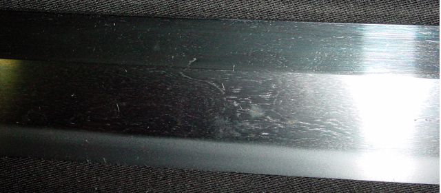

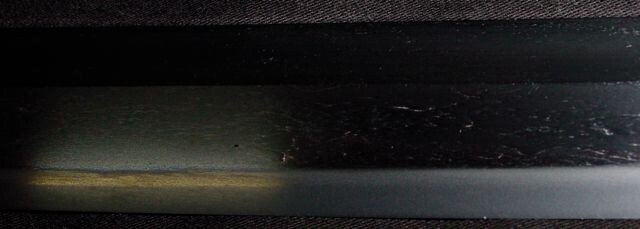

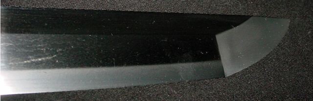

Eric H Posted September 21, 2010 Report Posted September 21, 2010 cisco-san said: I would be happy to see a pic from a overpolished blade where you can see the core steel! Konuka hada is associated with swords by the Tadayoshis. Generally the kawagane of their swords is thin and after repeated polishing shingane can be seen occasionally. Pic 1 from a Wakizashi by Tadayoshi III, Mutsu no Kami, in old but intact polish with a small hakobore. Pic 2-3-4 are from a Wakizashi by the same Tadayoshi III, showing shingane, the blade exhibits also mune-ware and one umegane, though not seen in these pics. The pics are enhanced Eric Quote
Veli Posted September 21, 2010 Report Posted September 21, 2010 Personally, I find the small hakobore like in Eric's picture#1 very easy to accept. I'd rather have a hakobore than excessive loss of metal during polishing. Extensive loss of Kawagane, on the other hand, makes me shudder... Veli Quote

cisco-san Posted September 22, 2010 Report Posted September 22, 2010 Eric H said: Konuka hada is associated with swords by the Tadayoshis. Generally the kawagane of their swords is thin and after repeated polishing shingane can be seen occasionally. Pic 1 from a Wakizashi by Tadayoshi III, Mutsu no Kami, in old but intact polish with a small hakobore. Pic 2-3-4 are from a Wakizashi by the same Tadayoshi III, showing shingane, the blade exhibits also mune-ware and one umegane, though not seen in these pics. The pics are enhanced Eric Many thanks !!! Quote
