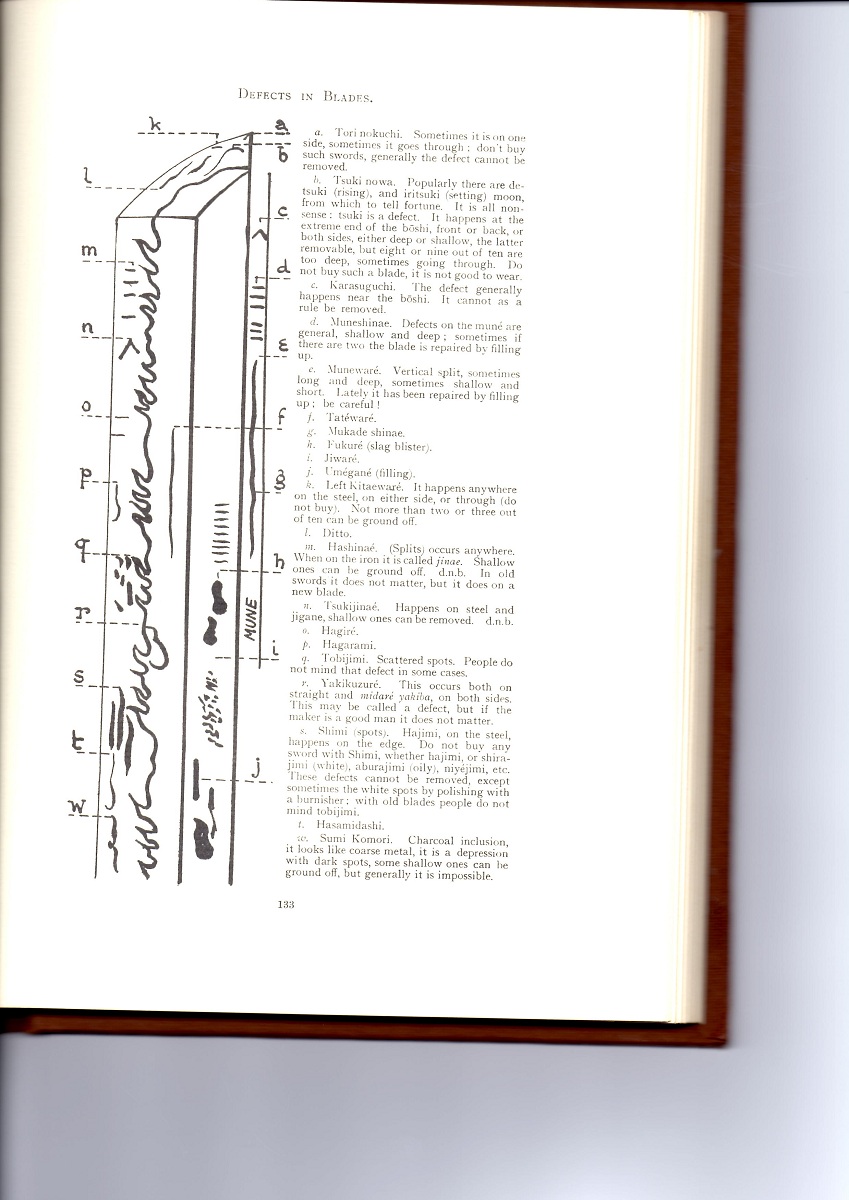

sanjuro Posted September 19, 2010 Report Posted September 19, 2010 I thought it may be helpful if a central reference point were provided. The attached page is from the Sword and Same' book by Joly and Hogitaro. I can find a no more comprehensive standard reference. I hope this is of some help. :D Quote

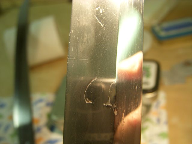

drbvac Posted September 19, 2010 Report Posted September 19, 2010 Great topic - especially since I have this wakizashi with a 1mm blister right on the edge - well I am not sure if it is a blister or delamination there due to it hitting something - anyway - opinions "fatal flaw" and/or would it polish out. Quote
loui Posted September 19, 2010 Report Posted September 19, 2010 Hi Brian, does it look like that on the other side? Quote

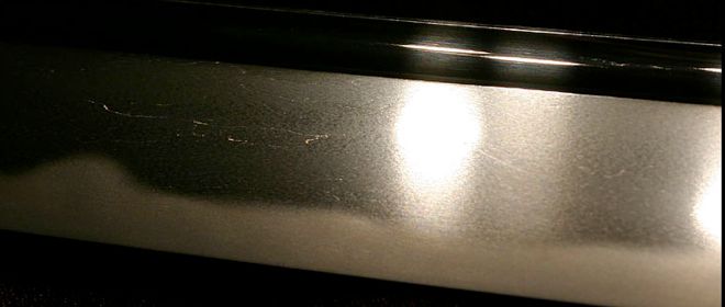

sanjuro Posted September 19, 2010 Report Posted September 19, 2010 To add another dimension here, something I have always found to be most unsightly and potentially fatal in a blade is the various shinae and ware encountered that run lengthwise in the steel. A long split in the jigane just above the hamon is particularly ugly IMHO. I would like to know how others feel about these flaws and faults. Quote
drbvac Posted September 19, 2010 Report Posted September 19, 2010 Louis: It is also on the other side and looks almost like someone filled in a nick in the edge and it didnt fill it all in Quote

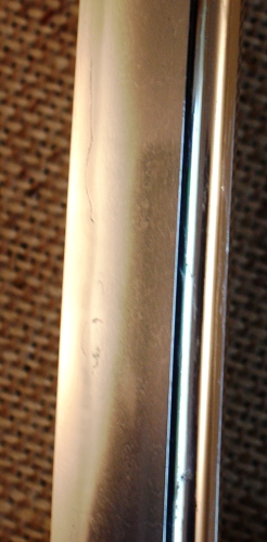

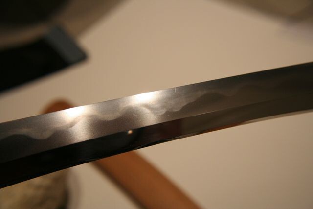

Marius Posted September 19, 2010 Report Posted September 19, 2010 Hi Keith, I have spent a lot of time with a blade that received Tokubetsu Hozon papers to Yamato Shizu. There is a weld line which has opened slightly (just to the point of visibility) within the hamon. (...). It would not achieve any higher level papers but is hugely enjoyable still and has many interesting features. take a look at the attached and see what you think Paul, splendid example of... well, exactly of what? A tempering crack? Or just an open layer? The first would be a very serious flaw. And I presume you would see it on both sides of the blade.... Quote
smac401 Posted September 20, 2010 Report Posted September 20, 2010 Evening all, I have read all the post a can say that being new to this is truly being new to something. All of you have been extremely helpful in you returns and I can say I am leaning a huge amount of information. You could say I am learning through the eyes of a child. I have a great mentor in swords and have met some good people and they are teaching me well. Since I have been looking at swords from a different perspective I guess I have learned enjoy the history behind the blades, having seen blisters, cracks, and some really wierd things involving blade care from varnish to grease, nothing suprises me. Keeping all that in mind and getting to the point I hope I never lose the desire to look at an entire sword for what it is, a persons desire to enhance their world through sweat and hard work. Each sword I have seen, especially the older ones have a story to tell, who made them, where they came from and possibly how they made their journey. I can find very few flaws in their work when they did so much with so little to enhance our lives and I believe most of the makers never knew their work would be held in such a high place in our lives. I guess what I am saying is what some consider flaws or faults I consider character and the story of the blade. This is my opinion of course. Thanks for all the information and enthusiasm, the website is the best and keep up the good work....... Steve M. Quote
paulb Posted September 20, 2010 Author Report Posted September 20, 2010 Hi Mariusz, Yes if it were a tempering crack I agree it would be a serious fault and I also would expect to see evidence of it on both sides. Also if it was a crack I would seriously doubt it would have achieved any papers from the NBTHK. Based on their defintions for awarding papers as listed on Danny Massey's site where it states that . Either zaimei or mumei blades may not receive Tokubetsu Hozon paper if they are significantly tired, have kizu or repair which impairs beauty of the blade. also Blades with hagiri may not receive Tokubetsu Hozon paper. . The line is only visible on one side and is a narrow opening which runs part way along a line of sunagashi. I am therefore confident that it relates to a slight opening of a weld line. At what point in its history this became visible we will never know. Again a guess from my side is that it has appeared relatively late in its life after numerous polishes. As said previously I would much prefer this not to be there. However the fact that it is shouldnt stop us from appreciating the remaining 27 inches that are without fault and exhibit some beautiful workmanship. Quote
sanjuro Posted September 20, 2010 Report Posted September 20, 2010 Paulb. The yamato Shizu blade is indeed a fine piece and the worst comment that can be made concerning the opening would be that it is 'unfortunate'. That however takes nothing away from the workmanship since as has been observed, There has been a few polishings of this blade which have ultimately revealed it. Is it certain that this is not a use related flaw? It would seem that at that age, the blade would have seen use and may have been stressed enough to open a weld line. Such damage does not always go through to the other side, and I have seen similar on swords that have been clearly damaged in use. Quote
paulb Posted September 20, 2010 Author Report Posted September 20, 2010 Hi Keith, the honest answer is I dont know. If I had to bet I would suggest it is something that has appeared from polishing over the years. It is possilbe that at some point a small amount of rust got in to the fold in the steel and subsequent removal has left that hairline opening. My simplistic view is that most stress damage is likely to form in line with the impact. I imagine the edge as being under stress logitudinally so if the edge hits someting sufficiently hard to start a crack those stresses will automatically pull away along the length. Hence hagiri are usualy perpendicular to the edge. I dont doubt there are exceptions but I dont think this is an example of one. Quote

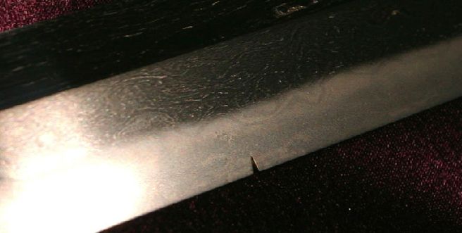

Eric H Posted September 20, 2010 Report Posted September 20, 2010 Most is said...generally the older a blade the more concessions regarding to the so called flaws are made. I add some pictures, all swords have designation Juyo Token. There is a story of a blade with a fukure and a couple of small kitae ware...nevertheless the sword was awarded Juyo Token based on its superior quality and the smiths high reputation. 1 - Go Yoshihiro 2 - Naotsugu 3 - Niji Kunitoshi 4 - Norishige 5 - Soshu Yukimitsu Eric Quote
paulb Posted September 20, 2010 Author Report Posted September 20, 2010 Eric, I have to confess that if I had the Norishige it would break my heart every time I looked at it. What I should do is admire the way it has stood up to such punishment but in reality I would reach the point whete all I saw was the crack. As a result I would miss out on all that is beautiful around it. Thnaks for posting these they are good examples. Interestingly in this months NBTHK journal there is an oshigata of a Juyo Bijutsu Tomonari which appears to have lost most if not all of its boshi. Quote
Eric H Posted September 20, 2010 Report Posted September 20, 2010 Paul, the Norishige pic is enhanced, in reality that nick is much smaller. I think it is not wise to focus on that and to overlook the quality and beauty of that sword, taking in account its age and the many hands it has passed during its existence. As I remember the Norishige was picked up at a garage sale in the USA in bad condition. It is the merit of a knowledgeable collector who has recognised the swords qualities and sent it to Japan for further repair. It is the same with your Yamato Shizu, that „weld line“ distracts in no way from its beauty and quality. And not to forget Yamato swords in particular were worn and wielded by those warlike monks and it‘s a miracle that they have survived until today. Eric Quote
Marius Posted September 20, 2010 Report Posted September 20, 2010 Paul,I think it is not wise to focus on that and to overlook the quality and beauty of that sword, taking in account its age and the many hands it has passed during its existence. I have once bought a sword which has turned out to have hagire. It was beautiful, a sue-Soshu sword, I believe (or a Bungo takada, ha ha ha :-) ) The seller has offered full refund or a 50% price reduction. I went for the second option, and I have subsequently resold the sword clearly marked as one with hagire. I have thus managed to retrieve the purchasing price with no further hassle. It was not a masterpiece, but a beautiful sword. I sometimes think that I should have kept it.... Pictures of the blade are attached. The hagire was hardly visible, it is very prominent, however, in the photographs.... Now, my problem is the following - many masterpieces have never been used in combat. It is possible that they would develop hagire if they were... We will never learn. Quote
