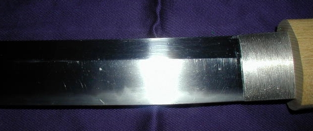

Lindus Posted September 15, 2010 Report Posted September 15, 2010 Hi Folks I have a superb {I think} Gendaito by Sadaroku, can find little on the man but from my point of view it seems excellent although dated 1944. Was going to sell but think I will withdraw this as in four decades have not seen better....your thoughts on the man would be appreciated. Mounted in Gunto mounts with Mon'. Thanks Roy Quote
cabowen Posted September 15, 2010 Report Posted September 15, 2010 He was a student of Amada Sadayoshi, father of the Ningen Kokuho Amada Akitsugu. Was a rikigun jumei tosho. Middle of the road smith....Mei is nicely cut; possibly a special order blade as I see no star stamp and there appears to be a kokuin, not seen on his usual work. Polish looks buffed and/or acid treated.... Quote
Lindus Posted September 15, 2010 Author Report Posted September 15, 2010 Thank you Chris, as is, as far as the polish is concerned,"Middle of the road", why not show examples of the top of the road....would be interesting I think. For many of us the difference may by major or subtle, Hamon wise...Kokioun...Kakahan?. this is inlaid with what appears to be gold leaf. The sword came from Burma, and is untouched. Roy Quote

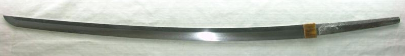

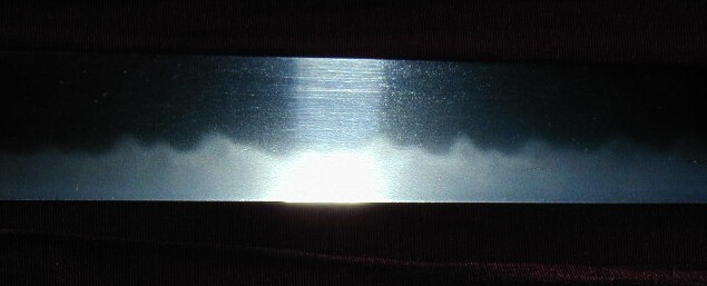

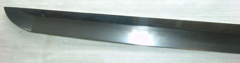

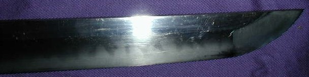

cabowen Posted September 15, 2010 Report Posted September 15, 2010 Kakihan is usually carved, koku'in is stamped.... Polish maybe has that look due to the lighting/photo technique???? Notice the dense, uniform hada, the thick nie lining the habuchi in these "top of the road" examples...(pardon the poor photos). A blade by Kato Sukekuni : Here is another by Kasama Shigetsugu (his work, not student work): And another by Kato Masayoshi: Quote

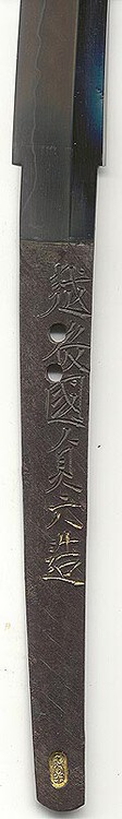

cabowen Posted September 16, 2010 Report Posted September 16, 2010 If you could post a closeup of the kokuin, perhaps I could tell you more.... Also, to clarify my earlier comments regarding jigane and hamon, I should add that extremely tight (締まる) nioi guchi are, in general, not considered "top of the road". Quote
Lindus Posted September 18, 2010 Author Report Posted September 18, 2010 Hallo Chris Best I can do on the flatbed. Roy Quote
cabowen Posted September 18, 2010 Report Posted September 18, 2010 Lindus said: Hallo Chris Best I can do on the flatbed. Roy It says Sadaroku....nothing new there... As I said, it was probably made as a special order as this kokuin is unusual in his work.... Thanks for taking the time to post this... Quote
