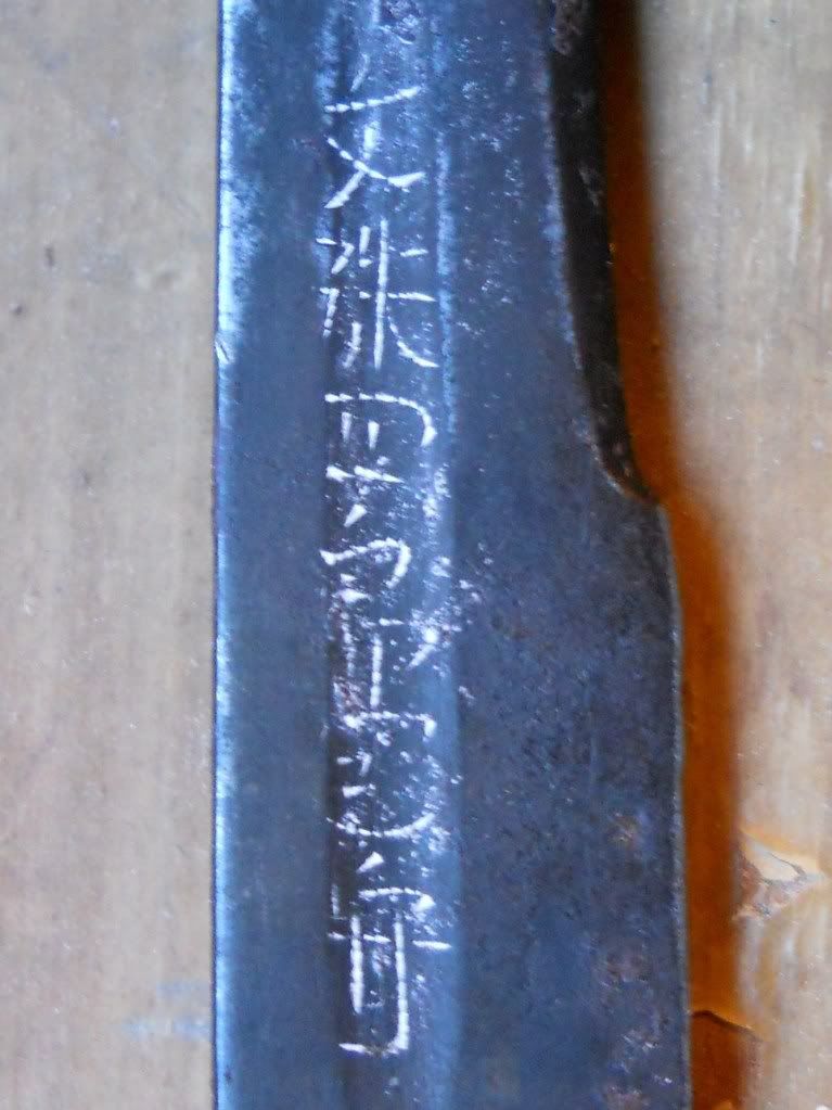

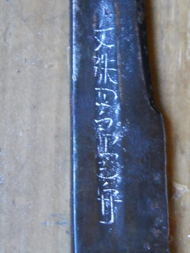

I aquired this kozuka with a koshirae that was badlymucked. Under the muck and old varnish I found a gold foiled, shakudo kozuka with a gold mythical creature menuki on it. gold and shakudo fuchi, and shakudo with inlay mythical creature menuki. unfortunately the menuki were laquered, and can think of no way to remove this varnish without removing the gold and patina. On the kozuka, the blade has a type of hi, and it is signed in the hi. The blade is very well made, and I am curious what this signature is. Thank you for your time.

The mei is " Monju Shiro Kanemori ",文殊四郎包守.
I see the similarities. very nice thank you. How come they never look the way the characters are typed? I would have never gotten that many characters, maybe just 3 of them.
包守Kanemori

文珠四郎藤原包守
monju shiro fujiwara kanemori
These are only 3 I have found that signed this way. both hawleys rated. both are very early, meaning this would be 700+ years old. I wonder which it is?
the 3rd and 4th kanji in the mei are the hardest for me to see the resemblance
Kanemori

Hi Jason,
You see many Kogatana with fanciful signatures! It seems that 80% of them are signed by some no-kami from the shinto period. I feel there is no telling how many true signatures there are on these.
They were made for cutting your apple. I doubt that many of them were signed in period. I would think most of the signatures were done in late Edo, to sell them as something special to people that didn't know any better.
