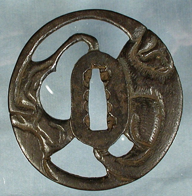

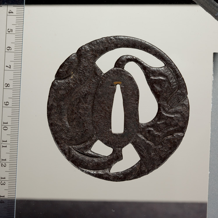

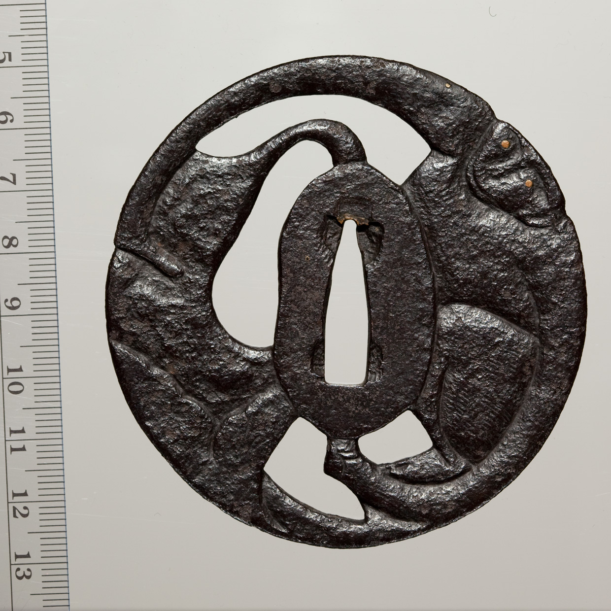

rkg Posted September 1, 2010 Report Posted September 1, 2010 Hey guys, Here are some pics of a couple of ko-shoami tsuba - one I recently acquired, and the other is owned by another board member who was kind enough to let me post the image. They seem to be pretty similar in design, and I'm wondering - Was this "monkey and the moon" theme very popular, or did these come from the same maker's shop, or..? http://www.rkgphotos.com/recent_stuff/k ... front2.jpg http://www.rkgphotos.com/recent_stuff/k ... ey_bak.jpg and the other: http://www.rkgphotos.com/recent_stuff/ko_shoami/630.jpg Comments appreciated. Best, rkg (Richard George) Quote
Steve Waszak Posted September 1, 2010 Report Posted September 1, 2010 Hi Rich, To my eye, yours is older and quite differently executed with regard to finish than the other. I would suppose the other is a "copy" of yours, meaning that it is a rather later rendering of the same design. Judging from photos here only, of course, but yours appears to be richer, with a deeper patina, and more carefully modeled sculpting of the details. In-hand may tell a different story, but that's what the photos suggest to me, anyway... ) I don't see these coming from the same workshop, as the metal and metal work appear too different... Cheers, Steve Quote

tenkaichi Posted September 2, 2010 Report Posted September 2, 2010 These tsuba are same shop, same period. Heianjo Nagayoshi group, like most with this subject. A Japanese folk-tale is the source, and was often used during the Momoyama period. These are perhaps perfect examples of what a difference state-of-presentation may make in assessing tsuba. Quote

Ford Hallam Posted September 4, 2010 Report Posted September 4, 2010 Bruce, I'd respectfully have to disagree with your assessment of these 2 tsuba being from the same studio and time. That the difference in appearance is merely due to the vagaries of time seems utterly unconvincing to me. The granular texture on the first example is, in my opinion, not a result of corrosion at all. This is a deliberate finish achieved by various processes of heating and texturing with fine punches. It also reflects the nature of the actual steel in that it is apparently quite un-homogeneous. The second example has not been subjected to this sort of treatment and the the surface appears consequently much more "hard". The steel quality seems to me to be quite different, far more characterless in fact. This leads me to think the plate is of much later manufacture, mid Edo period perhaps, when tsuba shi could procure suitable plate form specialist steel makers .The carving is less sensitive too, some of the gouge marks being rather ugly....I imagine in an (unsuccessful) attempt to emulate the sort of "naive" and un-contrived quality the first tsuba conveys. The theme of the monkey reaching for the moon's reflection was popular with warriors, I imagine, because it was used by Zen teachers to illustrate various teachings. In this instance the futility of grasping for an illusion. As the early teachers of Zen ( Chan, in China) Buddhism came from China they brought with them Chinese stories and tales to illustrate their teachings. Zen, of course was enthusiastically adopted by the warrior class in the Kamakura period. Enkô ga tsuki wo toran to suru ga gotoshi. Like monkeys trying to snatch the moon's reflection on water. "The Zen symbol for a wantonly foolish person was a monkey reaching down for the reflection of the moon in the water. If he succeeds, he shatters the beauty for which he stupidly yearned. Such is the penalty for grasping at illusion as if it were reality. " This poem by Hakuin perfectly illustrates the idea. Hakuin was one of the later, Japanese born teachers living from 1685 to 1768/9 The monkey is reaching For the moon in the water. Until death overtakes him He'll never give up. If he'd let go the branch and Disappear in the deep pool, The whole world would shine With dazzling pureness. This is a screen painting that illustrates the story Henry alluded to. Perhaps we're the monkeys...all vainly grasping for some sort of tangible knowledge of this vast subject regards, ford 1 Quote

Mike Posted September 4, 2010 Report Posted September 4, 2010 Differences in the shape of the nakago ana and the different tagane marks also indicates different makers. Mike Quote

rkg Posted September 6, 2010 Author Report Posted September 6, 2010 Thanks to all who replied. First, I knew the origins of the theme - I kind of bought it as a reminder of its meaning, actually. I hadn't realized how popular the theme was at the time, which probably explains their similarities better than them having to have been done in the same shop or something. Outside of the kyo guys, I can't ever seem to remember which schools did which tagane "adjustments" in the nakago ana area.. Second, the "Heianjo" seems like an interesting kantei for it (I hadn't thought about it, but they did pieces like this), though the iron confuses me - perhaps I haven't seen enough pieces from this school, but when I think of this school either that really doughy, easily rusted iron or that highly refined iron kind of like you see in kyo pieces comes to mind - this doesn't seem like either of these, plus the patina seems pretty black compared to the Heianjo pieces I've held... maybe they got ahold of some other iron or something? Third, I hadn't thought about it, but maybe Ford's right about the deliberate "corrosion" - it seems like some of the features would have been completely eroded away (fine details on monkey's face, the zogan eyes, etc.) if it was "natural". The question of art "restoration" seems to be a minefield - I had recently acquired and started to read "Art Restoration: The Culture, the Business, the Scandal" but managed to lose it on a flight somewhere (story about trying to navigate airline lost and found deleted), and kind of figured it was an omen.... Thanks again all. Best, rkg (Richard George) Quote
