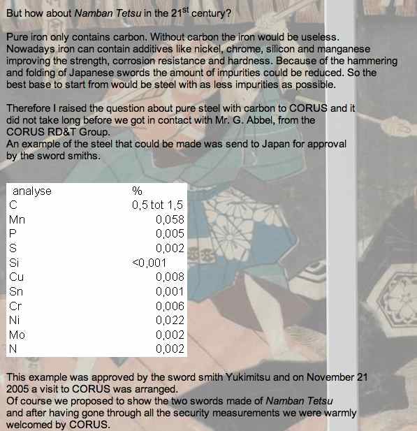

Eric H Posted September 4, 2010 Report Posted September 4, 2010 Coming back to the NAMBAN TETSU PROJECT the „new“ Namban-tetsu had to be evaluated for the test...I don‘t know how close this „new“ Namban-tetsu comes to the „old“ Namban-tetsu, however the test was performed with two small blocks. „Namban-tetsu was a highly sought after and expensive commodity...“ I have read in the previous article...and I believe those swordsmiths knew very well to judge the „qualities“ of the foreign steel. Eric Quote
