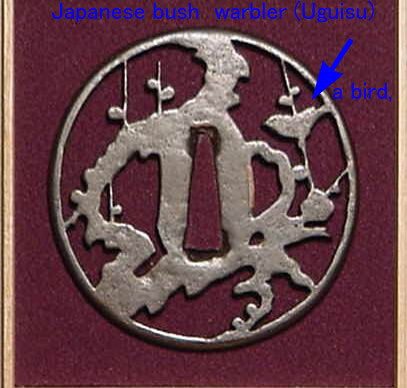

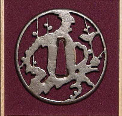

Here are two quick pictures. I would have thought it was earlier than 4th master but I'm still learning. Thanks for looking.
Interesting design as the tree branch nearly 330 degrees the tsuba. Usually it is 270 degrees at most.
If you are willing, please share measurements... especially thickness to as precise as possible.
Don't knock the 4th and 5th gen guys, as the school bifuricated. You have heavy hitter Tadashige and a few others in there.
Size: 76.35 x 75.92 mm by 5.5-6 mm thick. Thickness varies slightly through the entire plate.
Yes I did notice the bird and flower in the tree branch. I'm not knocking 4th or 5th generation. I like all smiths from the school. I'm just trying to understand how to tell at what point in the school it was made.
