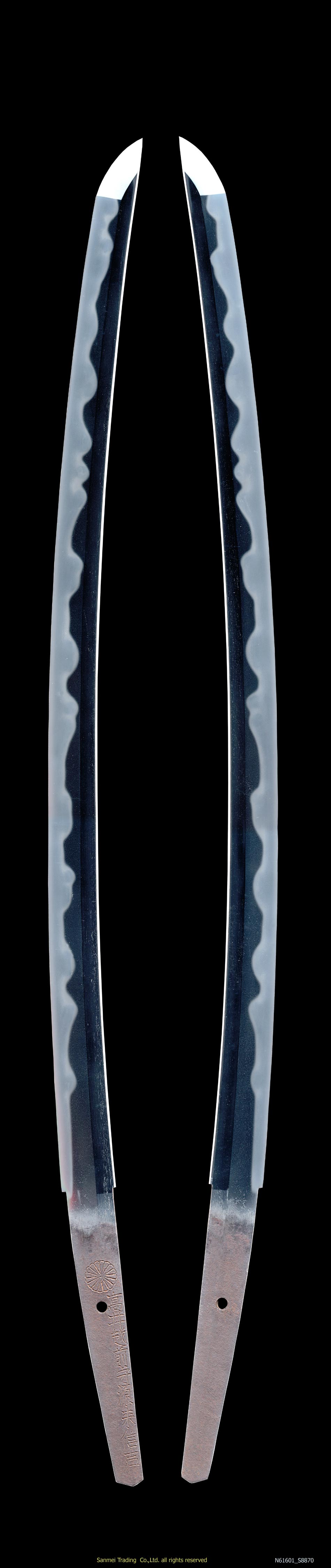

miner1436 Posted August 26, 2010 Report Posted August 26, 2010 Reminds me of this http://www.sanmei.com/Pictures/Sword/N6 ... 0_PUP1.jpg rich r. Quote
cabowen Posted August 26, 2010 Report Posted August 26, 2010 Hachiman said: Thank you for the replies. I have added a few more photos to the album, hopefully showing the blade a bit more clearly. Photographing the hamon is not an easy thing obviously! I forgot to add that the blade is 25 inches almost exactly from tip to tip, and from the tip to the front edge of the habaki(?) 19 1/2 inches measured parallel to the blade. I'm glad to hear it is earlier than I thought. In my ignorance I had assumed that the chrysanthemum stamp meant it was Showa era military production. I have heard from a Japanese native speaker that the signature reads "Echizen-no-kami Minamoto-no Nobuyoshi". Could this be an alternate reading? Thanks again! yes, it is Minamoto...Wrote Fujiwara out of force of habit.....Edited above to correct that....Sorry about that... Quote
cabowen Posted August 26, 2010 Report Posted August 26, 2010 miner1436 said: Reminds me of thishttp://www.sanmei.com/Pictures/Sword/N6 ... 0_PUP1.jpg rich r. I think you will find, among other things, the kiku is a bit different..... Quote
Hachiman Posted August 27, 2010 Author Report Posted August 27, 2010 Thanks again. Is this one closer? http://www.samurai-nippon.net/44/ I see there is some mention of this smith elsewhere on this board. I now see of course that the chrysanthemum that I assumed at a glance to be a stamp is actually hand cut. Interesting how the "modern " design predisposed me to assume that! There's a little lessson. I've wiped the blade down with isopropynol and will warm it up with a heat gun to drive out any residual moisture before putting some light oil on. I've got some electric shaver oil that should do the trick(?) Should the tang be oiled or not? Oh, and I'm curious in what sense the nakago is "in rough shape" and the "signature is iffy"? I don't know what to look for which is why I ask, thanks. Robert. Quote
cabowen Posted August 27, 2010 Report Posted August 27, 2010 Hachiman said: Thanks again. Is this one closer? http://www.samurai-nippon.net/44/ yes, like yours, this kiku has the star at its center.... Hachiman said: I see there is some mention of this smith elsewhere on this board. I now see of course that the chrysanthemum that I assumed at a glance to be a stamp is actually hand cut. Interesting how the "modern " design predisposed me to assume that! There's a little lessson. I've wiped the blade down with isopropynol and will warm it up with a heat gun to drive out any residual moisture before putting some light oil on. I've got some electric shaver oil that should do the trick(?) Should the tang be oiled or not? Oh, and I'm curious in what sense the nakago is "in rough shape" and the "signature is iffy"? I don't know what to look for which is why I ask, thanks. That all sounds ok. You might want to invest in some appropriate oil. A light coat of oil on the nakago in this case (normally the nakago is protected by a nice even patina but this looks to be rough and perhaps cleaned at one point) probably wouldn't hurt. This is a fairly well known smith and there are plenty of fakes out there. It is always hard to make any judgments with any certainty from photo over the net. Compare yours to the example you found above. Note the placement, shaps, and spacing of the kanji, as well as the stroke direction, etc., of the kanji themselves... Quote
