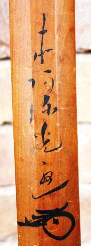

smac401 Posted August 20, 2010 Report Posted August 20, 2010 Evening all, I am posting my family given sword for any knowledge on it. It is unsigned other than the many inscriptions on the Shira Saya, it has a gold foil 2 piece habaki with hi extending from the end of the nakago past the mitsukado. The blade is in old polish and had a bright hamon, mumei, a deep sori and 3 holes in the nakago and the length is 28". I am working to get the inscriptions translated but have been told that is to old for some of the translators I have spoken to. What I have learned about it is listed above and from a close friend that has way more knowledge than myself. If anyone can help I would greatly appreciate it. I was going to take it to shinsa but the time came on me to soon to plan it. I still will take it when I can but in the mean time any help would be great. I posted the photos in the links below. Thanks in advance. Steve Quote
cabowen Posted August 20, 2010 Report Posted August 20, 2010 At a glance, I believe the saya gaki gives an owner's name and address, the length of the blade, an attribution to Soshu Yukimitsu, and a Showa date for the saya gaki with the name of the person attributing the blade (Honami Koson). I am sure someone else will fill in the blanks. The habaki is very nice and was expensive. The jihada looks very good as well...Would be interesting to see what a modern shinsa would conclude... Quote
nagamaki - Franco Posted August 20, 2010 Report Posted August 20, 2010 cabowen said: I am sure someone else will fill in the blanks. Soshu Yukimitsu is a "big name" in the world of nihonto, and unsigned (as well as signed) big name swords are generally accompanied by a great deal of skepticism for good reason as very few genuine pieces are ever found. Meaning that the jury will probably be out on exactly what this sword is until it is authenticated by a shinsa. Here's a link to a Soshu Yukimitsu which has been verified http://www.nihonto.ca/yukimitsu-2/ Beyond that, I'm having personal doubts *** as an amateur/student at the moment that the sayagaki was actually written by Honami Koson. From the Yukimitsu linked above Quote In addition to the above, this sword comes down through time with a variety of old paperwork, including an origami from Honami Koson who was one of the great scholars of the 20th century. . Again, it will take a shinsa to accurately sort the whole thing out. (edit) *** Well, maybe not so fast ....... Regardless, looks like a good sword, it's just a question of which swordsmith made it. The pattern on the habaki appears to be koke (moss). Quote
Eric H Posted August 20, 2010 Report Posted August 20, 2010 nagamaki said: Beyond that, I'm having personal doubts *** as an amateur/student at the moment that the sayagaki was actually written by Honami Koson. From the Yukimitsu linked above The second Sayagaki is dated 1940 Eric Quote

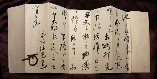

Eric H Posted August 20, 2010 Report Posted August 20, 2010 cabowen said: The blade should be well cared for and put through a shinsa as it may well be something quite valuable. There will be a US shinsa next year. at any rate :D additional Sayagaki and shumei. Eric Quote

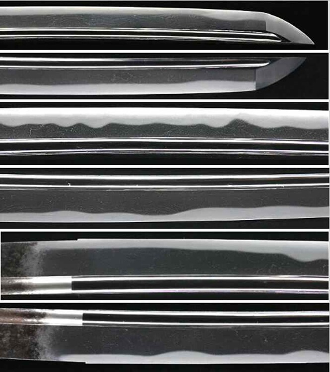

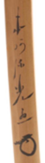

Eric H Posted September 13, 2010 Report Posted September 13, 2010 Hereby 3 examples of Soshu Yukihiro‘s hada: The steel is very fine and beautiful with an abundance of ji-nie and chikei. The grain is ko-itame mixed with mokume, which in places becomes o-hada. and additionally part of a sayagaki by Honami Koson considered not reliable. Eric Quote

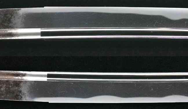

Eric H Posted September 17, 2010 Report Posted September 17, 2010 These are pictures of a Soshu Yukimitsu Tokubetsu Juyo Token and I advise to enlarge them if possible. Eric Quote
Jacques Posted September 17, 2010 Report Posted September 17, 2010 Hi, from the 100 materpieces from the collection of the Doctor Compton. Quote
