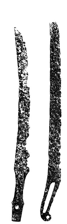

Carlo Giuseppe Tacchini Posted August 26, 2010 Report Posted August 26, 2010 Just for sake of sharing and with reserve of further study (attributions are always to be taken with a pinch of salt) : The right one is the WarabiteTo Aterui (阿弖流為 A.K.A. Akuro-o 悪路王) reportedly used. Courtesy of Professor Ito. Quote
