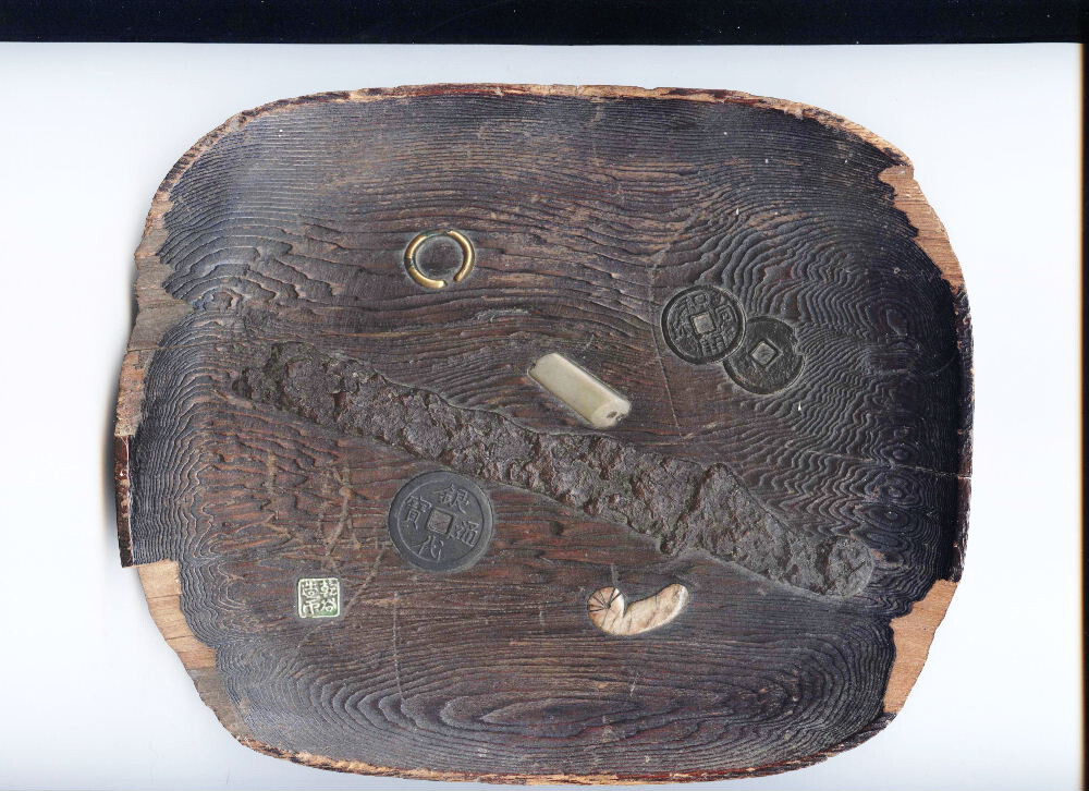

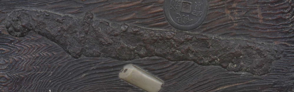

sanjuro Posted August 8, 2010 Report Posted August 8, 2010 Interesting 'treasure you have there...... The short sword is a Warabite To. Quote
Lindus Posted August 8, 2010 Author Report Posted August 8, 2010 You knew I would ask this......... but what is a "warabite To".....I know I shall regrette asking this but it has been a great day so what the hell...... Quote

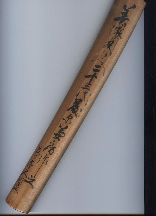

cabowen Posted August 8, 2010 Report Posted August 8, 2010 sayagaki says: Both large kanji say: Mino Seki ju Nin Niju San Dai Fujiwara Kanefusa Saku Made by the 23rd generation Fujiwara Kanefusa of Seki in Mino small kanji give the length...Maybe one of the Japanese members will be able to read this as it is mostly illegible to me.... Quote
machinist Posted August 8, 2010 Report Posted August 8, 2010 The short sword is a Warabite To. Would that be something like this? (later day copy) http://www.samurai-nippon.net/26/ Quote
Carlo Giuseppe Tacchini Posted August 8, 2010 Report Posted August 8, 2010 what is a "warabite To.... Ancestral type of swords from Northeastern Japan. Here you'll find an article with info on them : http://www.webalice.it/tsubame1/ (first link, scroll down to the last quarter). Interesting the two upper coins. *IF* they are what it's said they are, they were possibly found together with the Warabite-To. Hardly from Osaka IMHO, date possibly accurate (late VII c./early VIII c.). I'd be grateful if you could share some pics of all protostoric items with me at tsubame1@tin.it . Quote

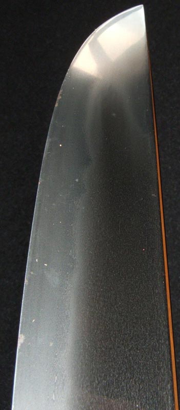

Lindus Posted August 8, 2010 Author Report Posted August 8, 2010 The short sword is a Warabite To. Would that be something like this? (later day copy) http://www.samurai-nippon.net/26/ Not dissimilar Hamon..seeattached. Quote
Baka Gaijin Posted August 8, 2010 Report Posted August 8, 2010 Hi Roy, Warabite 蕨手 Literally a bracken frond uncurling, see the shape of the tsuka area. Cheers Malcolm Quote

Toryu2020 Posted August 9, 2010 Report Posted August 9, 2010 Kanefusa sayagaki number one appears to say; 長サ壹尺有之 or Nagasa: Isshaku kore ari If I may say this is an exceptionally well written sayagaki, I should be interested to see any information on the reverse of these. The length as given on number two eludes me as well... -t Quote
Nobody Posted August 9, 2010 Report Posted August 9, 2010 The length description in the 2nd sayagaki may be 長サ弐尺弐寸五分有之 – Length; 2-shaku 2-sun 5-bu. However, I am not 100 % sure. Quote
Lindus Posted August 9, 2010 Author Report Posted August 9, 2010 Kanefusa sayagaki number one appears to say; 長サ壹尺有之 or Nagasa: Isshaku kore ari If I may say this is an exceptionally well written sayagaki, I should be interested to see any information on the reverse of these. The length as given on number two eludes me as well... -t The reverse on both are clear,agree and add that it is a shame we shall never know who applied the sayagaki. Regards Roy Quote
Lindus Posted August 9, 2010 Author Report Posted August 9, 2010 The length description in the 2nd sayagaki may be長サ弐尺弐寸五分有之 – Length; 2-shaku 2-sun 5-bu. However, I am not 100 % sure. Once again many thanks, it does seem appropriate. Roy Quote
