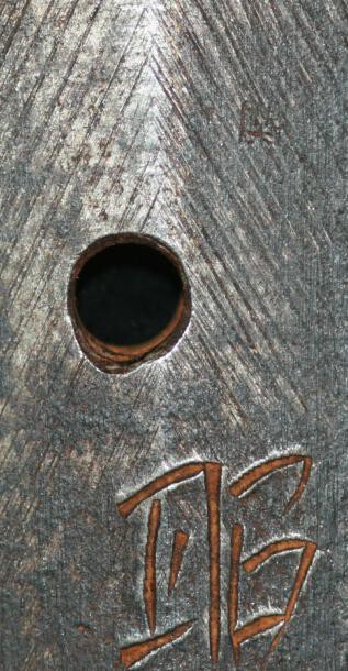

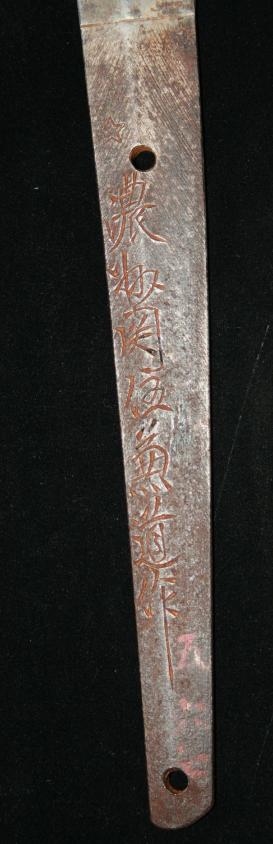

I think it is signed Kanemichi. Here is a page from Sloughs reference noting he was a Rikugun Jumei Tosho. As with many Seki blades, they were not always signed by the smith so that may explain stylistic differences in the mei.
Klaus,
In case you weren't aware - if you bought this as a Kanenao piece (and paid a Kanenao price) then you just outdid yourself. Well done and if you do have photos of the blade that would be wonderful.
Many thanks for your comments.
I found it on eBay and the auction is still running http://cgi.ebay.com/ws/eBayISAPI.dll?Vi ... 3D1&_rdc=1 (sorry in this case this is the wrong section) :dunno: and I am not sure if it is a bargain because the blade is in very very bad condition!! For my it seems it has at least one Hagire :? but I will ask the seller 8)
Anyway, above the date I found small stamp - any idea what it could be ??
Very interesting and hopefully Chris will weigh in on this. The stamp appears to be a mis-struck Seki stamp. What makes it interesting is the conflicting stamps. The Star stamp indicates that it would be a gendai blade and the seki stamp would indicate that it is a showato blade. Also as far as the mei is concerned this is a shoshin mei and not kazuuchi (sp), so it was applied by Kanemichi himself (IMHO).
Chris or others do you have any insight in the double/conflicting stamps?

In this case, with the star there, I would say the small seki stamp is simply something that notes the origin, like the na stamp, etc. I would bet it is a traditionally made blade though without seeing it that is simply a hunch....
I agree that this tiny Seki stamp is not a sign of showato...as Chris says, it is the equivalent of the "na", "saka" stamp etc. and will be on "arsenal forge" made gendaito.
This also does not confuse the previous discussion we had where we stated that generally, no gendai tosho wasted his time making showato marked with "Sho" and Seki" stamps. This Kojima Kanemichi obviously did make "Seki gunto", but was also one of the few from Seki, chosen for the RJT scheme gendaito production. I suppose there will be a handful of RJT smiths who will have "Sho" and "Seki" stamped swords bearing his mei (usually nakirishi mei)....but these will be very few.
