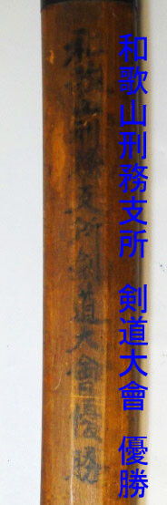

Someone has contacted me and asked for help with a sayagaki. I'm not having much luck; can one of you please help?
I don't know if the sword is for sale, certainly not by me.
Thanks, Grey
I can't make out the top half clearly but the bottom reads:
...支所剣道大会優勝
... shisho kendo taikai yusho
So this sword was a prize for winning a X branch kendo tournament ....
和歌山刑務支所剣道大會優勝 (Wakayama Keimu-shisho Kendo-taikai Yusho) – Wakayama branch prison, the Victory in Kendo competition
However, I might be wrong about the first 4 or 5 characters.
If the reading is correct, it must be written between 1924 and 1946.
edit: Ah, Morita san was faster than me…
