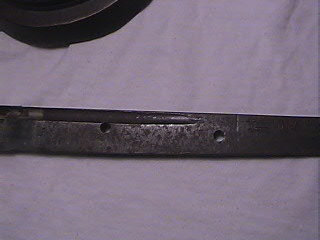

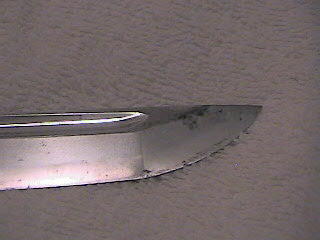

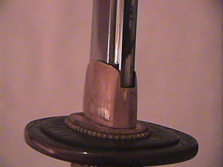

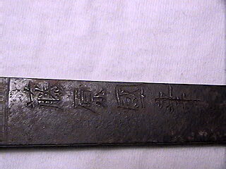

I have a Kai-Gunto that I've been told is signed by Fujiwara Kuniyuki (I've been told everything from it will be difficult to identify since there is no province name or date, that it is not a big name Kuniyuki, and that it is from 1596 up to shinshinto). This sword belonged to my great-grandfather who obtained it in hand-to-hand on Munda Island during WWII. It hung on his wall for over 40 yrs. I have attached some photos (sorry for the quality) and you will see there is also a kamon (two crossed falcon feathers).
This is for personal information, as I will be attending the Antique Roadshow to have this and a Shin-Gunto signed by Kondo Akikuni appraised (I posted a couple photos of it on the military discussion board here). I'm looking for any additional information that anyone may be willing to provide. Thanks - CS
After looking at the posted photos, just wanted everyone to know there are no chips. It's laying on a quilt and appears chipped. Thanks again!

You were told correct about the signature, I believe, and also about the difficulty in determining which Kuniyuki it is. More pictures of the blade and one that shows the whole nakaga (tang) with the signature will help. What I can see of the nakago indicates Shinshin-to at the earliest.
Best of luck with the Roadshow but don't take their appraisal to the bank. Every appraisal of a Japanese sword they've ever shown on air has been goofy.

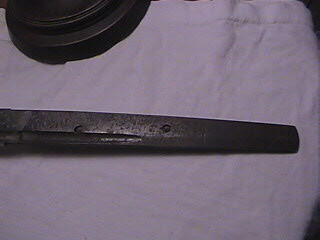

Here are some more photos. I added the last one of my great-grandfather which was in the local paper (wanted to know what people were bringing to the roadshow). Enjoy.

When I said no earlier than Shinshin-to I was going by the sharp file line on the nakago above the mei. Seeing that there is a lot more nakago than what I saw 1st, let me change my mind. The blade has been shortened and could be older.
Your pictures are too small to see much detail. Any chance we can see larger ones?

It does look like a nice sword. You can tell there was a bit of care in the details. Nice bohi and well cut. I am unable to narrow down the date, but not wartime imho. It is worth some investigating.

Just from the pics, I would go with Shin shinto as well. The holes are in the wrong position for a shortened sword. I have seen a few swords like this, usually though, they are mumei. They were made to look like shortened Koto blades.
