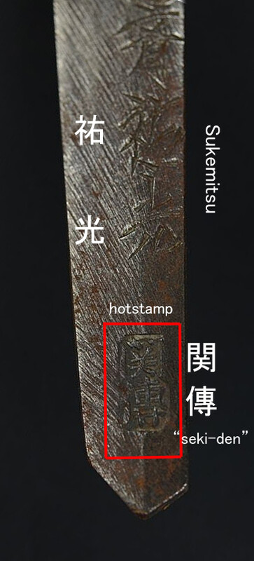

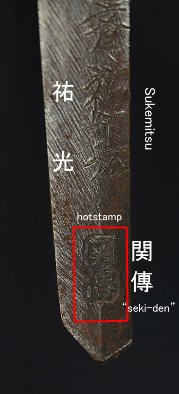

Hello,
This sword tang is Fukuda(family name) Sukemitsu(祐 光)sword in Seki, WWII period.
There is an unusual hot stamp on it.
The hot stamp says "Seki-den"(関 傳),this stamp means Seki tradition or Seki school.
*Pic from Yahoo auction site in Japan.
