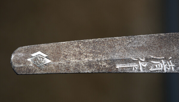

cabowen Posted November 16, 2012 Report Posted November 16, 2012 Lindus said: Attached is one I never did find out about,Unsigned Katana with full length HI and fine hanyaki hamon. Mounted in Kyu Gunto army mounts and with two Mon. Someone recently pointed this out to me... Stamp is indeed double struck. It is the smith's name: Naohiro. Remember, Japanese is read right to left traditionally. 直弘 Family name is Yanagawa. From Saitama. 大慶直胤--直弘[初代](土野留助)--直弘[二代](柳川才次郎)--直弘[三代](柳川昌喜)-- 直弘[四代](松原英一)(埼玉県大宮在住) This is most likely the work of the second generation. During the Meiji and Taisho periods, he worked at the army arsenal in Tokyo making blades for sabres and other western style swords. He also made razors and the like. I have seen this stamp before on a razor as I recall.... Quote
george trotter Posted November 16, 2012 Report Posted November 16, 2012 That is good information Chris (edit to add...your info rang a bell... I looked up my notes and I once had in hand a sword signed "Toto ju Ushoshin" (see Rich Stein's oshi list) which is Yanagawa Ushoshin, a Betseki smith according to 'Mezurashii Senzen no Gendai Tosho Banzuke 1943. As this was a swordsmith workshop who made Shoshin-to I suppose the Ushoshin may be a "brand" rather than a mei, but these were the brothers Yanagawa as you say Chris (see also 'Dainihon Token Shoko Meikan 1942 p.72). A better example of this Naohiro mei stamp is attached here.....on a Meiji/Taisho era kyugunto with bo-hi. Apart from this Naohiro, the WWII tosho Iijima Masayuki of Yamanashi and Tokyo is the only other smith that I know of who used a stamp for his mei. Regards, Quote

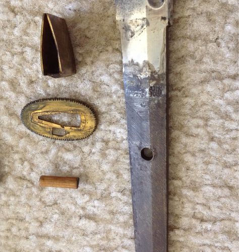

CurtisR Posted February 4, 2013 Report Posted February 4, 2013 Thought I'd add to the collection....Seki smith. Curtis Quote
george trotter Posted February 4, 2013 Report Posted February 4, 2013 Thanks for posting Curtis. Morita san says the stamp is "kiyo"...in sosho script. It is probably his private kao? (from his name). I see the blade has a sho stamp so not gendaito. Regards Quote
Dr Fox Posted February 10, 2013 Report Posted February 10, 2013 Hi Curtis and George Could you expand on this signature, and especially the stamp? Why? Because yesterday on a visit to a close friend, he showed me an identical sword with the nakago stamped thus. He had a curiosity, but no idea what is was. Thanks Denis. Quote
george trotter Posted February 11, 2013 Report Posted February 11, 2013 Hi Denis, if you look at the stamp it is the Kanji "Kiyo" (same as the second kanji in his name Kanekiyo)....but written in sosho style. I think this stamp is just his personal mark. Regards, Quote
Dr Fox Posted February 11, 2013 Report Posted February 11, 2013 Hi Again George and thanks. Where I was stuck and could not relate to the, stamp was that I did not have a translation of the mei. I now have Kanekiyo, this should be a little test for me. A Showa smith, non traditional blade, 1940ish. I should have a go at this one. Denis. Quote
