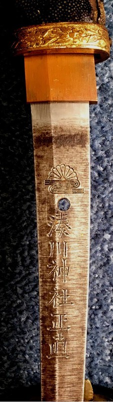

Wow, John, quite unique!  I'm posting it with the other kiku in the Stamps doc, though it's fairly likely not tied to shogunate work.  Makes me wonder after looking at them all if the kiku with stems and leaves were shogunate work or not as well.  That would mean going back to look a the smiths involved and possible dates.  Maybe someday.
John and Bruce, interesting blade and hamon.  I wonder if this stamp could be related to the Minatogawa Jinja Forge in Kobe, although this is katana-mei.   Example by Masanao in tachi-mei.  But artistically stamp could be sunset over a mountain??  Also different number of petals/rays.
Anything is possible with this one.  I personally think it's handmade, and something put there for whatever value or good luck the kikusi brings to the blade/soldier.
You can see two horizontal lines under Fuji, like you might see under a kiku, and I have other examples with less than the normal number of petals:
image.jpg.63783aee46d32f7739028638b0baf4ba.jpgfuchimon1.thumb.jpg.b1b546daf34fe07603cc16153758777b.jpg

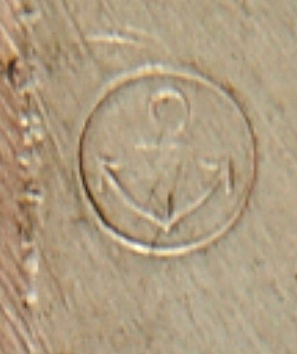

Update on the Navy anchor stamp we have all been attributing to the Toyokawa Naval Arsenal.
SmartSelect_20190926-211741_Gallery.thumb.jpg.0499de77dff9d3fe1e0d43a0359e4e11.jpgSmartSelect_20190929-181732_Gallery.jpg.2996968f312e88fa547d6a1dc62c4e6f.jpgSmartSelect_20190930-155708_Chrome.jpg.b23df51e53763efd0436de8ebb31251a.jpg
We no longer believe that to be the case, and think it is a generic Navy Inspection stamp, not specific to any arsenal.
Thomas - @Kiipu - has been making this point for a few years, but it never caught my attention (chasing too many other rabbits at the time).  So, he got Mal - @mecox - to listen and stir the pot.

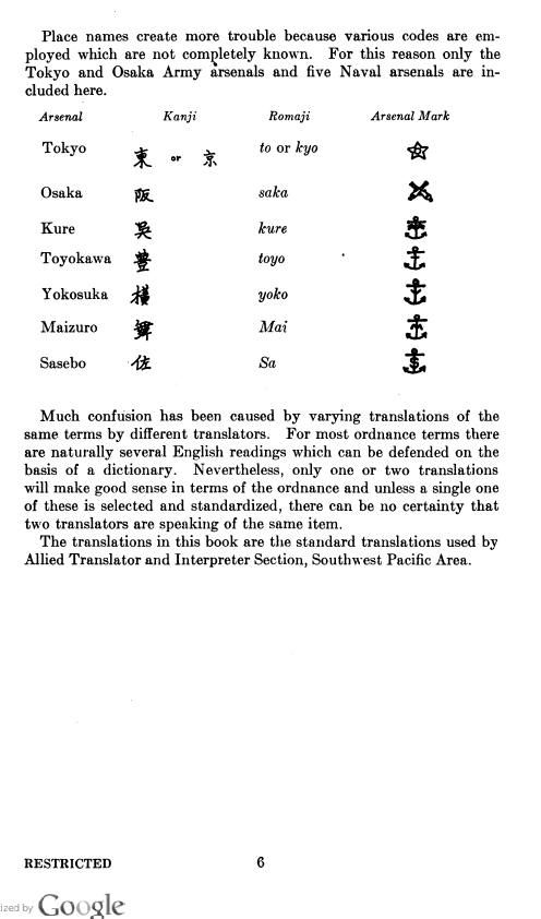

For decades, we have called it the Toyokawa Naval Arsenal stamp because of Ohmura's page and Richard Fuller showed it as such in his books.  The chart on page 228 of his '96 edition came from someone or something before his work, and he now agrees with Thomas and Mal.
-- The stamp, on swords, only appears on blades made by the Tenshozan factory.  They are stainless steel blades made by Tenshozan (some stainless blades were made in Seki, but likely processed by Tenshozan).  Two blades made at the Takayama forge have been found with the stamp.
-- The circled anchor is also seen on things not associated with Toyokawa, like aircraft and electronics labels.
-- No documented evidence could be found showing that Toyokawa was in any way associated with sword manufacturing, or processing, while it has been found for other arsenals like Sasebo, Maizuru, and Yokosuka.
Mal is revising his Navy Swords articles, and the Stamps of the Japanese Sword document will carry this revision when it comes out next March.
For the record, these are the stamps of the various arsenals.  They were hand drawn by the original author and slightly inaccurate, but nothing that significantly impacts our point.  The circled anchor is not on the list.

Ohmura, and the chart Fuller used, lists this as a Toyokawa stamp, but there is just no evidence that support that claim.

If sword blades with the anchor-in-circle stamp were made or processed at Tenshozan, is there any significance to the different anchor stamp that we already associated with Tenshozan?
It is Mal's theory that both stamps - circled anchor and anchor with chevrons - were used at Tenshozan by the resident naval inspector.  As the blades with circled anchor stamps are undated, it is possible they were earlier than the blades with the chevroned anchor.  He may correct me on that, but I think that is what he said.
It is still possible that Tenshozan had it's own quality inspector using the chevroned anchor simultaneously with the Navy inspector using the circled anchor.
The chevroned anchor is specific to Tenshozan, while the circled anchor can be seen elsewhere.

@RobCarter3   @Bruce Pennington   Rob re the Tenshozan anchor stamps the strong indication is that the general Navy acceptance stamp (anchor-in-circle) was used from early on, throughout the war and into the post-war souvenirs.   The Tenshozan stamp (anchor with chevrons/bars) had some dated blades which show it was used for a short time only 1938 to 1943 and on blades with "Tenshozan....."  mei.  So looks concurrent with other stamp for a while.
