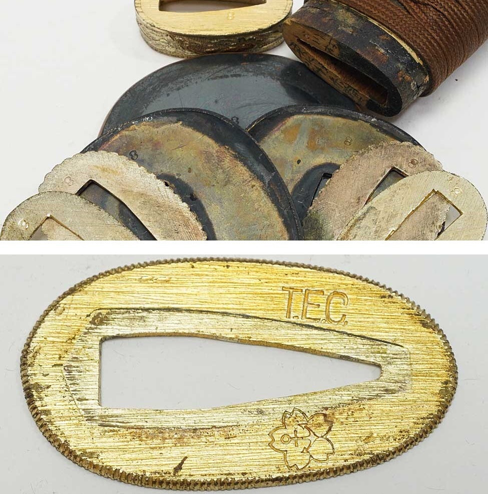

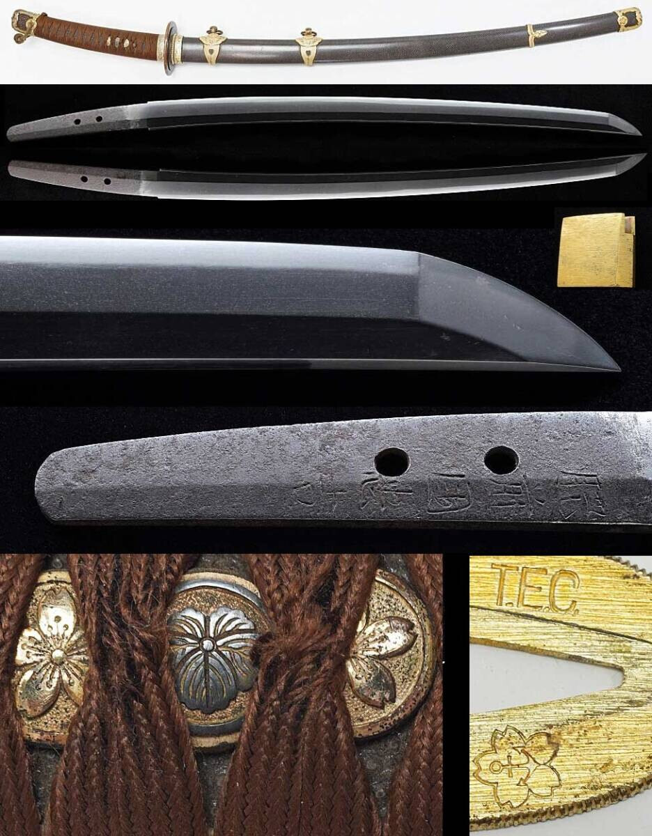

PNSSHOGUN Posted April 8, 2024 Report Posted April 8, 2024 Examples of the "T.E.C." stamp on Kai Gunto, could have some relation to the Toyokawa Naval Arsenal due to their stamp? The quality on Kai Gunto with this stamp is often very good. 1 Quote
Bruce Pennington Posted April 8, 2024 Report Posted April 8, 2024 On 4/8/2024 at 5:04 AM, John C said: For your files - on a Kanenori showato. Expand Thanks John! That's the best one of this shape where the writing is completely legible. Quote
Bruce Pennington Posted April 8, 2024 Report Posted April 8, 2024 On 4/8/2024 at 5:37 AM, PNSSHOGUN said: "T.E.C." stamp on Kai Gunto, Expand Thanks John. I only have 3 examples and as you note, all 3 have the Toyokawa stamp on the seppa as well. I don't know the finer details of shops and forges that worked directly or exclusively for arsenals, but it appears this is so for this one. I know SMR had their own fittings shop, but I don't know if the Army and Navy arsenals made their own fittings, too. Quote

Bruce Pennington Posted June 6, 2024 Report Posted June 6, 2024 I should probably start a dedicated thread for the T.E.C stamped fittings. In answer to @PNSSHOGUN question HERE, I now have two kaigunto with signed blades. One is Hidetoshi, the other is Kaneoto. The Kaneoto is on this JC Militaria site 1 Quote
