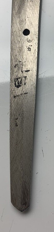

John C Posted March 3, 2024 Report Posted March 3, 2024 @Bruce Pennington Another Toyokawa (??) with the Ka stamp. But is it hand signed? https://www.ebay.com/itm/404825057339?itmmeta=01HR15ZSRKDP5J56180VBR857Q&hash=item5e4174283b:g:924AAOSwGOpj-~0G&itmprp=enc%3AAQAIAAAAwGu%2Bij8VgDtUtnUS8UCvQgi32Igboplh3YvIUeVSEfARZbPU0rjciWZ4CXz7iFsurOa2FeLAIFfI78SDZJusHddpZFHF%2FLIWyfr4BDDyzaT0uwrjOd7KwioJQGt%2F67Z3Ajr3IkASZPlmJxwQtWVTGtCox9wnN9g3pW97Ne6VqrmS9fYD7I1HyoWCwM7dBVRy6%2BNBRspcWyVYSGJTCT6XMSFjgcEhS2R5qwsP8Lt8IphwKW4%2BkZYsVB50jUgf7wp9BQ%3D%3D|tkp%3ABk9SR7Kc_6XAYw John C. 1 1 Quote
Bruce Pennington Posted March 3, 2024 Report Posted March 3, 2024 Wow, John! Good one! Will need to bring in the experts on this: @Kiipu @SteveM @BANGBANGSAN Minor Update: Looks like I have this one on file from Aug '23. Bbdear was selling it back then, but as far as I can tell, we never got this side translated. 1 Quote

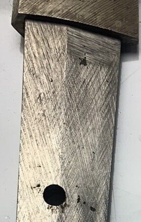

John C Posted March 3, 2024 Report Posted March 3, 2024 @Bruce Pennington Another one: a Hidetoshi with numbered nakago here: https://www.ebay.com...9:g:eewAAOSwoHtl49OT John C. 1 Quote
Bruce Pennington Posted March 4, 2024 Report Posted March 4, 2024 On 3/3/2024 at 8:16 PM, John C said: a Hidetoshi with numbered nakago here: Expand That's an interesting one, John. I have one with a horizontal 8 about that size on a '43 Kanemichi Any chance this is a shop logo/mark, I wonder? @mecox - Any chance there were a Kanemichi and a Hidetoshi working together? Of course, it could be a sword shop that bought blades from all over, assembling their own gunto, and this was their mark. 1 Quote
Bruce Pennington Posted March 4, 2024 Report Posted March 4, 2024 If it's an "8", it's not on the fittings, as shown. We don't see the other side, though. Quote
mecox Posted March 4, 2024 Report Posted March 4, 2024 @Bruce Pennington @John C IDO HIDETOSHI (井戸 秀俊) was a key tosho in the Amahide workshop in Seki and also commonly did daisaku with Amahide and others. various blades have the Amahide kokuin stamp, also a few other stamps e.g. "flaming ball" and a "one-punch". I have not seen an "8" but it looks more like OO ? That was a very productive workshop and there is a range of mei and stamp combinations due to daisaku and combined work. 1 Quote

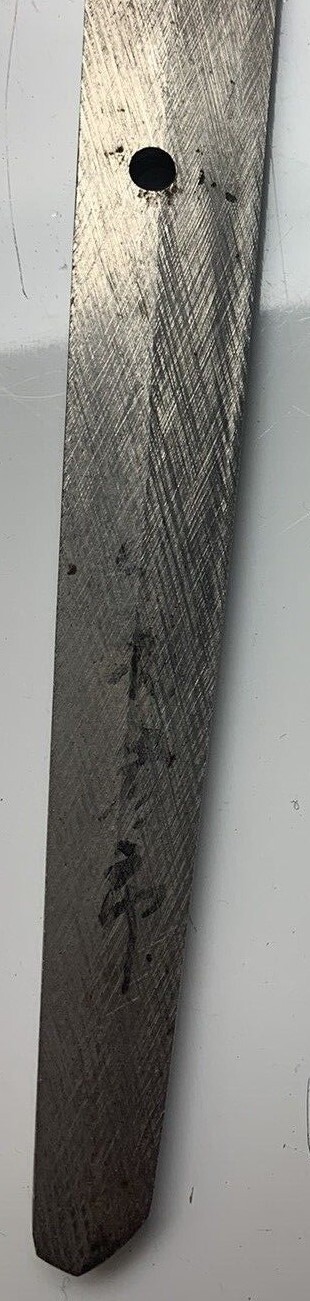

mecox Posted March 4, 2024 Report Posted March 4, 2024 @John C @Bruce Pennington the kaigunto John found Pic 1: stamp in circle of Toyokawa arsenal plus か "ka" katakana. The ink characters are assembly no. same as the fittings 941 九四一. Looks to be typical stainless steel blade. Pic 2: ink writing looks like a name (is it the owner, or the assembler?) Suggestion is: SHIRAKI 白木 HIKOICHI 彦市 (shira is not clear). Pic 3: probably a fault not a stamp. 1 2 Quote
Bruce Pennington Posted March 4, 2024 Report Posted March 4, 2024 On 3/4/2024 at 5:50 AM, mecox said: (is it the owner, or the assembler?) Expand Ah, thanks Mal! That would make more sense. 1 Quote

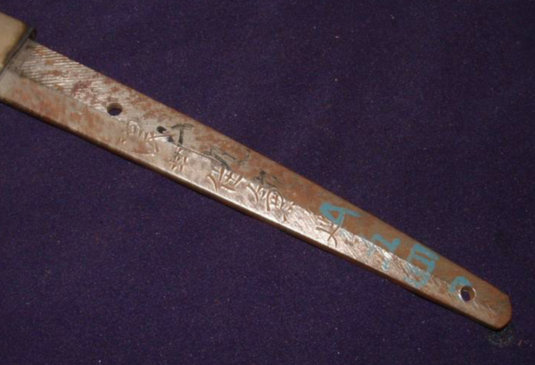

John C Posted March 18, 2024 Report Posted March 18, 2024 On 3/18/2024 at 12:37 AM, Bruce Pennington said: You bet Expand RS fittings, double latch (though may not be original); two mekugiana. Fittings in rough shape and blade rusty. Dated: Showa 19 (1944), June Niwa Shuji Kanenobu (son of Niwa Kanematsu Kanenobu), RJT smith. Signed: Noshu ju Kanenobu Star stamp and small seki stamp (unknown nakago stamp) Painted green numbers A 540 in both kanji and western numerals Black painted numbers 99 in kanji No dots or stamped numbers. John C. 1 Quote
Bruce Pennington Posted March 18, 2024 Report Posted March 18, 2024 On 3/18/2024 at 1:07 AM, John C said: Star stamp and small seki stamp Expand Thanks John, can I get a clear shot of those? Also how about the date side, please? Quote
John C Posted March 18, 2024 Report Posted March 18, 2024 On 3/18/2024 at 1:37 AM, Bruce Pennington said: can I get a clear shot of those? Expand Don't have it in hand, but will take some shots for you when I get it. John C. 1 Quote

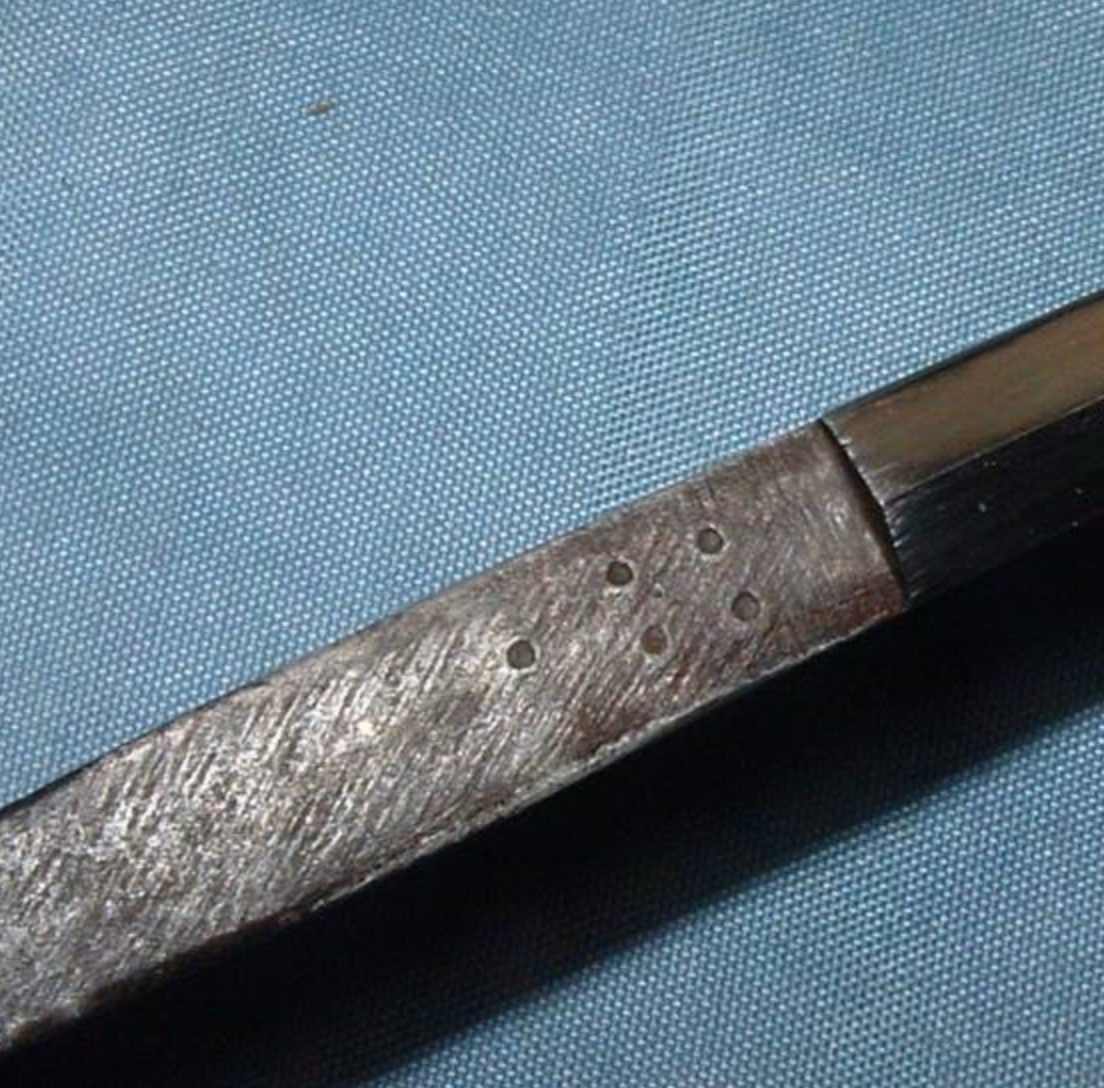

John C Posted March 22, 2024 Report Posted March 22, 2024 @Bruce Pennington Okay - not a gunto but may be of interest. Five dots on the mune of this tanto. Might be of interest if researching the origin of the dots and their meaning. https://www.ebay.com...1:g:NfcAAOSwOtpl9it6 John C Quote
Bruce Pennington Posted March 22, 2024 Report Posted March 22, 2024 On 3/22/2024 at 5:54 AM, John C said: of interest. Expand That's a unique one, John, thanks! Fairly straight blade, attributed to Sue Mihara school (what, Koto?). If so, they've been using these dots for quite some time, not just a WWII era practice. I've seen single dots on older blades, but this is the first 5-group I've seen on one. I'll file it for sure. Quote

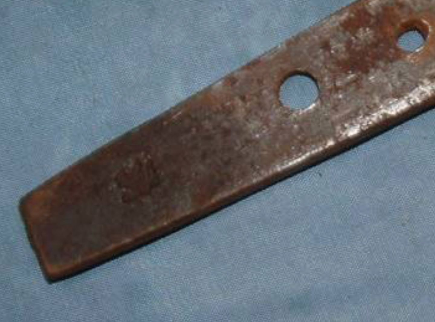

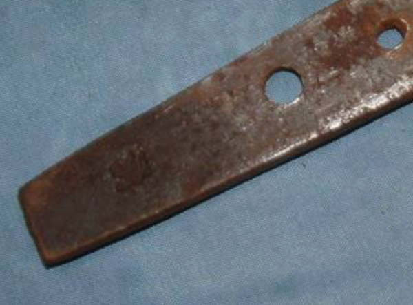

John C Posted March 23, 2024 Report Posted March 23, 2024 @Bruce Pennington Could this be a smith stamp? On a kyu gunto: https://www.ebay.com...8:g:TEcAAOSwyzdl~wn1 John C. Quote
Bruce Pennington Posted March 23, 2024 Report Posted March 23, 2024 Wow, John, don't really know. It's not anything I recognize. Might be a shop stamp, too. Quote

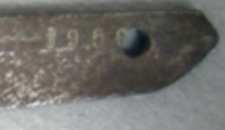

John C Posted March 24, 2024 Report Posted March 24, 2024 @Bruce Pennington A star-stamped gendaito Tsugukiyo with stamped numbers. Not sure if you have this one recorded. https://japaneseswor...to-by-baba-tsugukiyo John C. 1 Quote
Bruce Pennington Posted March 24, 2024 Report Posted March 24, 2024 On 3/24/2024 at 4:38 AM, John C said: @Bruce Pennington A star-stamped gendaito Tsugukiyo with stamped numbers. Not sure if you have this one recorded. https://japaneseswor...to-by-baba-tsugukiyo John C. Expand Good one, John! Didn't have this one. I only have 2 of his, one Aug '41 "232" before the RJT program, and the other Mar '43, "2042". What's your opinion of that number 1950; 1958; 1959? Oh, and too bad the corrosion obliterated any painted numbers! With the tsuba stamped "70" this would have been a perfect one to test your latest painted number observations. Quote
