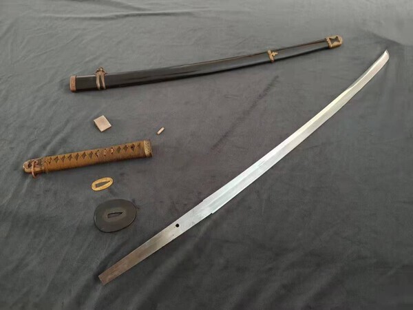

Kiipu Posted August 30, 2023 Report Posted August 30, 2023 On 4/26/2021 at 3:40 PM, BANGBANGSAN said: This Kai Gunto looks like has rocking star mark on the tang Expand Help! Is that a Takayama blade with that blunt tip? Also the longer than normal tang that is seen on these as well. Quote

Bruce Pennington Posted August 30, 2023 Report Posted August 30, 2023 No, it was a blade posted by Trystan, back on 4/26/2021. This one: Quote

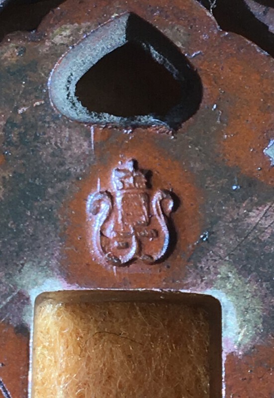

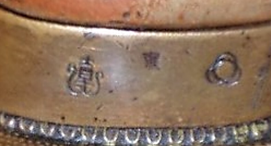

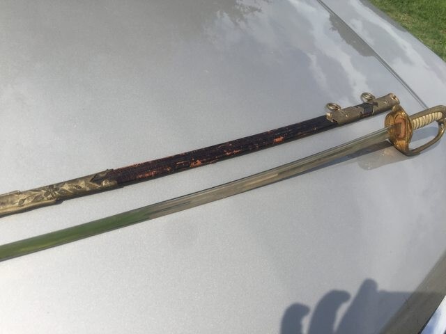

Kiipu Posted September 28, 2023 Report Posted September 28, 2023 Oops! Mistakes happen from time to time. Obviously a Chinese fake as Japanese craftsmanship is sooo perfecttttttt. Chinese/ Japanese saber id help Quote
Bruce Pennington Posted September 29, 2023 Report Posted September 29, 2023 On 9/28/2023 at 10:54 PM, Kiipu said: Obviously a Chinese fake as Japanese craftsmanship is sooo perfecttttttt. Expand Good example of the Toyokawa anchor in sakura found on fittings, along with the Suya stamp. It's early, and my brain isn't fully spun-up yet, but you're joking about it being fake, right? Sorry for being slow on the take. Quote
Kiipu Posted September 29, 2023 Report Posted September 29, 2023 My comment was based upon the Suya logo being upside-down. What do you think is wrong with it? Quote

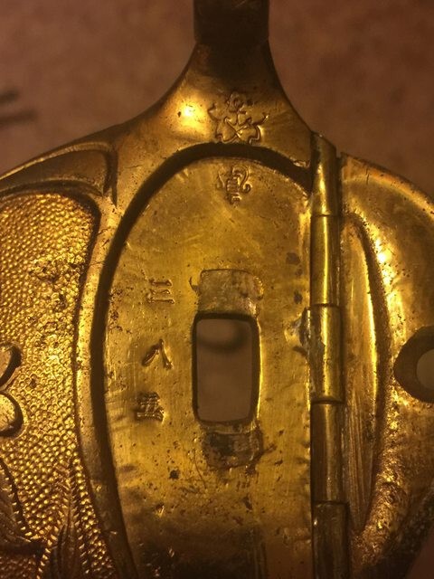

BANGBANGSAN Posted September 29, 2023 Report Posted September 29, 2023 @Bruce Pennington The tang of this Kai appears to be stamped with 天 118 1 Quote
Conway S Posted September 29, 2023 Report Posted September 29, 2023 Here is another Toyokawa / Suya with an upside down stamp. It's currently on eBay: https://www.ebay.com/itm/276062302943 Conway 1 Quote

Bruce Pennington Posted September 29, 2023 Report Posted September 29, 2023 On 9/29/2023 at 3:16 PM, Kiipu said: What do you think is wrong with it? Expand Is there something wrong? It seems to match other examples. Quote

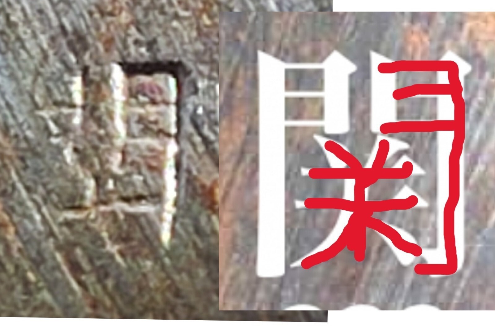

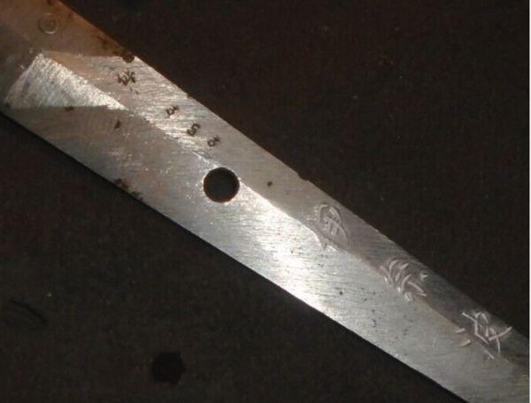

John C Posted October 6, 2023 Report Posted October 6, 2023 @Bruce Pennington Any idea on this partial stamp? I looked through the document but couldn't find a match. It's on a Yoshishige showato. John C. Quote
Bruce Pennington Posted October 6, 2023 Report Posted October 6, 2023 On 10/6/2023 at 3:08 AM, John C said: e Pennington Any idea on this partial stamp? Expand * a twinkle in my eye * Ha! You had me there for a while! But I see it. It's the right side of the Seki stamp: Can I have a link, or photos of both sides of the nakago, with an overall fittings photo, too, for the files & chart? Forgive my POOR photo editing skills! 1 Quote
John C Posted October 6, 2023 Report Posted October 6, 2023 On 10/6/2023 at 4:25 AM, Bruce Pennington said: Can I have a link, Expand Sure. I asked because he notes in the description he couldn't identify the stamp and I couldn't either. Was hoping it was going to be of interest. https://www.ebay.com/itm/134755212516 John C. Quote
Bruce Pennington Posted October 6, 2023 Report Posted October 6, 2023 On 10/6/2023 at 3:12 PM, John C said: Was hoping it was going to be of interest. Expand Yes, thanks for the ink. Only have 10 large Seki stamps in 1943 compared to 70 of them in 1942. Komonjo lists this one as 1942, but it's a '43 Quote
John C Posted October 12, 2023 Report Posted October 12, 2023 @Bruce Pennington Bruce: Any idea what the x above the Suya Shoten mark represents? https://www.ebay.com/itm/256186490944 John C. Quote
Bruce Pennington Posted October 12, 2023 Report Posted October 12, 2023 On 10/12/2023 at 12:01 AM, John C said: x above the Suya Shoten mark Expand It's not something that I've seen associated with Suya markings. After looking at the whole fuchi, as well as the gunto, I'd say this thing has been banged around a lot. There are many small dings, dots, and marks on it, like that blob by the Kokura stamp. I'd write it off to multiple knocks and dings. 1 Quote

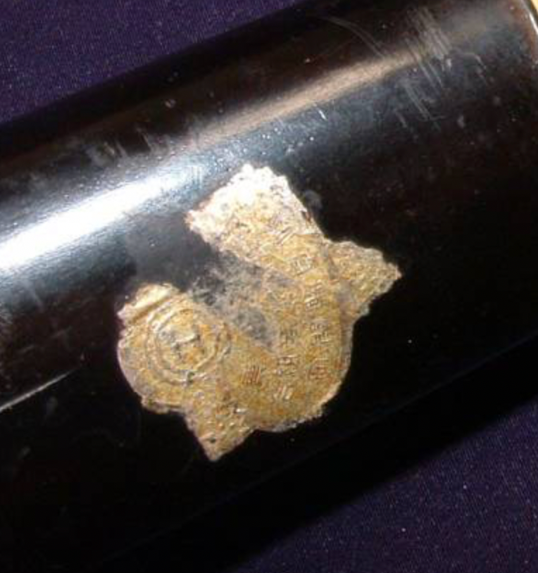

John C Posted October 22, 2023 Report Posted October 22, 2023 @Bruce Pennington You have this label recorded already. Wasn't sure if you wanted to record the sword (saya actually) it came from: Kikumitsu dated 1945. https://www.ebay.com...3:g:wZwAAOSw3e5lLyNH John C. 1 Quote
