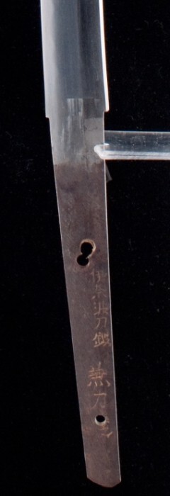

BANGBANGSAN Posted August 20, 2023 Report Share Posted August 20, 2023 16 hours ago, Bruce Pennington said: Trystan, What sort of gunto was this in? Also, what are your thoughts? Do you think he's saying his art name is Inaba Kanenami, or is he saying he is Kanenami of Inaba (forge)? I don't know if it was in Kai Gunto fitting, that's the only photo I saw. I think 兼波 works in 伊奈波鍛鍊場, like other smiths-兼利&兼立. Quote Link to comment Share on other sites More sharing options...

Bruce Pennington Posted August 21, 2023 Report Share Posted August 21, 2023 17 hours ago, BANGBANGSAN said: 兼立 Thanks for those examples, Trystan. I think you're right. Seems unlikely all 3 of these guys had the first name "Inaba"! How about an English translation of 兼立. Can't find it in my sources and google translate calls it "Kanetsu". Quote Link to comment Share on other sites More sharing options...

BANGBANGSAN Posted August 21, 2023 Report Share Posted August 21, 2023 1 hour ago, Bruce Pennington said: Thanks for those examples, Trystan. I think you're right. Seems unlikely all 3 of these guys had the first name "Inaba"! How about an English translation of 兼立. Can't find it in my sources and google translate calls it "Kanetsu". Bruce I'm not sure, maybe Kaneritsu? Interestingly, the Chinese pronunciations for 利 (li), 力 (li), and 立 (li) are all 'Li' 1 Quote Link to comment Share on other sites More sharing options...

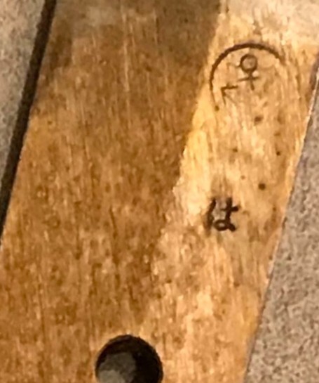

Kiipu Posted August 23, 2023 Report Share Posted August 23, 2023 On 2/27/2020 at 7:58 AM, BANGBANGSAN said: One more stamp for you, it's on the type 97 Kai Gunto. Was the は stamped sword in postwar souvenir fittings? I ask as it has a black painted 2-digit subassembly number. 1 Quote Link to comment Share on other sites More sharing options...
BANGBANGSAN Posted August 24, 2023 Report Share Posted August 24, 2023 8 hours ago, Kiipu said: Was the は stamped sword in postwar souvenir fittings? I ask as it has a black painted 2-digit subassembly number. I couldn't found any other pictures of this sword, but from what I remember, it's in souvenir fittings。 2 Quote Link to comment Share on other sites More sharing options...

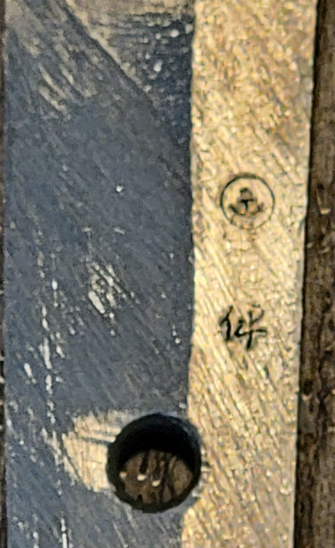

Kiipu Posted August 24, 2023 Report Share Posted August 24, 2023 On 9/26/2019 at 11:46 AM, BANGBANGSAN said: 力 mark on Kai gunto tang. I found a second sword with this marking and it was posted by none other than Trystan! See images 5367, 5368, and 5369. Kai Gunto issued by IJN? Quote Link to comment Share on other sites More sharing options...

Bruce Pennington Posted August 24, 2023 Report Share Posted August 24, 2023 13 hours ago, Kiipu said: I found a second sword with this marking and it was posted by none other than Trystan! See images 5367, 5368, and 5369. Kai Gunto issued by IJN? 12 hours ago, Conway S said: Here is another one I found recently on eBay. Tang and fittings all marked 941. Thanks for these. Brings the total to 5 like this. On another note, Thomas, these highlight my hesitation to include some of the blades you've discovered with 2-digit, black numbers in the souvenir file, having no fittings to confirm. I've listed them, as you may be right, but as we see on these blades and some others I've just checked, there were active wartime kaigunto blades with black numbers too. So far, I've only found them with 3 and 4 digit numbers, but that would imply that in previous years there were 2 digit numbers as well. I haven't seen any, though, in kaigunto fittings. Interesting to see that these "Ka" stamped blades are all in late war kaigunto fittings. Don't know what that says to us. Quote Link to comment Share on other sites More sharing options...

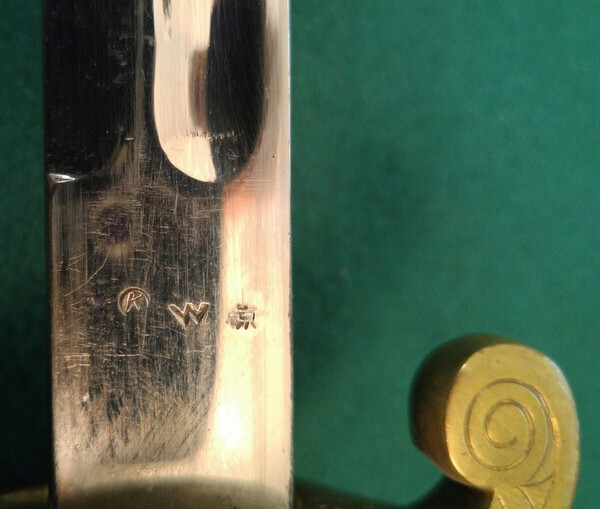

Bruce Pennington Posted August 24, 2023 Report Share Posted August 24, 2023 12 hours ago, Conway S said: Here is a small encircled 力 on the drag of a Type 19 parade sword. Good find, Conway. I only have 1 other with that mark and it's on a police blade ricasso. It is an unknown area of shops and inspector marks. Here is a similar one with a "K" in circle And another one with a "イ" in circle. Quote Link to comment Share on other sites More sharing options...

BANGBANGSAN Posted August 24, 2023 Report Share Posted August 24, 2023 14 hours ago, Kiipu said: I found a second sword with this marking and it was posted by none other than Trystan! See images 5367, 5368, and 5369. Kai Gunto issued by IJN? I have several swords with this mark in my files. I think the "カ" might be an abbreviation for "Kamakura," which is where the "天照山鍛鍊場" was located. Quote Link to comment Share on other sites More sharing options...

BANGBANGSAN Posted August 25, 2023 Report Share Posted August 25, 2023 18 hours ago, Bruce Pennington said: Google translate gives me: “Amaterasu-san training ground” 18 hours ago, Bruce Pennington said: Google translate gives me: “Amaterasu-san training ground” 天照山鍛鍊場=Tenshōzan Forge 鐮倉=Kamakura Quote Link to comment Share on other sites More sharing options...
Bruce Pennington Posted August 25, 2023 Report Share Posted August 25, 2023 35 minutes ago, BANGBANGSAN said: 天照山鍛鍊場=Tenshōzan Forge Thanks Trystan! I was away from home and my files, and trying to read that on my phone. I thought I recognized some of the Tenshozan kanji, but google threw me off. And yes, using the "Ka" kana for Kamakura would line up with other examples, like where the Army used a katakana from the prefectures name. So, of the 4 Toyokawa + (stamp), we have: Inaba Forge and Kamakura, Tenshozan Now we need to figure out Ha and Kissing Ducks/mustache Quote Link to comment Share on other sites More sharing options...
John C Posted August 25, 2023 Report Share Posted August 25, 2023 2 hours ago, Bruce Pennington said: Kissing Ducks/mustache Bruce: This looks a bit like a stylized M over a "castle" shape. Are there any forges that begin with the letter M and are associated with a castle? John C. 1 Quote Link to comment Share on other sites More sharing options...
Bruce Pennington Posted August 26, 2023 Report Share Posted August 26, 2023 That's beyond my abilities. Unleash the sleuth-hounds!!! Quote Link to comment Share on other sites More sharing options...
BANGBANGSAN Posted August 26, 2023 Report Share Posted August 26, 2023 On 8/25/2023 at 9:12 PM, Bruce Pennington said: Kissing Ducks/mustache Maybe the Nagoya City emblem? 1 Quote Link to comment Share on other sites More sharing options...
Bruce Pennington Posted August 27, 2023 Report Share Posted August 27, 2023 That has potential. It made me think of an image if you take the right side and flip it over, to have 2 strokes, like the right side, facing each other. What if it's a stylized hachi - 八 - ? Quote Link to comment Share on other sites More sharing options...
BANGBANGSAN Posted August 27, 2023 Report Share Posted August 27, 2023 7 hours ago, Bruce Pennington said: That has potential. It made me think of an image if you take the right side and flip it over, to have 2 strokes, like the right side, facing each other. What if it's a stylized hachi - 八 - ? The Nagoya city emblem, resolved in the city council's October 1907 (Meiji 40) meeting, originates from the "〇に八の字"( Maruhachi) used as a joint seal by the Owari Tokugawa family. In the history of the Nagoya city council, it is explained that the circular emblem symbolizes boundless and harmonious expansion, with the inner "八" representing a supporting and expanding form, signifying growth through accumulated years. Additionally, the "八" is likened to the earth's feminine principle, signifying growth and progress, akin to the path of supporting a load, as well as raising sails with favorable winds. This emblem signifies Nagoya's continuous and peaceful development, poised for expansion, and in alignment with the winds of progress. 2 Quote Link to comment Share on other sites More sharing options...
Bruce Pennington Posted August 28, 2023 Report Share Posted August 28, 2023 I just checked the map and see that Nagoya was just north of the Toyokawa Navy Arsenal, and the Inaba shrine/forge was just north of Nagoya, so they make sense. It looks like Kamakura was quite a bit east of Toyokawa, and quite close to Tokyo. So, Inaba forge and "Nagoya" make sense, but Kamakura doesn't seem to fit well. Quote Link to comment Share on other sites More sharing options...
