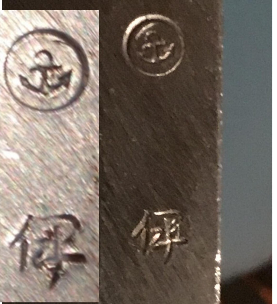

Jcstroud Posted April 25, 2023 Report Posted April 25, 2023 You will also find this mark on pg 91 of 104 in Malcolm's Japanese Naval Swords pdf part2 by the same Inaname Kanenami . I guess it must be koshirai shop trademark I am assuming both toshos share the same marks likely Toyokawa inspection marks? Quote
Bruce Pennington Posted April 25, 2023 Report Posted April 25, 2023 There is a moderate discussion of this on this thread: Help on Translating Nakago Mei. Back then, I had found an online page for the Inaba Tanrenjo, and I tossed that around with Mal Cox a bit. But inconclusive. If the mark is of a forge, as opposed to a personal mark of Kaneyoshi, then the other marks posted in that discussion (an in the Stamps Doc) are by implication, forge marks too. Quote

Bruce Pennington Posted April 25, 2023 Report Posted April 25, 2023 On 4/25/2023 at 4:03 PM, Jcstroud said: the kanji at the Inaba shrine seems to be a match Expand John, can you post a pic of what you found? I can't find a photo with that character. Or are you just referring to the name - 伊奈波神社? Quote
Jcstroud Posted April 25, 2023 Report Posted April 25, 2023 You can google the Inaba shrine but the photos are copyrighted.checkitout! Quote
Bruce Pennington Posted April 25, 2023 Report Posted April 25, 2023 On 4/25/2023 at 6:23 PM, Jcstroud said: You can google the Inaba shrine but the photos are copyrighted.checkitout! Expand I did Google the shrine and got hundreds of photos, but saw no kanji on the shrine. That’s why I asked if the kanji you are referring to is simply in the written name - 伊奈波神社. If not, maybe you could show a photo of the image you are seeing. Thanks. Quote

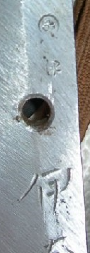

Jcstroud Posted April 25, 2023 Report Posted April 25, 2023 On 4/25/2023 at 5:16 PM, Bruce Pennington said: John, can you post a pic of what you found? I can't find a photo with that character. Or are you just referring to the name - 伊奈波神社? Expand Here you go. 1 Quote
Bruce Pennington Posted April 26, 2023 Report Posted April 26, 2023 Yes, very similar, so I doubt it's coincidence. Yet noticeably different, different enough to give the translation guys fits. With kanji, every stroke counts, including the direction of a stroke. You can see in the photo how the two are different. Considering the fact we have not found the mark on other smith's work, it's hard to think of it as a forge logo. But personal marks are usually at the end of mei, not up top with arsenal inspector marks. So, it's a mystery for now. Quote
Jcstroud Posted April 26, 2023 Report Posted April 26, 2023 On 4/26/2023 at 12:08 PM, Bruce Pennington said: Yes, very similar, so I doubt it's coincidence. Yet noticeably different, different enough to give the translation guys fits. With kanji, every stroke counts, including the direction of a stroke. You can see in the photo how the two are different. Considering the fact we have not found the mark on other smith's work, it's hard to think of it as a forge logo. But personal marks are usually at the end of mei, not up top with arsenal inspector marks. So, it's a mystery for now. Expand Question if you were to find the same symbol written in pencil on the wood end of the tsuka under the fuchi what would be the significance.??? Quote
Bruce Pennington Posted April 26, 2023 Report Posted April 26, 2023 On 4/26/2023 at 2:52 PM, Jcstroud said: significance Expand The first option is that the mark is like all other fitter/assembly markings, put there by whomever marks blades and fittings to keep them together. That is what we assume in almost all other cases. However, my hesitancy comes from knowing there are known cases of fitters using marks already on blades to mark the fittings with. For example, I have Mantetsu on file where the fitters used the serial number on the fittings, while other Mantetsu have painted numbers added that match the fittings. Additionally, there are RJT blades with stamped numbers that, I believe, were there before the fitters got hold of the blade and used the stamped number for their fittings, versus RJT blades, with stamped numbers, that have different painted numbers that match the fittings. I don't know if I explained that well. But to me, it could be either way with these additional marks on Toyokawa blades. But the fact that the Inaba-like stamp is only found on Inaba blades speaks to me of something other than a fittings mark, and the fitters simply used the mark that was already there to mark their parts. I definitely could be wrong. 1 Quote

Jcstroud Posted April 27, 2023 Report Posted April 27, 2023 Could that mean Toyosuke was a assistant to Inaba Kaneyoshi.? Working at the inaba shrine ? It seems i have left no stone unturned your patience with me and all my unanswerable questions deserves at the very least an honorable mention. Thank you all. John 1 Quote
Bruce Pennington Posted April 27, 2023 Report Posted April 27, 2023 On 4/27/2023 at 12:50 AM, Jcstroud said: Could that mean Toyosuke was a assistant to Inaba Kaneyoshi.? Working at the inaba shrine ? Expand That is a question best presented to guys like @mecox and @george trotter But, the fact that you've found the mark on a Toyosuke tsuba (sorry, don't remember if you've already shown that to me! Can you post for my files?) actually supports the idea of it being a shop logo. There are many tsuba in the files with various shop logo stamped on them. Hmmmm..... shop logo???? Interesting. This points back to my question about the Inaba Tanrenjo. Quote
Bruce Pennington Posted April 27, 2023 Report Posted April 27, 2023 Just found one on file that shows the strokes the best: Quote

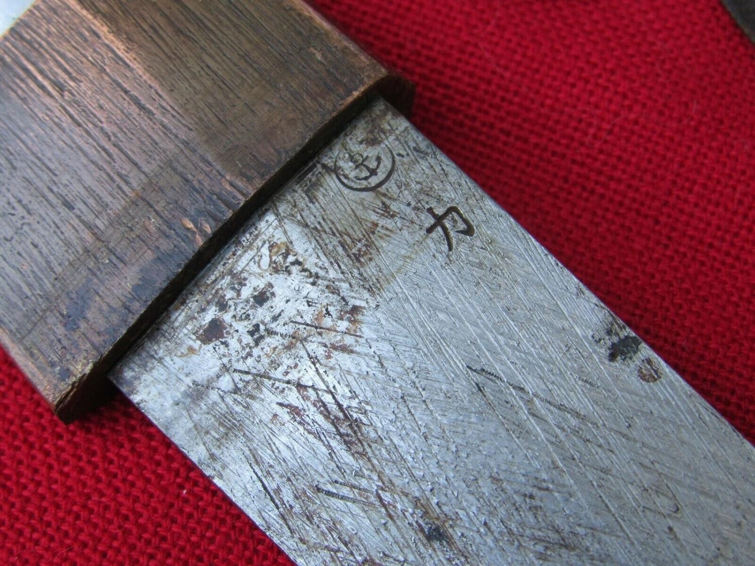

Jcstroud Posted April 27, 2023 Report Posted April 27, 2023 On 4/25/2023 at 12:37 AM, Jcstroud said: Hey Bruce we might have something here...the above photo of the stainless nakabo the mark below the 4mm anchor stamp has the same symbol as the wood end on the tsuka of Toyosuke #45 ! Expand The marks are in pencil and are very faint this is the drawing in my notes showing the locations .they are very similar but seemingly inconclusive but no other ninben kanji comes close.except the ninben for tsuka. Quote
Bruce Pennington Posted April 27, 2023 Report Posted April 27, 2023 On 4/27/2023 at 12:31 PM, Jcstroud said: The marks are in pencil and are very faint this is the drawing in my notes showing the locations .they are very similar but seemingly inconclusive but no other ninben kanji comes close.except the ninben for tsuka. Expand John, Sorry, I've been chasing too many rabbits lately, both here and at home. I'm catching up with you a bit. Posting your notes vertically: I looked back over your original posts and don't see a photo of these markings on the tsuka. Can you post for us? Also, the photo of all the seppa is too blurry to see the markings, can we get a good clear shot of them too? So there are 3 markings on the tsuka? "HO" "2" and the logo? And the notes at the bottom - they aren't from writing on the souvenir, are they? Are they just your research notes? Quote

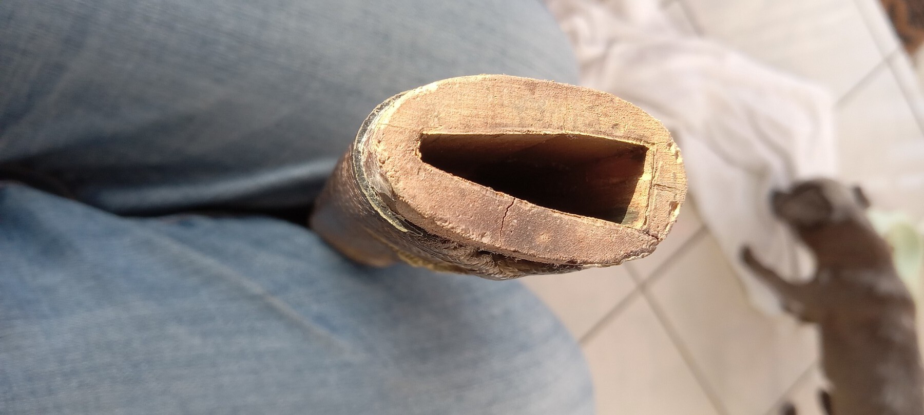

Jcstroud Posted April 27, 2023 Report Posted April 27, 2023 On 4/27/2023 at 2:44 PM, Bruce Pennington said: John, Sorry, I've been chasing too many rabbits lately, both here and at home. I'm catching up with you a bit. Posting your notes vertically: I looked back over your original posts and don't see a photo of these markings on the tsuka. Can you post for us? Also, the photo of all the seppa is too blurry to see the markings, can we get a good clear shot of them too? Asap will try again to get photo Yes they are just research notes. Expand 1 Quote
Jcstroud Posted April 27, 2023 Report Posted April 27, 2023 Best i can do very faint but there 1 Quote
John C Posted April 27, 2023 Report Posted April 27, 2023 JC: Are these from the same sword or do you have two with assembly number 45? John C. Quote
Jcstroud Posted April 27, 2023 Report Posted April 27, 2023 Yes they from the same sword I only have this one Toyosuke #45 found it in Puerto rico mountains.7 years ago 1 1 Quote

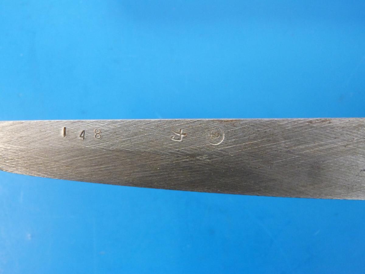

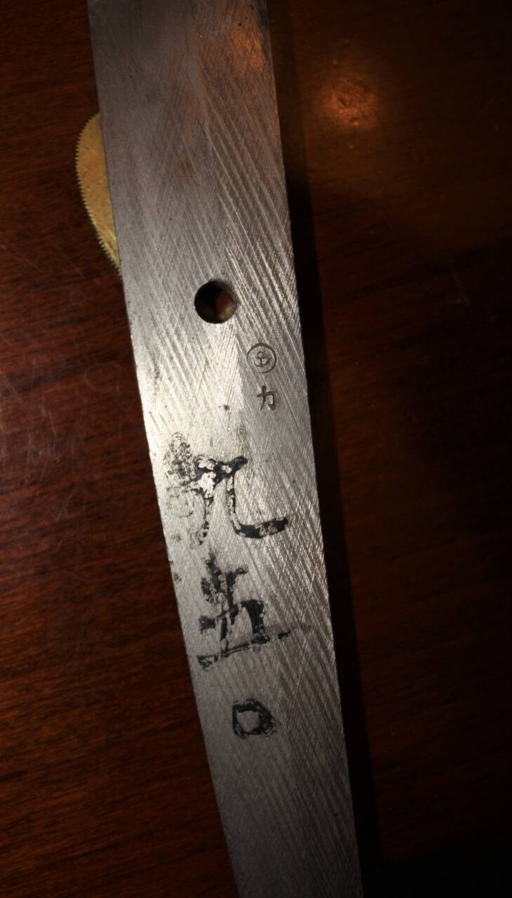

BANGBANGSAN Posted April 28, 2023 Report Posted April 28, 2023 The カ (Ka) mark should be an inspection mark for 鎌倉 カマクラ, where the 天照山鍛錬場 Tenshōzan Forging Workshop was located. Quote
Jcstroud Posted April 28, 2023 Report Posted April 28, 2023 On 4/28/2023 at 2:16 PM, BANGBANGSAN said: The カ (Ka) mark should be an inspection mark for 鎌倉 カマクラ, where the 天照山鍛錬場 Tenshōzan Forging Workshop was located. Expand On 4/28/2023 at 2:16 PM, BANGBANGSAN said: The カ (Ka) mark should be an inspection mark for 鎌倉 カマクラ, where the 天照山鍛錬場 Tenshōzan Forging Workshop was located. Expand Bang Bang san do you have more info on this sword? Nakago pics etc? Quote
Bruce Pennington Posted April 28, 2023 Report Posted April 28, 2023 On 4/28/2023 at 2:16 PM, BANGBANGSAN said: 鎌倉 カマクラ Expand Trystan, Could you give me an English version of that name for my files? On 4/28/2023 at 3:06 PM, Jcstroud said: more info on this sword? Nakago pics Expand John, I have 3 of these on file: The one posted by Trystan One from Wehrmacht-awards And from Guns.ru Quote
Jcstroud Posted April 28, 2023 Report Posted April 28, 2023 鎌倉 カマクラ. I think trystan wrote. KAMAKURA not sure what the two first kanji symbols are .mid war,4mm stamps,varied locations, same filemark patterns, Quote
BANGBANGSAN Posted April 28, 2023 Report Posted April 28, 2023 On 4/28/2023 at 7:48 PM, Jcstroud said: 鎌倉 カマクラ. I think trystan wrote. KAMAKURA not sure what the two first kanji symbols are .mid war,4mm stamps,varied locations, same filemark patterns, Expand カマクラ (Kamakura) is the pronunciation of the first two kanji 鎌倉, which represents the name of a Japanese city located in Kanagawa prefecture, where the 天照山鍛錬場 Tenshōzan Forging Workshop was located Quote
BANGBANGSAN Posted April 28, 2023 Report Posted April 28, 2023 On 4/28/2023 at 5:47 PM, Bruce Pennington said: Trystan, Could you give me an English version of that name for my files? Expand カマクラ (Kamakura)=鎌倉 海軍鎌倉天照山鍛錬場=Navy Kamakura Tenshōzan Forging Workshop Quote
Bruce Pennington Posted April 28, 2023 Report Posted April 28, 2023 On 4/28/2023 at 10:10 PM, BANGBANGSAN said: カマクラ (Kamakura)=鎌倉 Expand Thanks Trystan! So are you proposing the mark is an inspector mark of the Tenshzan shop? or another shop in the Kamkura area? I could picture it as a contractor inspector stamp of Tenshzan, since the specialized Tenshozan anchor is an army inspector stamp. Maybe this mark was being used by Tenshozan's own inspectors? Quote
