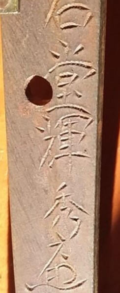

Bruce Pennington Posted January 26, 2023 Report Posted January 26, 2023 Thanks to Kevin, @Beater, who brought a couple of Mitsunobu blades to my attention. I only had 1 other on file, and had not noticed, until Kevin pointed it out, the kao/kakihan is identical to kao found on Teruhide blades. Doing a search, I found a thread where Ray Singer had quoted Rich Stein on his Japanese sword index website stating his opinion that the two may be the same guy. Ishido Teruhide is a well known smith, but I don't see Ishido Mitsunobu in Sesko's list. He's listed in Slough, but Slough believes the mei to be daimei (one smith signing for another). I agree with Rich, and doubt a smith would share his kao with another smith, plus we know of several other smiths that changed their art names over time. So, it's quite conceivable that Ishido Mitsunobu is simply another name used by Ishido Teruhide. Teruhide Mitsunobu I've regrouped the two in the upcoming Stamps doc revision to include this possibility. Another interesting development is the realization that Mitsunobu blades have stamped numbers on the mune under the habaki! I now have 3 on file, all undated - 707, 925, and 958. Hate to think of the rest of them out there undetected because guys post their photos, often, with habaki in place. Quote
John C Posted January 26, 2023 Report Posted January 26, 2023 On 1/26/2023 at 3:23 PM, Bruce Pennington said: Ishido Mitsunobu is simply another name Expand Bruce: Are these both art names or could one be a family name? John C. Quote
mecox Posted January 26, 2023 Report Posted January 26, 2023 John, Ishido is his family name. There is a further compilation of Teruhide/Mitsunobu here page 49 1 1 Quote

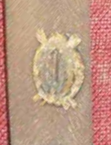

Bruce Pennington Posted February 10, 2023 Report Posted February 10, 2023 On 3/19/2011 at 3:32 AM, Joe Choi said: KaneKado with Kokuin Expand Had some time on my hands, and was browsing. After a close look at this kokuin, it's really quite different that the normal hotstamp. The "1" and trhe outer shape of the turtle? is sunken. But the light brown details, like the legs, are chiseled. You can clearly see what I mean on the upper left leg. Interesting! Quote

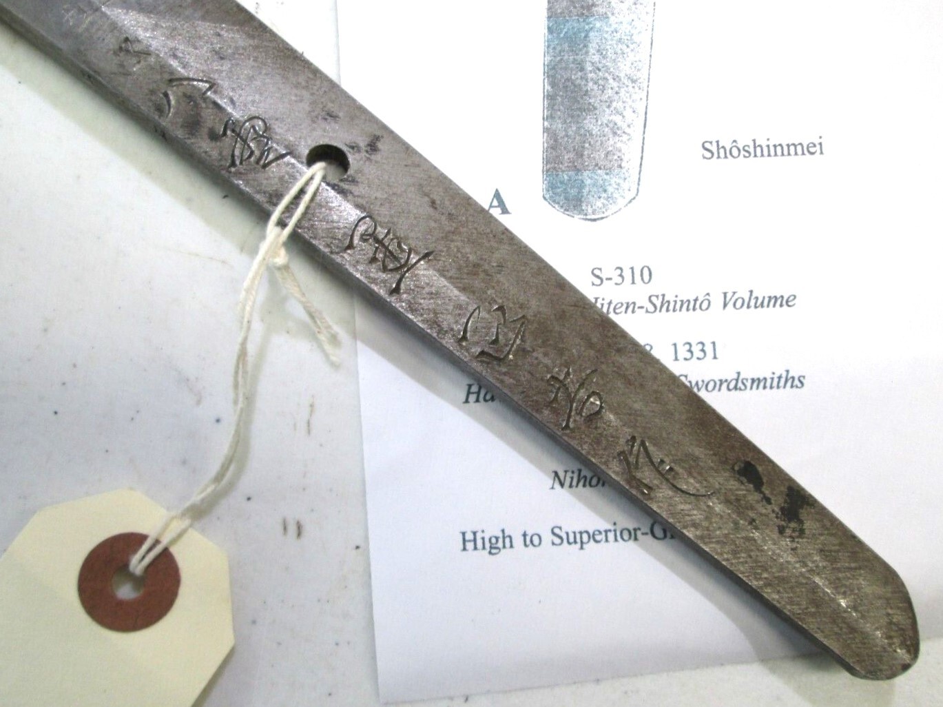

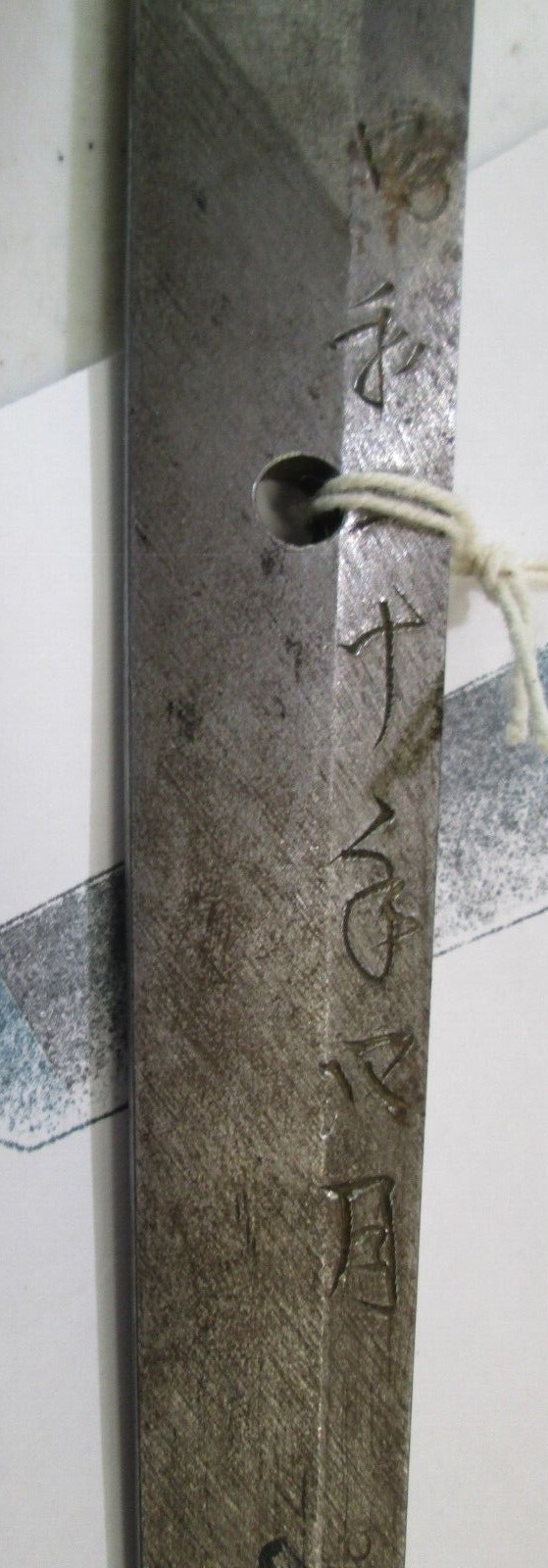

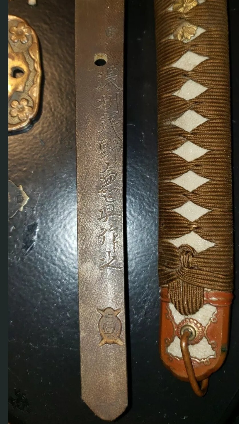

pc3319 Posted February 14, 2023 Report Posted February 14, 2023 Good morning I’m looking for some assistance with translating the marking on my WW2 sword. Any help is greatly appreciated. Paul C Quote
SteveM Posted February 14, 2023 Report Posted February 14, 2023 On 2/14/2023 at 9:00 AM, pc3319 said: I’m looking for some assistance Expand Hello Paul - Seki-jū Mori Toshiharu saku check out the link below. 1 Quote
Beater Posted February 14, 2023 Report Posted February 14, 2023 (edited) On 2/14/2023 at 9:00 AM, pc3319 said: Good morning I’m looking for some assistance with translating the marking on my WW2 sword. Any help is greatly appreciated. Paul C Expand Hi Paul, I believe this is “Seki ju Mori Toshiharu saku” The Sho stamp indicates it is non-traditionally made. Regards, Kevin. Opps - sorry SteveM, you already replied! Edited February 14, 2023 by Beater Realised question had already been answered while I was typing a reply. 1 Quote
pc3319 Posted February 14, 2023 Report Posted February 14, 2023 Ok first thanks for the information I don’t think I could have gotten it without you guys. I still can’t figure out how you can read this as the marking don’t match what’s printed next to the translation or at least not in my untrained first time ever trying eye. This is called a Shin-Gunto sword? And how do you read the markings from the top down or bottom up? I also have a tassel attached, is it proper and exactly what does it mean? Again I can’t thank you enough. Quote
ROKUJURO Posted February 14, 2023 Report Posted February 14, 2023 Paul, the signature (MEI) on the tang (NAKAGO) reads from the point downwards, so it is easier to read if the photos are positioned this way vertically. There are not so many symbols (KANJI) to be learned, however they are so special that most Japanese can't read them. Additionally, it needs a lot of training and comparing with certified signatures in books to be able to read the handwriting. And even if you can read them, you cannot be sure that the swordsmith who made the blade signed with his own name..... 1 Quote
Bruce Pennington Posted February 14, 2023 Report Posted February 14, 2023 GUNTO - "GUN": Army "TO": sword, therefore "Army Sword". Shingunto - "New Army Sword". Kyu gunto: "Old Army Sword. Kai gunto: "Navy Army Sword" (Ha, I know, it does't work well in English). Your tassel, brown/blue, is the Company grade officer tassel (Lt's-Capts), and you've pretty much hung it properly. I highly recommend spending some time reading through Ohmura's most excellent site: Military Swords of Imperial Japan (Gunto). 65 pages of primo photos and several with history and educational stuff. Quote

BANGBANGSAN Posted February 15, 2023 Report Posted February 15, 2023 On 2/10/2023 at 5:07 PM, Bruce Pennington said: Had some time on my hands, and was browsing. After a close look at this kokuin, it's really quite different that the normal hotstamp. The "1" and trhe outer shape of the turtle? is sunken. But the light brown details, like the legs, are chiseled. You can clearly see what I mean on the upper left leg. Interesting! Expand Bruce The hot stamp of Kanezane has a very similar shape. Collectors in China called it "Little turtle"小乌龟。 1 Quote

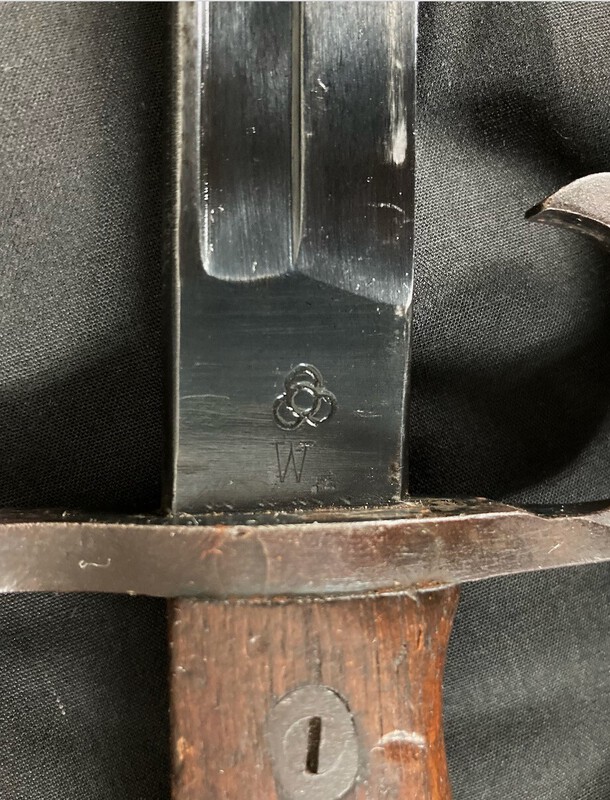

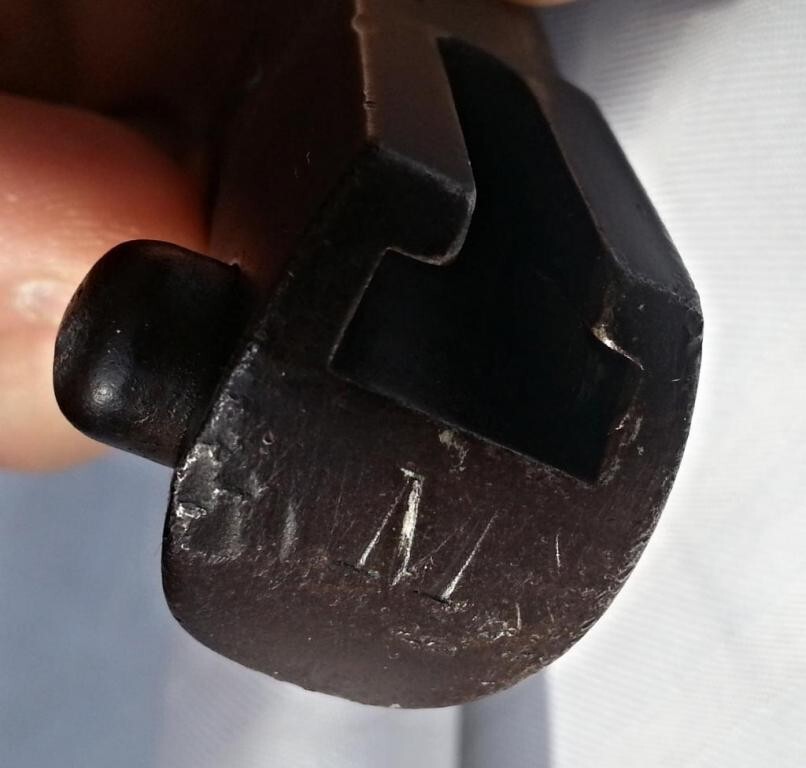

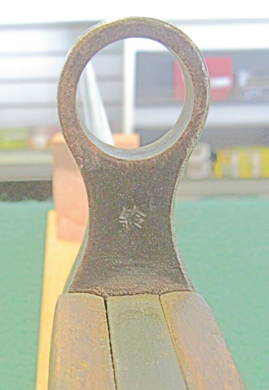

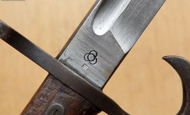

Bruce Pennington Posted February 23, 2023 Report Posted February 23, 2023 Here is a "WA" stamp on a bayonet. Note the Kokura Arsenal stamp. Of this stamp, Fuller says: "Wa" stamp. Probably indicates manufacture in an occupied area, most likely by a collaborating force. Found on poor quality rolled or hammered blades" Since this has a Kokura stamp, I assume the Wa indicates "poor quality rolled or hammered blade" but probably Japanese made on the mainland. Previous examples are on sword blades that were clearly made in "an occupied area." and I appreciate seeing the bayonet example, as it expands on the use of the WA stamp. Corrections or additional thoughts are welcome! Quote

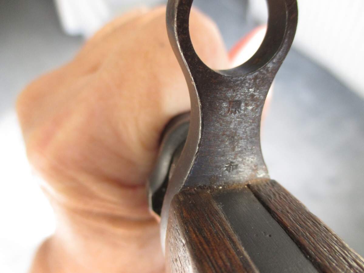

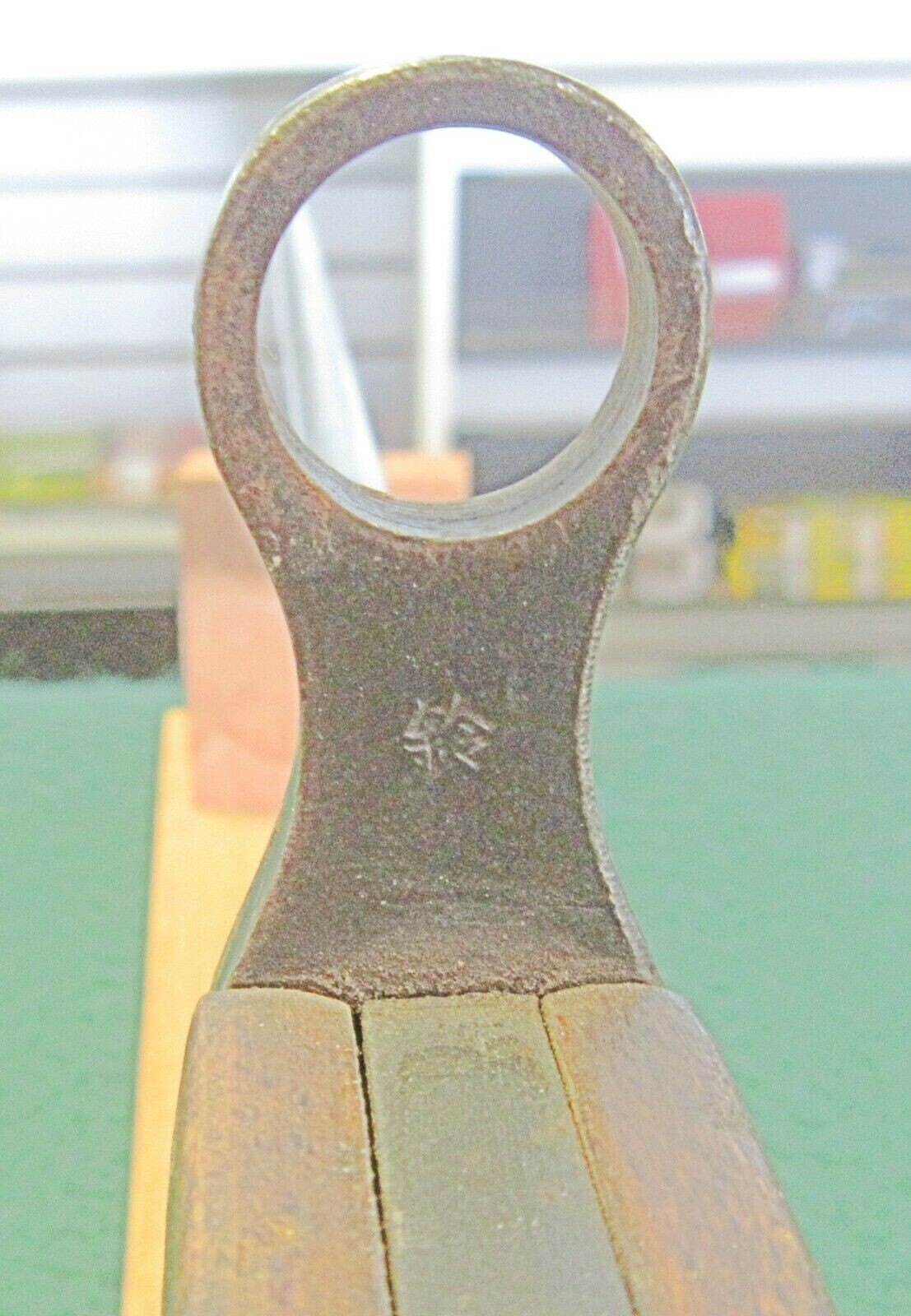

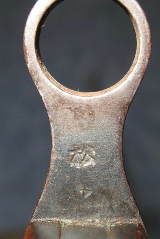

Bruce Pennington Posted February 23, 2023 Report Posted February 23, 2023 There's another stamp on that same bayonet I don't recognize. Anyone make it out? It's pretty faded. @SteveM @Kiipu @BANGBANGSAN Quote
SteveM Posted February 23, 2023 Report Posted February 23, 2023 Hard to say. 鈴 (suzu) as in the name Suzuki? 1 Quote
John C Posted February 23, 2023 Report Posted February 23, 2023 On 2/23/2023 at 6:57 PM, Bruce Pennington said: Anyone make it out? Expand Not real close but could it be a variation of the Toyoda mark (top left in picture)? John C. Quote
BANGBANGSAN Posted February 23, 2023 Report Posted February 23, 2023 鈴,one of the inspection mark for Type 30 bayonet, this one could be the inspection team’s (鈴木) name. There are other kanjis as well,菅,石,原,松,齋etc. @Bruce Penningtonthe 和 mark on the type 30 bayonet has no connection with the ones on the 偽軍刀. There are also the W mark and big M an mark on the pommel of the early type30, and it doesn't look like the M/W mark on the Guntos. 1 1 Quote
Bruce Pennington Posted February 24, 2023 Report Posted February 24, 2023 On 2/23/2023 at 9:19 PM, BANGBANGSAN said: the 和 mark on the type 30 bayonet has no connection with the ones on the 偽軍刀. Expand Ok. Just another reminder of why I've stayed away from Bayonet World! They have a vast array of stamps that would overwhelm my limited time to try to track. So, in short, disregard my first post about the WA, then. Quote

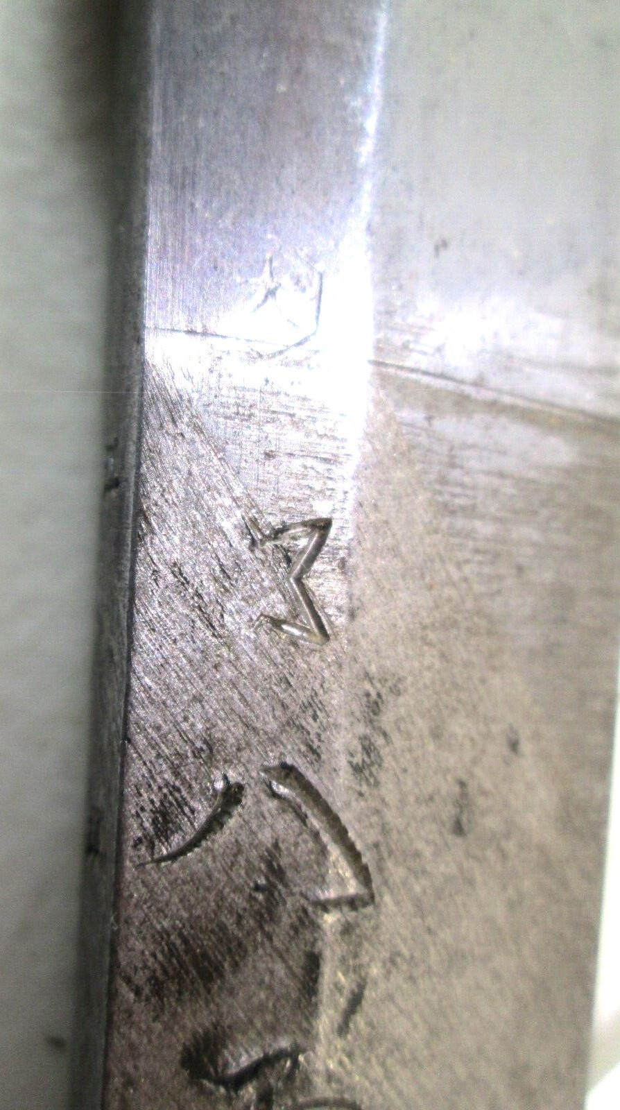

Bruce Pennington Posted March 27, 2023 Report Posted March 27, 2023 Found another "TAI" stamp on a star-stamped Masayoshi blade, 1945. Can't make out the month, is that a cursive style "4" @SteveM? Quote

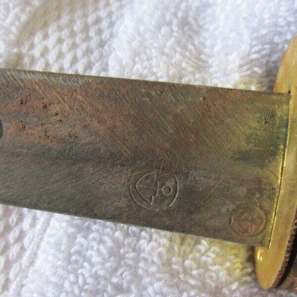

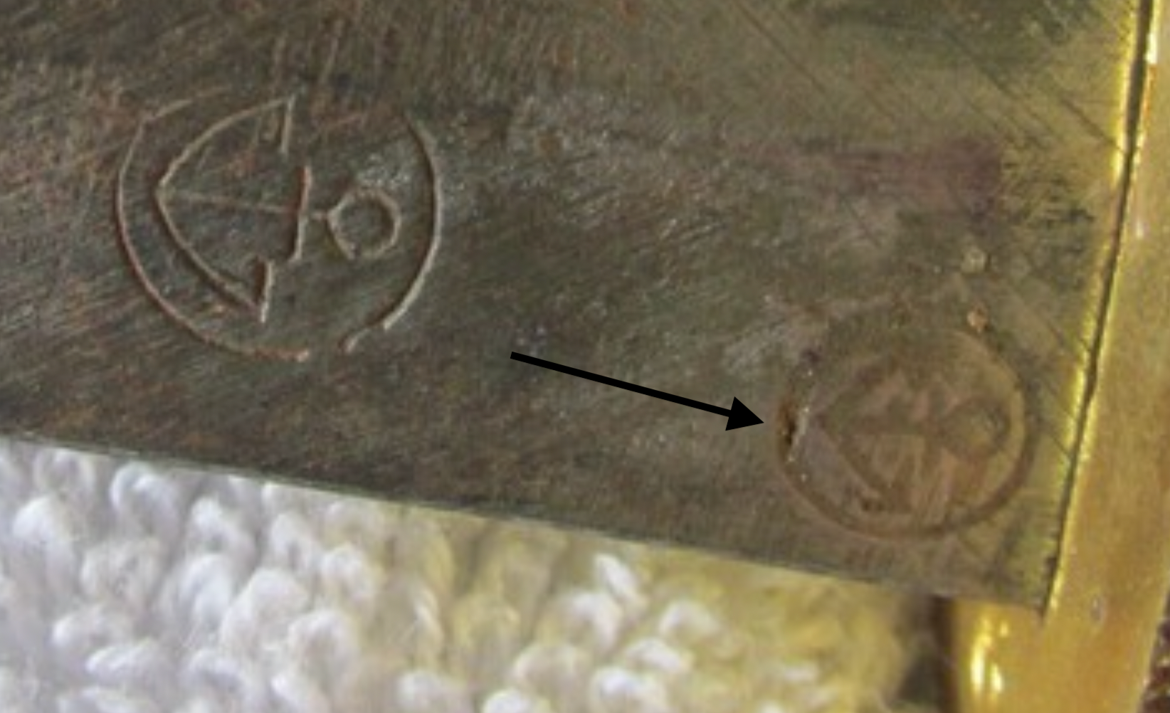

Jcstroud Posted April 17, 2023 Report Posted April 17, 2023 Double anchor stamp? The smaller one is incrusted with olive drab paint points to the possibility it was to (1.) hide the small arsenal stamp or (2) the paint was used to designate the surplus blade for the army contract of the 8747. Then being covered Tenshozan restamped the blade a second time. And then became a "souvenir" .could this mean the small ones came first or a different inspector? Another Mystery!!!!! Quote
John C Posted April 17, 2023 Report Posted April 17, 2023 With that area highlighted by the arrow void of paint and the width of the lines, it appears it may be an acid mark. Just a thought. Hard to tell from pics. Still don't know why there would be two, though. John C. Quote
Jcstroud Posted April 17, 2023 Report Posted April 17, 2023 Why would anyone use acid on a nakago? On 4/17/2023 at 3:31 AM, John C said: With that area highlighted by the arrow void of paint and the width of the lines, it appears it may be an acid mark. Just a thought. Hard to tell from pics. Still don't know why there would be two, though. John C. Expand 1 Quote
