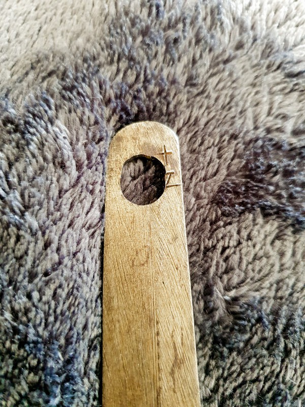

robinalexander Posted November 16, 2022 Report Posted November 16, 2022 Put on this thread for interest @Stegel @Shamsy @Kiipu Couple of marks, possibly assembly marks on the nakago of Pattern 1 Copper 95. 1 1 Quote
Kiipu Posted November 16, 2022 Report Posted November 16, 2022 Rob, what is the serial number of the blade that this marking is coming from? Are there any other markings on the tang? In regards to the nakago marking, I think it could be the number 十五? You will need to rotate the picture around 90 degrees to see it though. 2 Quote
robinalexander Posted November 17, 2022 Report Posted November 17, 2022 Hi Thomas, blade number 4042. No other marking on tang or mune. 十五 so you think it could be 15 ? I have no idea at all but I will throw this is just in case it means something to someone .... 10 + No/Yuki ? Rob 1 Quote

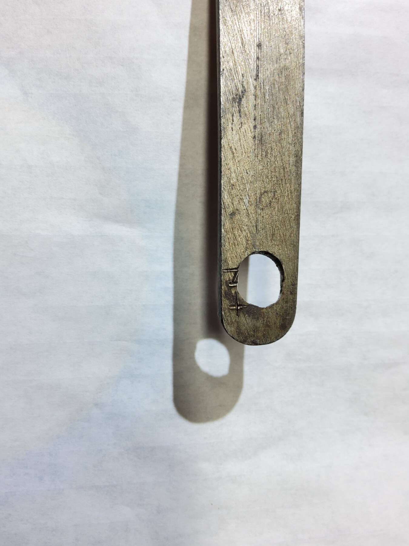

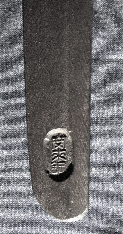

Stegel Posted November 17, 2022 Report Posted November 17, 2022 It's a shame the mounting hole is so close, so as to make ID harder. I have an early type 95 with these stamps instead of the W, and also, some similar scratched numbers on the tang. 1 1 Quote
robinalexander Posted November 17, 2022 Report Posted November 17, 2022 Stegel, I think Thomas is onto something. Yours looks like 95 and as Thomas said, mine looks like 15. Rob Thomas @Kiipu where do you get that kanji (e.g. the number 十五? ) that you can just add into your messages? Quote

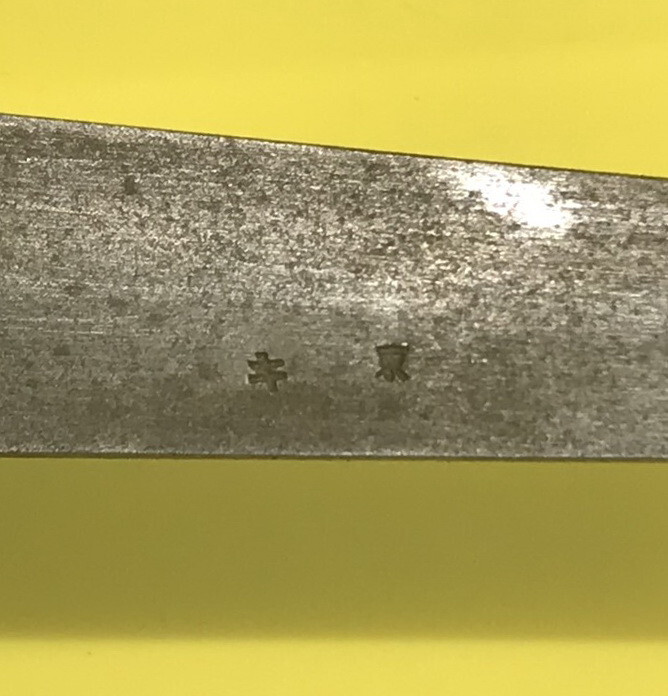

BANGBANGSAN Posted November 17, 2022 Report Posted November 17, 2022 On 11/17/2022 at 5:21 AM, Stegel said: It's a shame the mounting hole is so close, so as to make ID harder. I have an early type 95 with these stamps instead of the W, and also, some similar scratched numbers on the tang. Expand 九五=Type 95? 1 Quote
Bruce Pennington Posted November 17, 2022 Report Posted November 17, 2022 On 11/17/2022 at 5:21 AM, Stegel said: type 95 with these stamps Expand Those are the "Ki" of the 2nd Factory of Tokyo 1st Army Arsenal, and the "To" of Tokyo 1st. 1 Quote
Bruce Pennington Posted November 17, 2022 Report Posted November 17, 2022 After seeing Stegel's numbers, I'd lean toward a "19". The hole cut over the number, if a "5" would have left the topmost horizontal stroke. I've simulated ana over the 9 and 5 of Erns' number: 1 Quote
Kiipu Posted November 17, 2022 Report Posted November 17, 2022 To give credit where credit is due, I was aware of the markings on Stegel's sword from past correspondence and that was what prompted me to think the markings on Rob's sword were numbers. However, I could not come out and state as such as the information was conveyed by private message. It is as we say in the US, Stegel's story to tell. And finally, the number could be any of the ones suggested above. 3 Quote
Stegel Posted November 17, 2022 Report Posted November 17, 2022 These markings are not stamps as such, probably why i didn't mention mine earlier, but Robs is the second one i've seen now, and maybe more exist out there in collectons. We've seen numbers stamped on tangs before and the opinions are either koshirae assembly numbers or personal smith tallys via series/numbering. (even Bruce's Roman numeral numbering system and the 'Dot' punch markings would be included here) I didn't mean to muddy the waters with my example, but highlight the fact that there appears to be another such system which is similar and yet slightly different. Of which Rob's and mine are the two known examples so far. This in itself is not enough to say a system was in place, but we can never say never. My initial thoughts on my sword were the same as Trystan's : Quote 九五=Type 95? Expand however now seeing Rob's i'm not so sure. i'm thinking his looks more like a 19 also, and therefore i'm leaning towards an assembly number of sorts. However, The other fittings are not marked, just the blade itself (on mine at least) I'm was hoping that Thomas upon seeing these as numbers,may have had more info in this matter, to make us all a bit smarter! Looking forward to more thoughts on these! 3 Quote

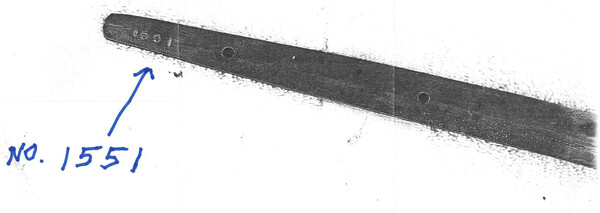

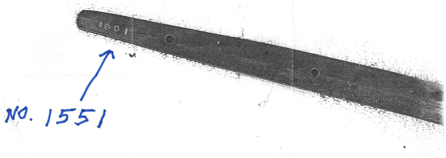

Bruce Pennington Posted November 18, 2022 Report Posted November 18, 2022 As I was filing these, I found (forgot they were there!) two Type 95 nakago with actual stamped numbers - 260, and 1551, both on very late pattern 95s. So the idea isn't out of the question: Quote

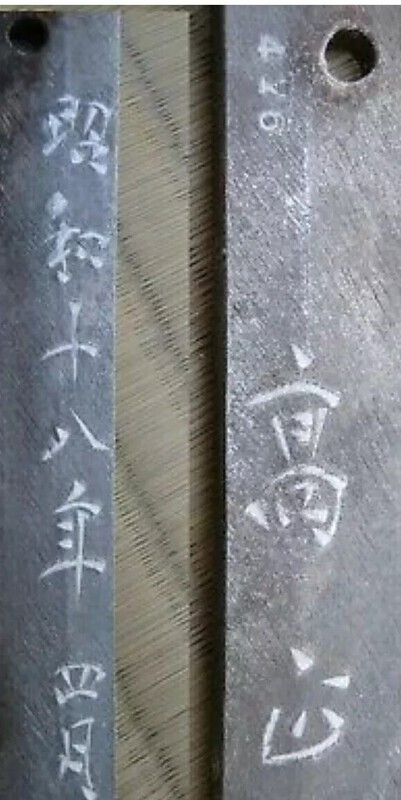

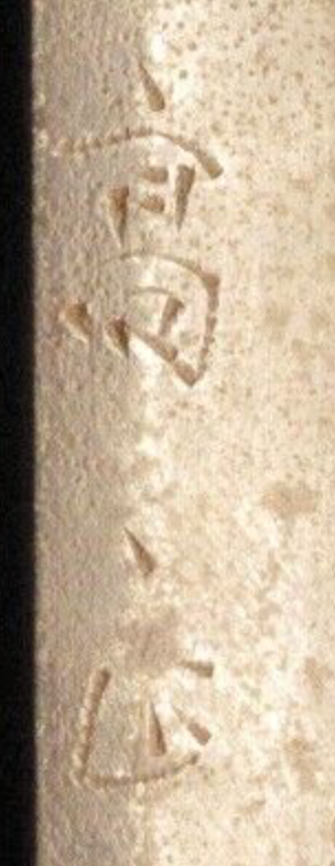

John C Posted November 22, 2022 Report Posted November 22, 2022 Not sure if this fits this thread, however here is a numbered blade. Blade is signed and dated (March 1943) but no other information (blade is broken with no koshirae). There is no bo-hi or serial number on the actual blade, so probably something different than a type 95. John C. Quote
Bruce Pennington Posted November 22, 2022 Report Posted November 22, 2022 On 11/22/2022 at 2:07 AM, John C said: however here is a numbered blade. Expand John, could I get a link to the rest of the photos, either here or via PM? And anyone got a name on this ..... Takamasa? @Kiipu @BANGBANGSAN @SteveM Quote
Bruce Pennington Posted November 22, 2022 Report Posted November 22, 2022 Also, @John C has found another Kanemichi blade with the Yasuki Steel stamp But what's killing me is there are 2 stamps at the top, the lower one likely a Showa stamp, but the upper one totally defies me. Any ideas, guys? Quote
John C Posted November 22, 2022 Report Posted November 22, 2022 On 11/22/2022 at 3:30 AM, Bruce Pennington said: John, could I get a link to the rest of the photos Expand Here it is. But it's just a broken blade for .99 cents! https://www.ebay.com/itm/394343215742?hash=item5bd0aff27e%3Ag%3AUysAAOSwtYdjesli&amdata=enc%3AAQAHAAAAoESP%2FM8Y94bUdjx1HigJbLrXeGO66vWZy180LquXhDXi93CIAk2fBMvG3Q2%2FN5NNdLIFmL0xoyH7SzWLG%2B33RchVcFa1FJNEovbjkjhRK%2FWDvJ19xlYBXpZzqGM6gpDtQoZGwqOgMz8H3vqMi8%2BHphDnsXDGJ6SCRD7N%2BwOmbVRh%2FpeqH%2F6CEf8JtRoOu%2F1HpWY5vwyxlTt5W8jbj9P0Ekg%3D|tkp%3ABk9SR8i96t2TYQ&LH_ItemCondition=4|10 John C. Quote

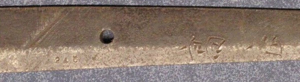

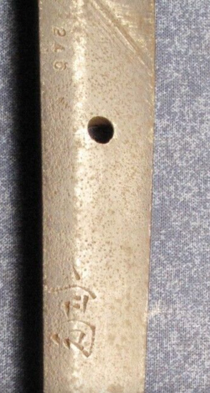

Bruce Pennington Posted November 22, 2022 Report Posted November 22, 2022 On 11/22/2022 at 5:46 AM, John C said: Here it is. Expand Thanks John! Yes, Takamasa, from Sesko: TAKAMASA (高正), Shōwa (昭和, 1926-1989), Gifu – “Takamasa” (高正), real name Yasuda Yoshitarō (安田芳太郎), born April 7th 1912, he worked as guntō smith We now have 3 of his, and all 3 were numbered like this, above the mei: Feb 1943 267 Mar 1943 246 May 1943 476 One of the very few non-RJT smiths with stamped numbers. Quote
Stegel Posted November 23, 2022 Report Posted November 23, 2022 On 11/22/2022 at 2:02 PM, Bruce Pennington said: TAKAMASA (高正), Shōwa (昭和, 1926-1989), Gifu – “Takamasa” (高正), real name Yasuda Yoshitarō (安田芳太郎), born April 7th 1912, he worked as guntō smith We now have 3 of his, and all 3 were numbered like this, above the mei: Feb 1943 267 Mar 1943 246 May 1943 476 One of the very few non-RJT smiths with stamped numbers. Expand Bruce, just an observation, i think we need to confirm the dates. If correct, then i'm unsure of what these numbers actually represent, as they could not be the smiths personal tally as such IMO. (at least what i thought they most likely were) 246 was made in March, but 267 was made in Feb? (a possible time warp- back to the future?) Also assuming 246 was made at the start of March, and 476 at the end of May, then in 3 months he made 230 blades?? The things that make you go hhmmmm!! 1 Quote
Kiipu Posted November 23, 2022 Report Posted November 23, 2022 I think I see numbers on a Takamasa 高正 posted by Shamsy back in 2020. Maybe the same as the one Bruce lists as 267? last ditch naval rinji?, Post #8 Quote
Bruce Pennington Posted November 23, 2022 Report Posted November 23, 2022 On 11/23/2022 at 2:26 AM, Kiipu said: Maybe the same as the one Bruce lists as 267? Expand Yes, that's the one. On 11/23/2022 at 12:58 AM, Stegel said: just an observation, i think we need to confirm the dates. Expand Already thought of that! Pictures below. I have come across other examples of a number out of sequence, and it's puzzling. But I think Thomas might have mentioned the idea that some of these blades were collected by an Area Inspector and transported to the Arsenal for processing. Whether he stamped the blades or it was done at the arsenal is unknown. So, maybe another smith's blades were mixed in accounting for the increased number gap. I've not found numbers to be in a complete jumble, they are predominantly in order, per smith, but there are other examples of a single number out of sequence. Feb '43 267 Mar '43 246 Apr '43 476 1 Quote
