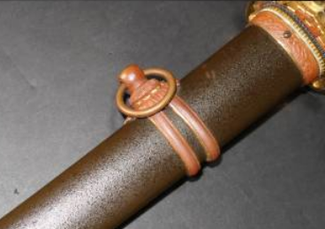

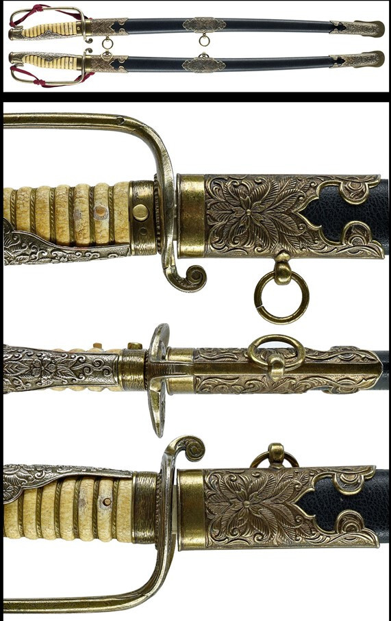

Bruce Pennington Posted July 2, 2022 Report Posted July 2, 2022 Trystan, These 1886 pattern Cavalry, or Type 8?, swords are a mystery. I have one other with a double stamp, different logo, on file. I suspect they were shops making these swords, but have no data on them. Here's the other one I have: Quote
Kiipu Posted July 2, 2022 Report Posted July 2, 2022 I have one other on file and it only has a single stamp. It could be the characters 内山 one over the other? 1 Quote
BANGBANGSAN Posted July 3, 2022 Report Posted July 3, 2022 On 7/2/2022 at 7:19 PM, Kiipu said: I have one other on file and it only has a single stamp. It could be the characters 内山 one over the other? Expand Any photos? Quote
BANGBANGSAN Posted July 3, 2022 Report Posted July 3, 2022 On 7/2/2022 at 12:46 PM, Bruce Pennington said: Trystan, These 1886 pattern Cavalry, or Type 8?, Expand Type 19 from grey blanket Quote
Bruce Pennington Posted July 3, 2022 Report Posted July 3, 2022 I could find very little about that hand guard style in either Dawson or Fuller. Did they make this style hand guard into the Type 19 years? Quote

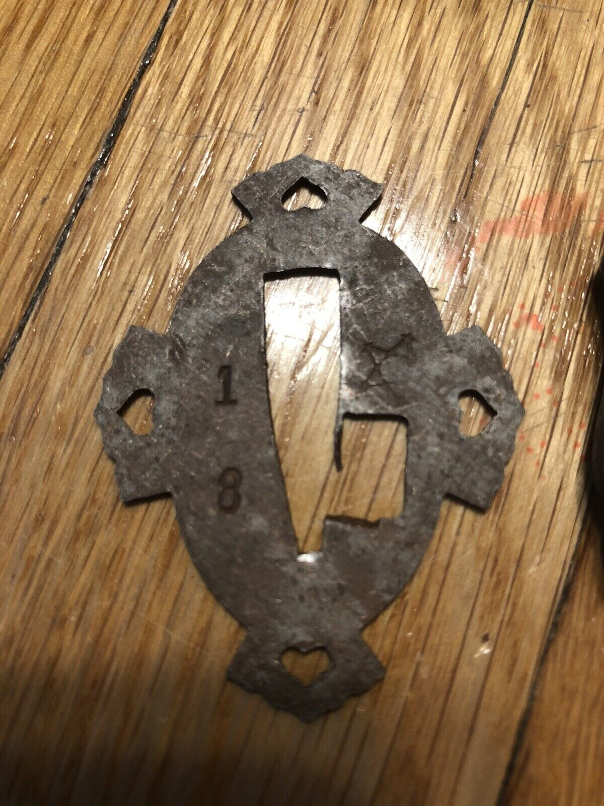

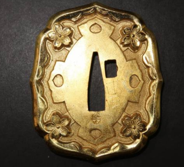

PNSSHOGUN Posted July 19, 2022 Report Posted July 19, 2022 An unusual stamp on the seppa found HERE. They are all mismatched but the Tsuba is a early Type 94 example with two screws to hold the fittings together. 2 1 Quote
Bruce Pennington Posted July 19, 2022 Report Posted July 19, 2022 Great one John! It's posted in the Stamps Doc, now! Quote

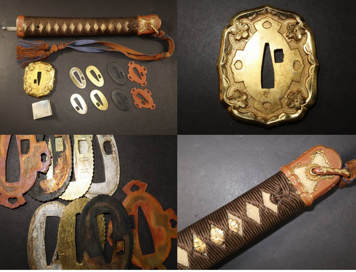

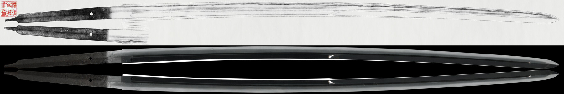

MarcoUdin Posted July 22, 2022 Report Posted July 22, 2022 https://www.aoijapan.com/katanashoju-kanemasakogarasumaru-shape/ A numbered blade for Bruce, in an unfamiliar Kyu koshirae to my knowledge 1 1 Quote
Bruce Pennington Posted July 22, 2022 Report Posted July 22, 2022 On 7/22/2022 at 4:48 PM, MarcoUdin said: A numbered blade for Bruce, in an unfamiliar Kyu koshirae to my knowledge Expand Thanks Marco! That is definitely unusual koshirae. Blade is legit, but I wonder about the fittings. Yet, there was admittedly quite a lot of variation in those swords. Pics added in case the link above goes dead in the future. Quote

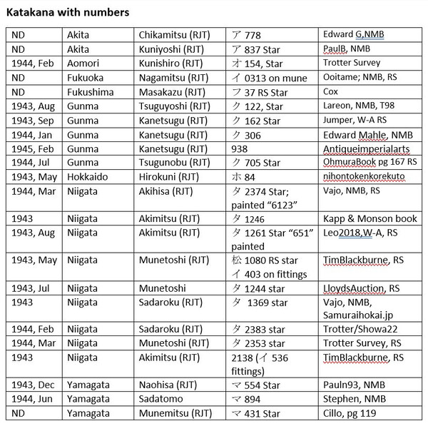

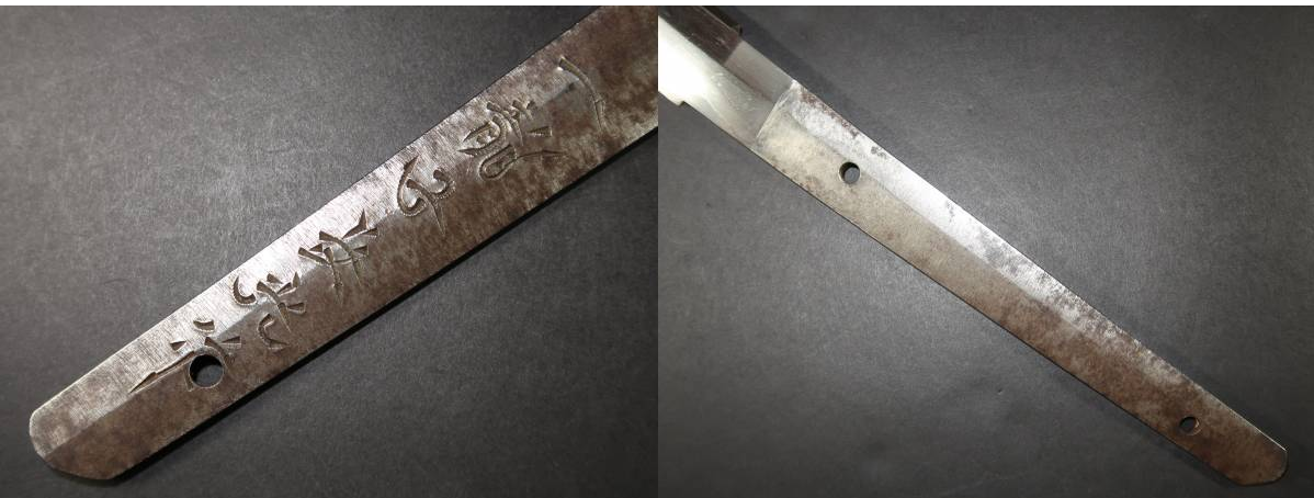

Ooitame Posted July 24, 2022 Report Posted July 24, 2022 Hi Bruce, not to bring up an old item. However, I see you posted Saka stamps for reference. Regarding Nagamitsu and the katakana for ichi, I do wonder if this was an indication the sword was made by him. Kind of like the two stroke Naga vs other mei. As we can can assume he had others making blades given the number produced and the varying signatures. I also say this as after a polish, this Nagamitsu Saku, mune saka ichi 0313, has some of the best hada (see my name lol) and interesting hamon activity for RS I have seen. In addition the ichi kata seems rather rare. For reference: 1 Quote
Bruce Pennington Posted July 25, 2022 Report Posted July 25, 2022 On 7/24/2022 at 4:10 PM, Ooitame said: the ichi kata seems rather rare. Expand Eric, It is rare. I have only 3 with the kana + number. All 3 have different mei, even! Your theory could be correct, but no way to know. After going through my files, I found 2 blades with an "一 (ichi)" as part of the mei, numbers 143 and 695, but 695 doesn't use the kana. Here are the Nagamitsu I have on file, all are undated: Number Mei イ143 Ichi Naga mitsu saku イ313 Naga mitsu saku 695 Ichi Naga mitsu saku 1431 Naga mitsu saku 1867 Naga mitsu saku 2005 [8 kanji mei] イ2511 [8 kanji mei] 3490 Naga mitsu saku 3973 Naga mitsu saku 3991 Naga mitsu saku So, the 3 blades with kana + number have 3 different mei styles. Don't know what to make of it. 1 Quote
Ooitame Posted July 25, 2022 Report Posted July 25, 2022 Bruce, I am still unsure myself just trying to figure it out. I don't think like mantetsu it was month/poem. Maybe just the pick of the litter? Quote
Bruce Pennington Posted July 26, 2022 Report Posted July 26, 2022 On 7/25/2022 at 6:17 PM, Ooitame said: still unsure myself Expand Ok, sorry it took me so long to remember this, but I have been tracking blades with katakana + number, and they seem to be tied to the prefecture of the smith. In some cases, we have more than one smith from the same prefecture with the same kana, which confirms the theory. In the case of Nagamitsu, we don't have another smith's blade with the mark as confirmation, but it fits the same pattern as the others. Part of the mystery is that some of his blades are numbered without kana. So still a mystery, but I believe it is a prefecture designation. Maybe an Army inspector stationed in that prefecture, in this case Fukuoka, used this kana. Quote

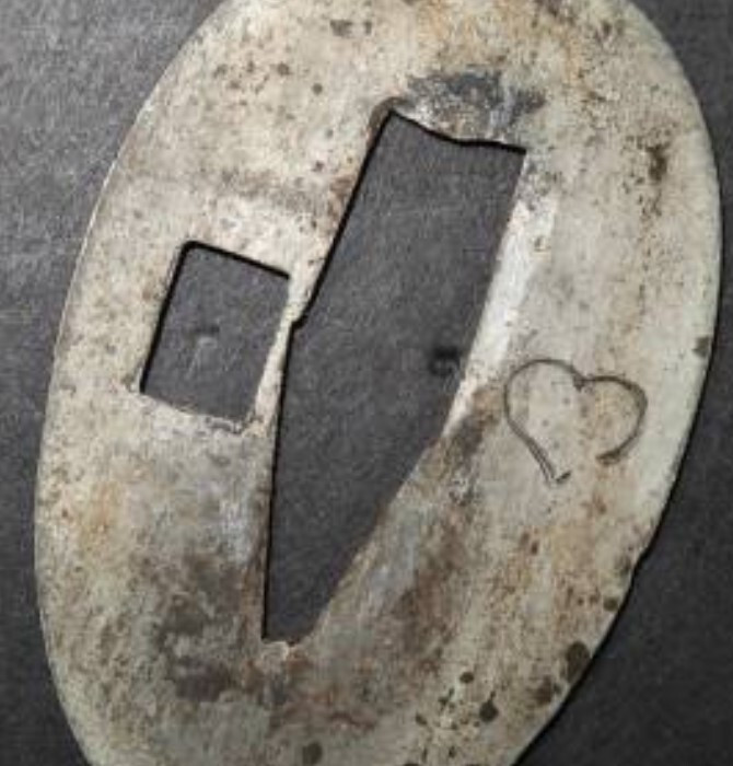

PNSSHOGUN Posted July 26, 2022 Report Posted July 26, 2022 Another long Mei Nagamitsu: https://page.auctions.yahoo.co.jp/jp/auction/e1058662094 Quote
Bruce Pennington Posted July 26, 2022 Report Posted July 26, 2022 On 7/26/2022 at 5:22 AM, PNSSHOGUN said: Another long Mei Nagamitsu Expand I have always wondered why sword sellers don't post photos of the nakago. Very frustrating. 1 Quote
PNSSHOGUN Posted July 26, 2022 Report Posted July 26, 2022 Bruce, there are additional photos if you scroll down. 1 Quote
Bruce Pennington Posted July 26, 2022 Report Posted July 26, 2022 Hmmm. 6 kanji mei, leaves off the 2 kanji above the "ichi". I'll take these over to Translations for clarification. His name was Ichihara Ichiryushu Nagamitsu, so I suspect the 6 kanji mei left off one of the names. Also Interesting is the open heart, or open boar's eye stamp on the seppa. I have one of these on record, and in the Stamps Doc, but cannot find the original. I think I got it from one of Neil's @IJASWORDS gunto. Neil, do you recall this one, and if so, which sword was it mounted on? Was it your Nagamitsu? Quote
Ooitame Posted July 26, 2022 Report Posted July 26, 2022 Hi Bruce, I have considered an inspector stamp as a possibilty. However would the stamp not be a arsenal, unit, or star stamp. Also I believe Nagamitsu worked from Osaka; not sure if it falls under the Fukuoka prefecture. P.S. I saw a document sometime back for inspection marks and noticed the ichi kana. Might be worth a dig. Quote
Bruce Pennington Posted July 27, 2022 Report Posted July 27, 2022 On 7/26/2022 at 10:06 PM, Ooitame said: Nagamitsu worked from Osaka Expand Ahem.... I just got an education! Re-read Slough's pages on Nagamitsu - both of them! Seems there was an RJT qualified ENDO Nagamitsu working from Fukuoka. He used a variety of mei, including a 2 kanji. But the other guy was Ichihara Ichiryushi Nagamitsu who worked from Osaka, and used quite a variety of mei. Since we have a 'イ' stamped blade with the Ichihara mei, we can assume all 3 of them were by Ichihara, and therefore, the mark is an Osaka mark, not Fukuoka (not to mention the fact that both the 143 and 2511 blades also have the Saka stamp!!!). I'll make the change to the Stamps Doc. 1 1 Quote
