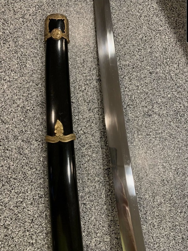

  On 1/22/2022 at 6:35 PM, Kiipu said:
 If possible, have the owner look for a 江 on the nakago mune.  Keep us informed of the results of your investigation.
Expand
Thomas
I got more photos of that sword, It has 江 Mark indeed. It's in the Kai gunto mount.

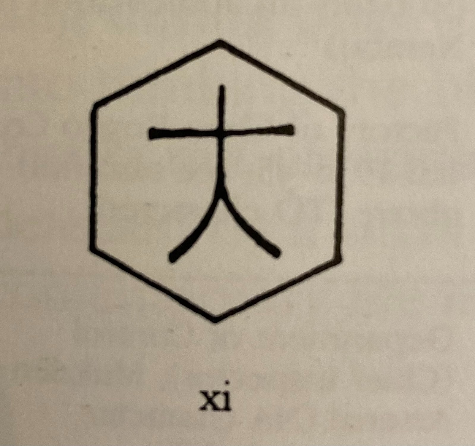

  On 1/22/2022 at 6:15 PM, BANGBANGSAN said:
@Kiipu
Thomas
Do you think the mark on the blade is  the same mark as the 大 Mark?It says on Fullers Page 226, Dai(or Tai) stamp. Significance unknown.Has only been found on blades dated 1945. Very rare.
Expand
I think this 大 mark is Izumo Taisha (Izumo Grand Shrine/出雲大社) 。Hence:Slough's book, page 82: Tai stamp appears on late war blades made by smiths associated with the Izumo Seiko steel works. Located in Shimane. The forge was located near the Izumo Taisha shrine and by 1945 the country was in dire need of divine assistance.
@Bruce Pennington@Kiipu
  • Love 1

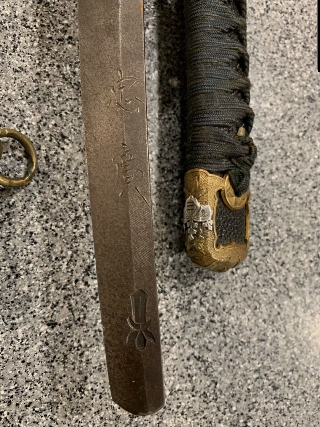

Here's an interesting hot stamp ww2 blade signed Tadahiro in kai gunto mounts with a family mon.  Not sure what the hot stamp means.
Expand
Pulling this one up from the past as a good friend has just sent me a very similar one, but it's on a Kumazuma Kanetoshi blade!  Slightly different as this one is surrounded by a "gourd" shape.  @mecox @george trotter or anyone else know if these two smiths worked for the same forge at some point?  @PNSSHOGUN, John, earlier, commented that the image might have Buddhist significance.  Anyone know?  It might explain why the same image is on blades by different smiths.  Maybe it's not a kao, but simply a religious symbol/meaning?
Bruce, in Sesko is :  KANETOSHI (兼俊), Shōwa (昭和, 1926-1989), Gifu – “Kanetoshi” (兼俊), “Ikkōsai Kanetoshi” (粋光斎兼俊), real name Kumazawa Shun´ichi (熊沢俊一), born April 20th 1899 (Meiji 32), his  gō was  Ikkōsai (粋光斎), he worked as guntō smith and was from Seki-machi, Kifune-cho.  He registered as a Seki tosho 21 October 1942.  The kakihan stamp does have Buddhist association.  It is probably a stylised ken straight sword with a "handle", possibly called a sanko-tsuki-ken or sanko-zuka-ken.  The ken (or suken) can reflect the incarnation of the deity Fudo Myoo, and the "handle" appears to be a rendai, the lotus petals put beneath an image of the Buddha. This Buddhist symbol is to chase away the devil.  But I dont know anything about the smith, how he trained or his relation to Buddhism.  He produced quite a few blades, most with Sho/Sakura or Seki stamp, but some with no stamp, and did produce some gendaito.  He is also listed in Slough page 70 (which shows he is not Murayama Kanetoshi).

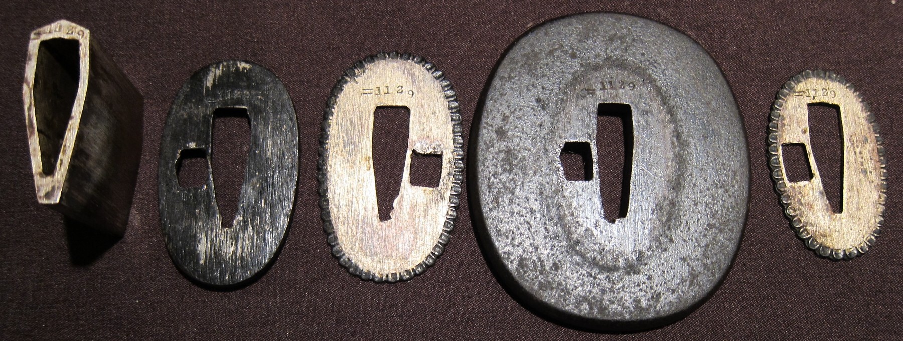

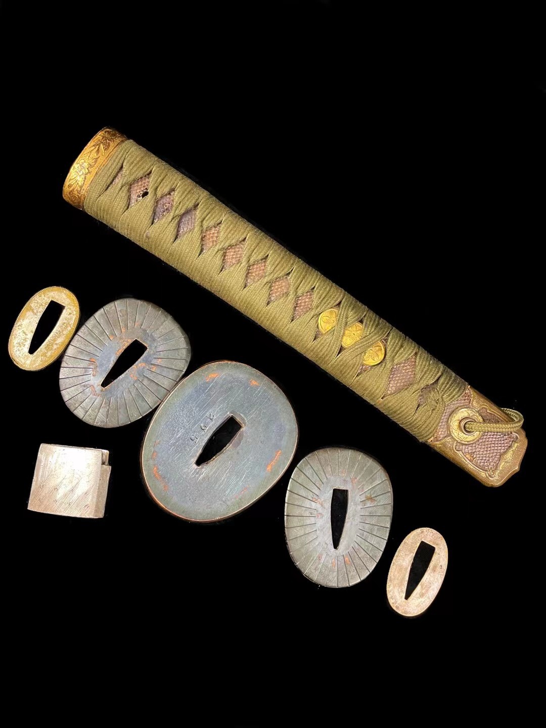

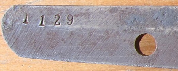

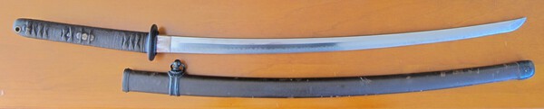

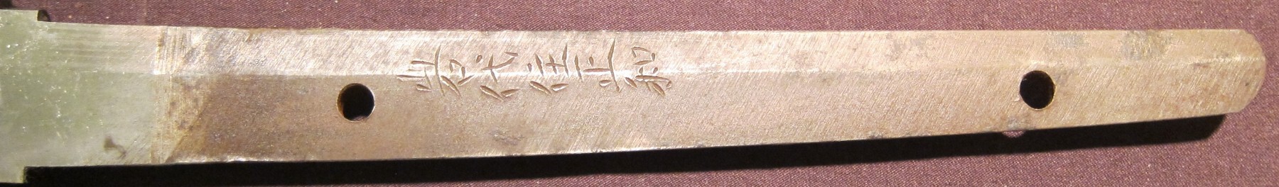

UPDATE ON FUKUSHIMA TANG, FITTINGS NUMBERS on
Tsukumasa Masakazu RS sword of 4/17 (no star).
He was one of about 11 RJT smiths/15 polishers etc  working in Koriyama City, Fukushima. They had a GUNTO KUMIAI (association) there, but I don't know if star/non star works were treated differently by the scheme or the  mounters/polishers.

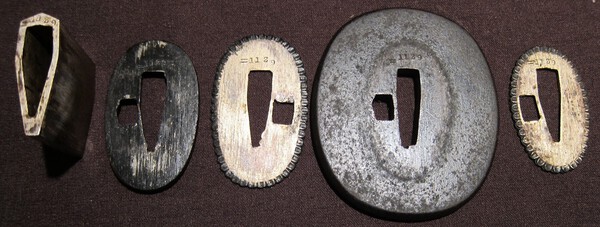

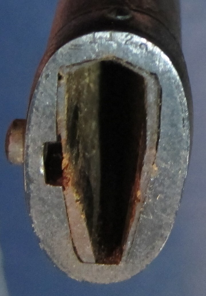

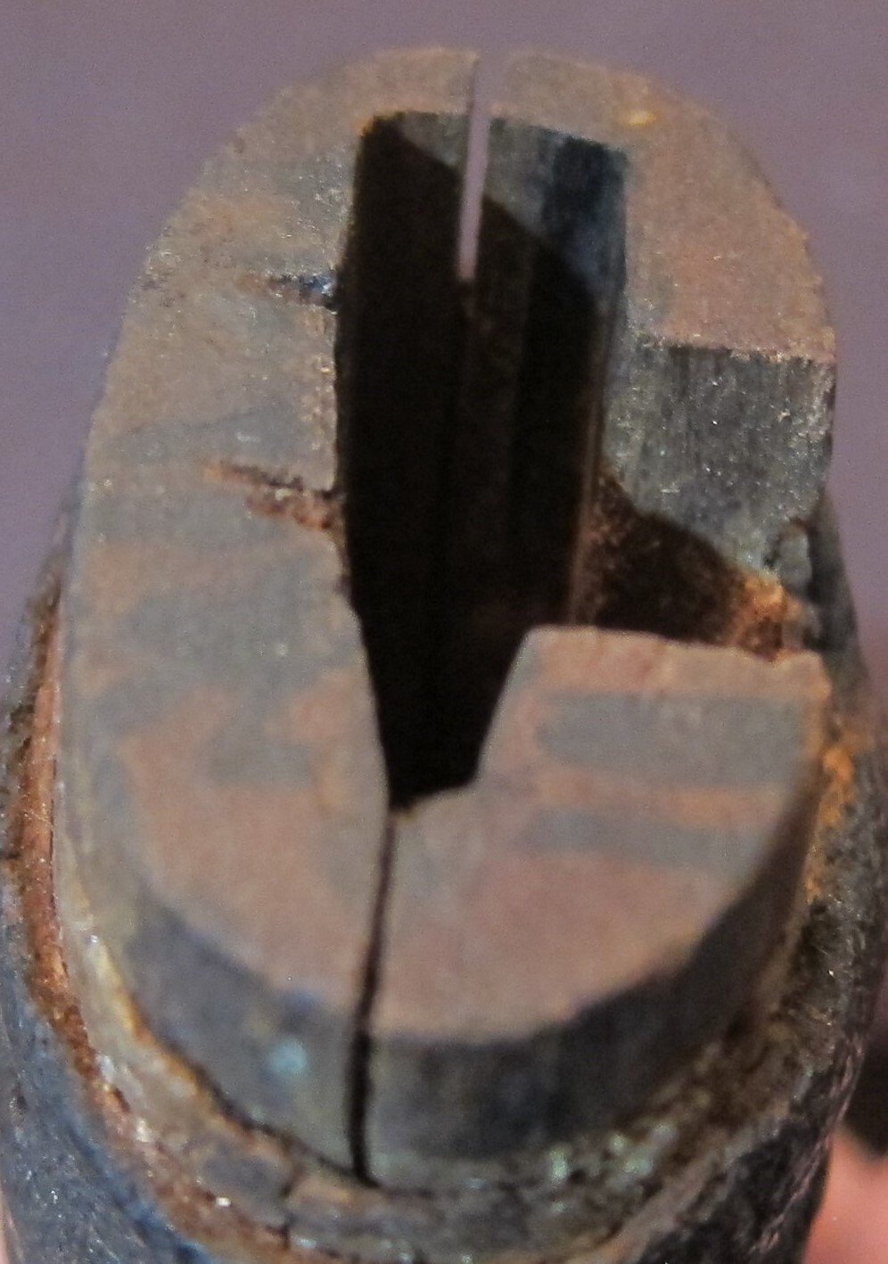

Bruce I finally remembered to take pics of ALL the parts on this sword that are numbered (I think I promised you). Pretty amazing that they numbered every part.
Tang is numbered 1129 - can't tell if it had a 'code' letter 'ni' in front as there is a patch of rust/pitting there (dang!)***.
Every part is numbered 'ni' 1129 , even the wood, but can't really read this properly. Maybe 'ni' will turn up again and show it is a location code?
Anyway, here for your files...hope it helps.
***PS I just gently cleaned the rust spot on the tang and it definitely looks like there is no "ni" mark before the number 1129....so, just on fittings.
Expand
Thanks Mal!  I'm going to change that one in my Stamps Doc.  I had it listed at the kao for Tadahiro, but I think it would be better listed in the Buddhist markings page, now that we have 2 unrelated smiths with the symbol.
Expand
George, thanks for checking on that.  Considering the date, Feb '42, I'm now not surprised there is no kana.  That early, the only kana/number blades are the Matsu on the Yamagami brothers.  I have a Masakazu marked "フ 37" with Star, in RS fittings, but no date.  It was likely made in '43 or '44.

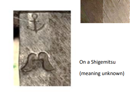

  On 1/6/2022 at 7:05 PM, Bruce Pennington said:
Another update on the Circled Anchor vs Anchor with no circle - Re-reading my Stamps of the Japanese Sword doc, pg 21, I realized one of the stamped blades had an anchor with no circle - @Kiipu = and an unknown stamp below.  As far as I know (for now) it is the only example I have on file:
Expand
@Bruce Pennington
Maybe that mustache is the city logo of Nagoya.
https://www.city.nagoya.jp/en/category/202-4-0-0-0-0-0-0-0-0.html
Ah, I see the mustache is back in the news again!  I thought Stegel identified that as being Bruce's logo?  More research needs to be done to find out just how old Bruce really is.
  • Haha 3

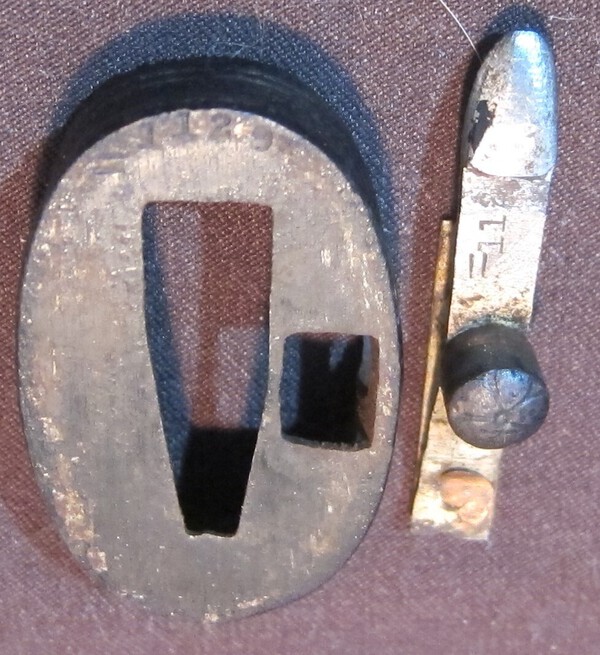

Bruce,
just referring back to my Feb 15 RS numbered parts photos of sword by Masakazu of Fukushima  Apr 1942 no star.
I said all parts were marked ni 1129 even the wood and showed a pic of it (but it was upside down and hard to read) - here it is right side up and you can see the wood is marked ni 1129 - but in kana and kanji (only part not numbered in romaji numbers). Reading R/side first NI, L/side top to bot: 1, 1, 11, 9.
Just in case you hadn't sorted this out yourself.
Regards....
