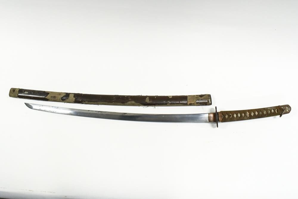

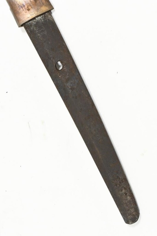

Bruce Pennington Posted December 29, 2021 Report Posted December 29, 2021 Peculiar. And possibly another shop label on the saya? Quote
Shuriken Posted December 29, 2021 Report Posted December 29, 2021 One more for you @Bruce Pennington 1 Quote
Bruce Pennington Posted December 30, 2021 Report Posted December 30, 2021 On 12/29/2021 at 11:16 PM, Shuriken said: One more Expand Thanks David! Yoshinao, No date, Showa Quote

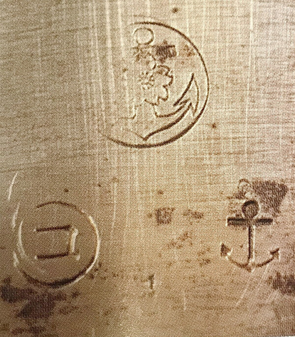

Bruce Pennington Posted January 6, 2022 Report Posted January 6, 2022 On 9/26/2021 at 7:00 AM, Stegel said: Here's a different encircled anchor which i don't think is here. It is found on training bayonets. I don't think the other anchor is the Toyokawa stamp Expand This was posted back in Sept '21, and I don't know why I thought it wasn't in Fuller's chart - it definitely is; but he was uncertain of it's exact meaning/pupose: "(xiii) Probably a naval inspection and/or acceptance stamp. Found on naval parade sabres and dagger guards. Possibly associated with the Toyokawa Naval Arsenal." Quote

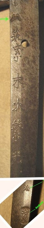

Bruce Pennington Posted January 6, 2022 Report Posted January 6, 2022 Another update on the Circled Anchor vs Anchor with no circle - Re-reading my Stamps of the Japanese Sword doc, pg 21, I realized one of the stamped blades had an anchor with no circle - @Kiipu = and an unknown stamp below. As far as I know (for now) it is the only example I have on file: Quote

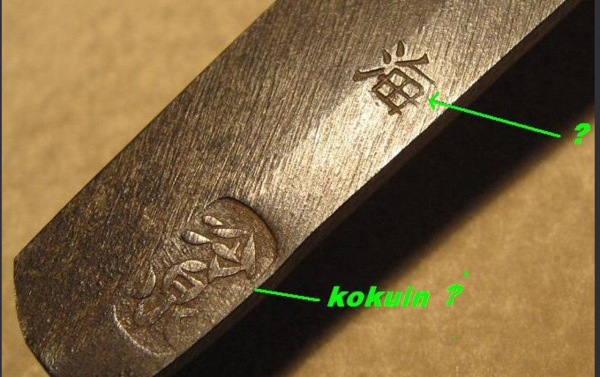

Kiipu Posted January 6, 2022 Report Posted January 6, 2022 Bruce, that is the only one I have recorded and it was reported by @Stephen back in 2006. I think this is an earlier Type 97 versus a later Type 97? The blade actually has two naval type markings on it. Obverse: Plain Anchor + mustache? logo + 筑紫末次繁光 [Tsukushi Suetsugu Shigemitsu]. Reverse: 海 = kai = maybe a shortened form of kaigun 海軍 [navy or naval]? Plus two more characters in an oval. Shigemitsu Thank goodness the moderator does not delete old posts! Just look at all the fun or trouble we have with them. 1 1 Quote

Kiipu Posted January 6, 2022 Report Posted January 6, 2022 In regards to the oval stamp on the Shigemitsu blade, I have found another blade that seems to have this as part of the inscription. Now I am wondering what this is all about. signature on broken sword Plus another oval stamp that is duplicated below via @george trotter. Naval sword translation Smith Mei 1 1 Quote
Bruce Pennington Posted January 6, 2022 Report Posted January 6, 2022 On 1/6/2022 at 10:19 PM, Kiipu said: Naval sword translation Expand That thread has the same kao for Shigemitsu as this one. This one is just way more clear! Quote
Bruce Pennington Posted January 6, 2022 Report Posted January 6, 2022 As to the anchor without circle @Kiipu, what are your thoughts? Do you think the uncircled one is actually Toyokawa's and the circled ones are Navy acceptance? Quote
Kiipu Posted January 7, 2022 Report Posted January 7, 2022 As of 1937, Shigemitsu live in Fukuoka City 福岡市, Fukuoka Prefecture 福岡県. His full name is Suetsugu Shigemitsu 末次・繁光 and he and his 7 apprentices could turn out five blades per month. The use of Tsukushi 筑紫 above his signature can mean one of two things. 筑紫国 Tsukushi Province was an ancient province now located within Fukuoka Prefecture 福岡県. Tsukushi-no-shima 筑紫島 "Island of Tsukushi" is another name used in the past for Kyūshū 九州. I am inclined to think Tsukushi 筑紫 in this context is referring to the old province and not the island. Does anyone have any thoughts that differ from this interpretation? A link to one of his blades made in August 1945. 福岡住末次繁光作 昭和二十年八月日 @mecox Another one for the naval swords monograph. Looks like number 264? 博多刀匠 末次繁光 2 Quote

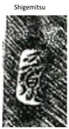

Bruce Pennington Posted January 7, 2022 Report Posted January 7, 2022 On 1/6/2022 at 8:31 PM, Kiipu said: Shigemitsu Expand I just have to post the whole nakago of this Shigemitsu @Stephen posted on the thread you linked. It is a "riddle wrapped in a mystery inside an enigma" to badly misuse a Churchill quote. All on one blade, the only known non-circled Toyokawa anchor, a moustache (or 2 birds kissing), a "Kai?", and a kokuin. A Stamp Guy's wet dream! Wish I had a complete nakago on it. I pieced this together from the linked thread. Quote

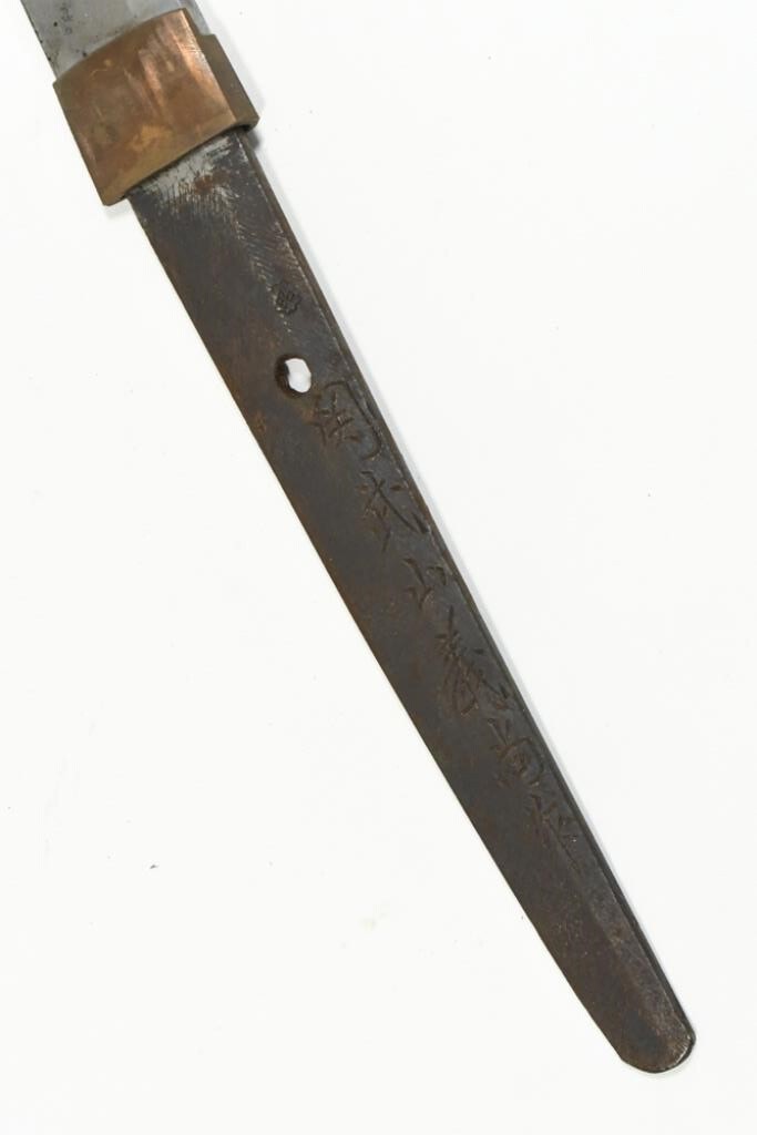

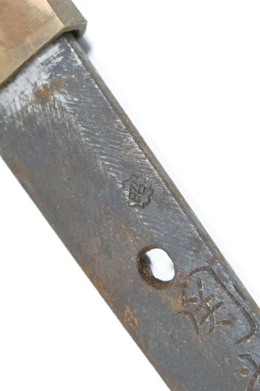

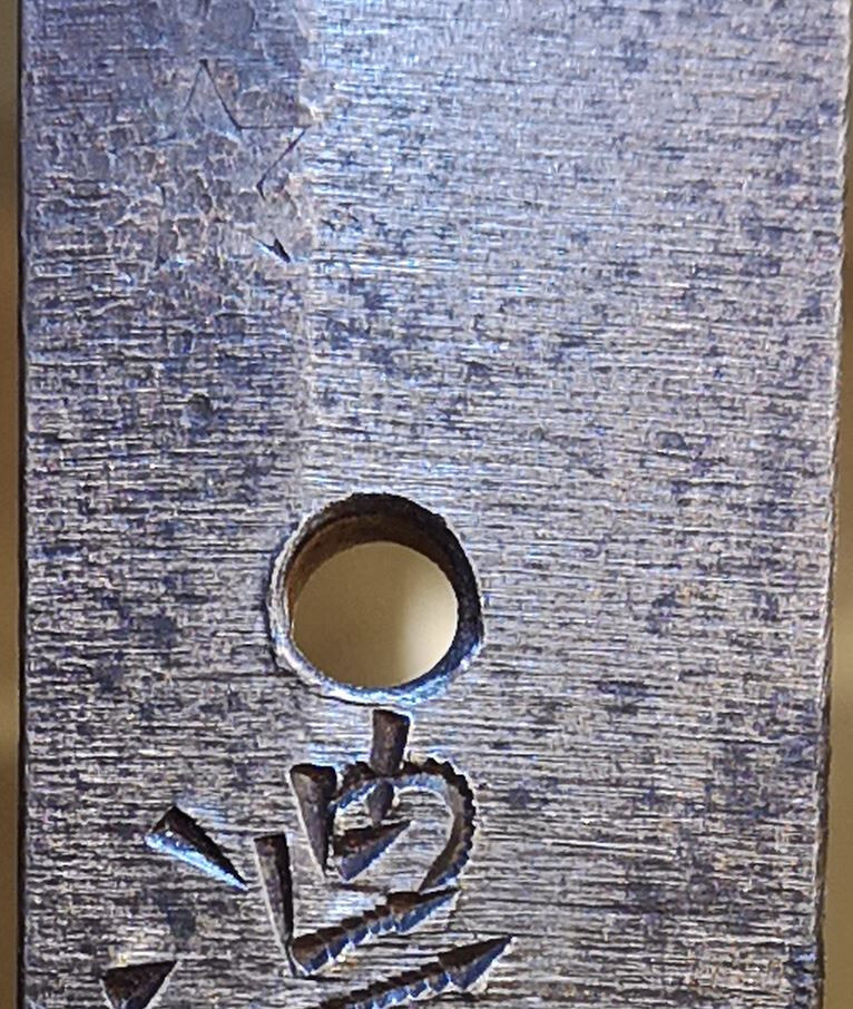

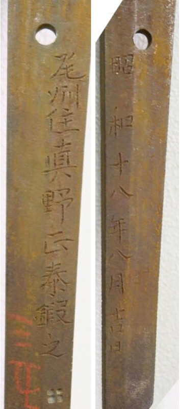

cisco-san Posted January 7, 2022 Report Posted January 7, 2022 Hello, I recently aqiured here on NMB (from a very nice member) a Noshu ju Kanehisa (dated March 1943) gendaito with star stamp (even somebody tried to hide them) and a Nagoya stamp. Additionaly it has a stamp (slightly above the Nagoya stamp), but here I am completely lost what is is... Any advise would be great. Many thanks in advance Klaus Quote
Kiipu Posted January 7, 2022 Report Posted January 7, 2022 On 1/6/2022 at 11:06 PM, Bruce Pennington said: As to the anchor without circle, what are your thoughts? Do you think the uncircled one is actually Toyokawa's and the circled ones are Navy acceptance? Expand Shigemitsu 繁光 delivered his blades to the Sasebo Naval District 佐世保鎮守府 so I doubt it relates to your statement above. This information is coming from the webpage that depicts his August 1945 dated blade that I linked to above. Quote
Kiipu Posted January 7, 2022 Report Posted January 7, 2022 On 1/7/2022 at 5:25 PM, cisco-san said: Additionally it has a stamp (slightly above the Nagoya stamp), but here I am completely lost what is is... Expand Klaus, the nakago mune just has two 名 inspection marks, one is just larger than the other. Nothing to fret about. 1 Quote
cisco-san Posted January 7, 2022 Report Posted January 7, 2022 On 1/7/2022 at 5:35 PM, Kiipu said: Klaus, the nakago mune just has two 名 inspection marks, one is just larger than the other. Nothing to fret about. Expand Many thanks Thomas, highly apprecitated!!! Quote

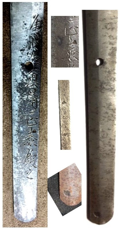

Bruce Pennington Posted January 19, 2022 Report Posted January 19, 2022 Wanted to post an update to 2 stamps previously in the 'unknown' category in the Stamps Doc. Thanks to @mecox's newest tome - Showa Swordsmiths of Aichi Prefecture, I can now tie them to specific smiths. The "diamond" stamp is found on the work of Kuniyasu: Mal uncovered 5 blades with this stamp, all Kuniyasu. One even has 2 diamond stamps: Of course, we still don't know the meaning or significance of them, but they seem to be specific to this smith, unless they show up someplace else in the future. The other is the "delta" stamp, or triangle. It's seen on Masayasu blades. Mal shows blades with 1, 2, 3, and 4 of them: I've been working on an update for the Stamps Doc and I'll be sure to include this new information. Thanks again to Mal Cox for the great work! 1 Quote
BANGBANGSAN Posted January 19, 2022 Report Posted January 19, 2022 On 1/19/2022 at 4:46 AM, Bruce Pennington said: Wanted to post an update to 2 stamps previously in the 'unknown' category in the Stamps Doc. Thanks to @mecox's newest tome - Showa Swordsmiths of Aichi Prefecture, I can now tie them to specific smiths. The "diamond" stamp is found on the work of Kuniyasu: Mal uncovered 5 blades with this stamp, all Kuniyasu. One even has 2 diamond stamps: I've been working on an update for the Stamps Doc and I'll be sure to include this new information. Thanks again to Mal Cox for the great work! Expand This Kanji should be 國泰 instead of 國奏 1 1 Quote

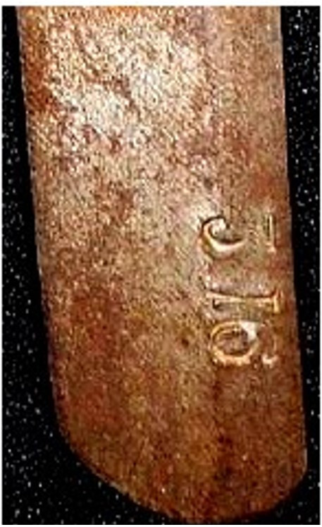

BANGBANGSAN Posted January 22, 2022 Report Posted January 22, 2022 @Kiipu Thomas Do you think the mark on the blade is the same mark as the 大 Mark?It says on Fullers Page 226, Dai(or Tai) stamp. Significance unknown.Has only been found on blades dated 1945. Very rare. Quote
Kiipu Posted January 22, 2022 Report Posted January 22, 2022 Trystan, I only have one on file and it was reported by @Brian. Below is the link so that you can compare it to the one above. If possible, have the owner look for a 江 on the nakago mune. Keep us informed of the results of your investigation. 隠岐國住沖光 = Oki kuni jū Okimitsu. 昭和二十年六月 = June 1945. Links Iwami Yoshikoyo Gendaito and Arsenal Stamps., Page #15 Quote
Bruce Pennington Posted January 23, 2022 Report Posted January 23, 2022 On 1/22/2022 at 6:35 PM, Kiipu said: Iwami Yoshikoyo Gendaito Expand Yoshikiyo (for future smith name searches! @BANGBANGSAN I've also noted this Tai stamp in the Stamps of the Japanese Sword doc. I have 4 smiths listed now: Okimitsu, Masakiyo, Masayoshi, and Yoshikiyo. I don't know my source for the 2 "Masa" smiths, but the 2 plus the Yoshikiyo looks like a mashup of names. Wondering now about the 2 Masa names. 1 Quote
