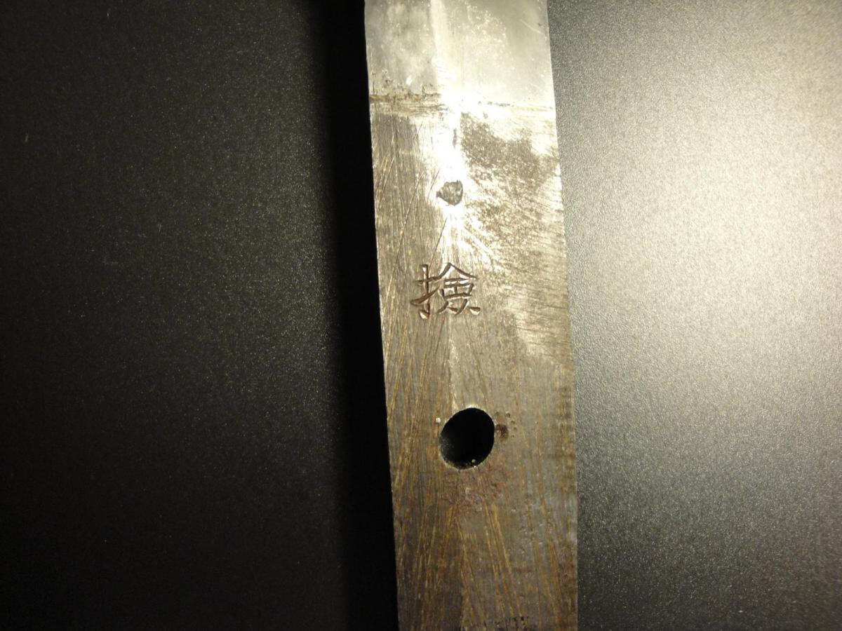

Kiipu Posted November 12, 2021 Report Share Posted November 12, 2021 On 11/1/2019 at 6:38 AM, Bruce Pennington said: A new one! And while this one is actually engraved, like mei, it says "Inspected." The WAF is off-limits to nonmembers. So, this leads to the following questions. What type of sword is this, army, navy, civilian? Do you have pictures of both sides of the tang? Are there any other inspection type marks on the tang? The kanji character that is depicted is 撿 which can mean several things. https://nihongomaster.com/Japanese/dictionary/kanji/7953/撿 Quote Link to comment Share on other sites More sharing options...
Bruce Pennington Posted November 13, 2021 Report Share Posted November 13, 2021 1 hour ago, Kiipu said: Do you have pictures Here's all the pics provided by the owner. No pics of the other side. It's the only example of the "stamp" observed so far. It's an Amahide blade. 1 1 Quote Link to comment Share on other sites More sharing options...

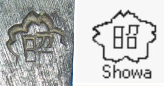

Shuriken Posted December 25, 2021 Report Share Posted December 25, 2021 This was posted way back on page 1, but I didn't see (or missed) discussion on it. Can someone shed light? Thank you! Quote Link to comment Share on other sites More sharing options...
Stephen Posted December 25, 2021 Report Share Posted December 25, 2021 Half struck showa stamp 1 Quote Link to comment Share on other sites More sharing options...
Bruce Pennington Posted December 26, 2021 Report Share Posted December 26, 2021 Right. some of the most challenging stamps are the ones that are partially struck. Quote Link to comment Share on other sites More sharing options...
Shuriken Posted December 26, 2021 Report Share Posted December 26, 2021 thank you @Bruce Pennington and @Stephen Quote Link to comment Share on other sites More sharing options...

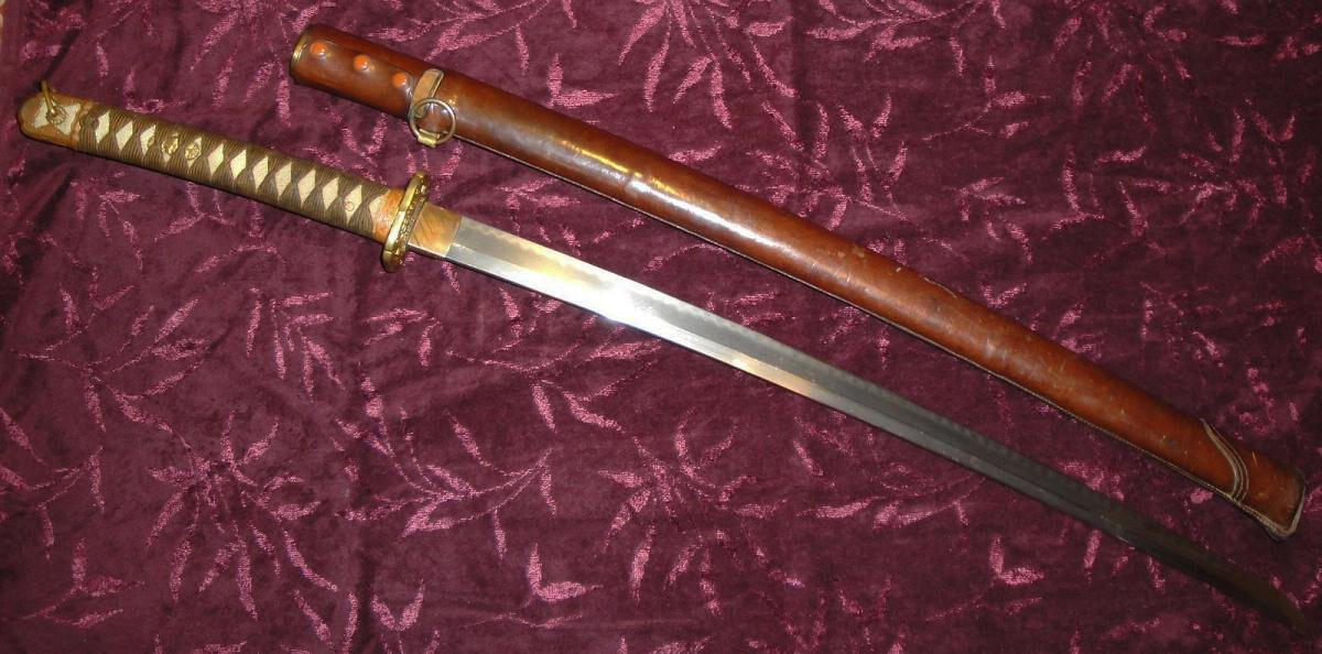

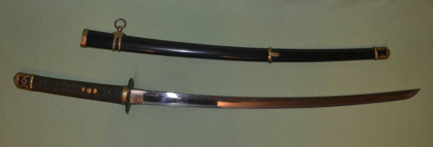

Shuriken Posted December 29, 2021 Report Share Posted December 29, 2021 Well, speak of the devil. @Bruce Pennington and @Stephen you may be interested in this. Showa stamp on a very nice looking blade with beautiful fittings. @Ray Singer can you shed light on the mei? Quote Link to comment Share on other sites More sharing options...

Bugyotsuji Posted December 29, 2021 Report Share Posted December 29, 2021 Seki Ju Kaneshige *(No, see below) 関住兼重 1 Quote Link to comment Share on other sites More sharing options...
Stephen Posted December 29, 2021 Report Share Posted December 29, 2021 Or is that Kanenao? http://www.japaneseswordindex.com/oshigata/kanenao3.jpg 1 Quote Link to comment Share on other sites More sharing options...
Shuriken Posted December 29, 2021 Report Share Posted December 29, 2021 @Bugyotsuji thank you. Forgive the question: the kanji in your post, are they meant to match the mei? Quote Link to comment Share on other sites More sharing options...
Bugyotsuji Posted December 29, 2021 Report Share Posted December 29, 2021 Just checking on the PC screen, and Stephen has what I am now seeing, Kanenao 兼直 (Scrub my post above!) Quote Link to comment Share on other sites More sharing options...
Bruce Pennington Posted December 29, 2021 Report Share Posted December 29, 2021 I'd go with Kanenao: http://japaneseswordindex.com/oshigata/kanenao3.jpg Quote Link to comment Share on other sites More sharing options...
Bruce Pennington Posted December 29, 2021 Report Share Posted December 29, 2021 And that's one heck'ov a hamon for a showato! Quote Link to comment Share on other sites More sharing options...

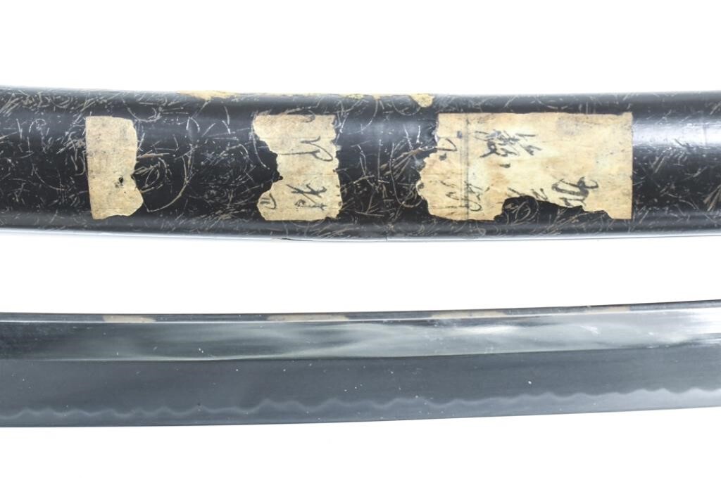

Bruce Pennington Posted December 29, 2021 Report Share Posted December 29, 2021 Can anyone elucidate on the blue painted kanji. Doesn't seem to be the normal numbering. Quote Link to comment Share on other sites More sharing options...
Shuriken Posted December 29, 2021 Report Share Posted December 29, 2021 2 minutes ago, Bugyotsuji said: Just checking on the PC screen, and Stephen has what I am now seeing, Kanenao 兼直 (Scrub my post above!) Let the record show I am ALWAYS grateful for your insights @Bugyotsuji and everyone here! 1 Quote Link to comment Share on other sites More sharing options...
SteveM Posted December 29, 2021 Report Share Posted December 29, 2021 10 hours ago, Bruce Pennington said: Can anyone elucidate on the blue painted kanji. Looks like it says 白 無号 (White. No number) 1 Quote Link to comment Share on other sites More sharing options...
