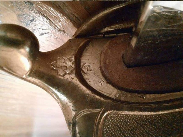

Bruce Pennington Posted September 24, 2021 Report Posted September 24, 2021 Got a collection going, now, of unknown stamps at the end of nakago. No idea of their meaning, or why they are there - forge/shop logo? smith kao? polisher logo? etc. Thought I would post the ones I have with the smith, when known. If you see one you own, or know where to find it, I'm trying to get the smith name of the blade they were found on. With that, I can do a search for each smith's blades to see if the mark recurs, or if they are one-off oddities. Thanks to anyone who can help ID these: on Kuniyasu on Masahiro Unknown smith Unknown smith unknown smith unknown smith unknown smith on Yoshinao blade on 1943 Yoshichika blade 1 Quote

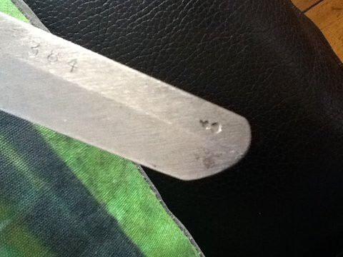

Corry Posted September 24, 2021 Report Posted September 24, 2021 Here is mine from Showato smith Yoshichika Type 98 : Rgds, Corry 1 Quote
Kiipu Posted September 24, 2021 Report Posted September 24, 2021 1 hour ago, Corry said: Here is mine from Showato smith Yoshichika Type 98. Most likely the number 六三. Check the fittings to see if they have a subassembly number that matches. 六三 = 63. 1 Quote

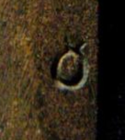

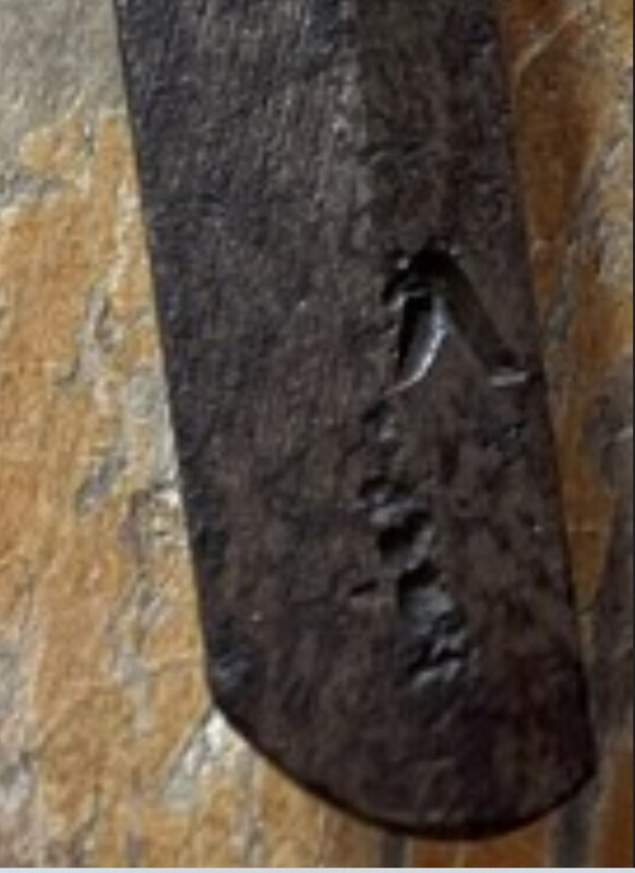

Corry Posted September 25, 2021 Report Posted September 25, 2021 Here is one off of a Type 3 two hole nakago: Quote
Stephen Posted September 25, 2021 Report Posted September 25, 2021 Corry Is that on the Kanekaga? Bit close would you pull back and show location on nakago please. Quote
Bruce Pennington Posted September 25, 2021 Report Posted September 25, 2021 3 hours ago, Corry said: one off of a Type 3 Durrell, that's a Gifu stamp. Found your photos of the mei and date (Kanekage, 1944). Thanks! 1 Quote

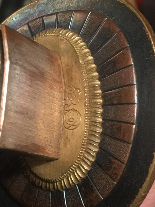

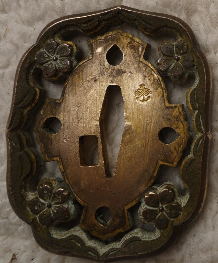

Bruce Pennington Posted October 8, 2021 Report Posted October 8, 2021 Gareth, The one on "top" is the Suya Shoten Company. Great write-up on them by Nick Komiay - The Untold Story of Suya Shoten. The bottom stamp - we used to say it was of the Toyokawa Navy Arsenal. Recent work by @Kiipu may be pointing toward a Naval Acceptance Stamp, similar to the Showa stamp for the Army. Your photo clearly eliminates any doubt as to it being a shop logo, as I have another guard with this anchor in sakura with another shop stamp. And on a seppa 1 1 Quote
BANGBANGSAN Posted October 8, 2021 Report Posted October 8, 2021 5 hours ago, Bruce Pennington said: Gareth, The one on "top" is the Suya Shoten Company. Great write-up on them by Nick Komiay - The Untold Story of Suya Shoten. The bottom stamp - we used to say it was of the Toyokawa Navy Arsenal. Recent work by @Kiipu may be pointing toward a Naval Acceptance Stamp, similar to the Showa stamp for the Army. Your photo clearly eliminates any doubt as to it being a shop logo, as I have another guard with this anchor in sakura with another shop stamp. And on a seppa The mark besides Naval Acceptance Stamp, One is from 中野商店,one is 松山由造‘s . 1 1 Quote
Kiipu Posted October 8, 2021 Report Posted October 8, 2021 It is not unusual to see two logos on naval swords regardless of age. What is unusual is that one of the logos is a constant, the cherry blossom with anchor inside. I have kicked around the idea that it could be the mark of a reseller and not that of a manufacturer. The reason for this is that the older army swords are marked just as often as the naval swords yet have only one logo or sometimes the same logo repeated twice, side by side. I have also seen the same company logos appear on both army and naval swords. Yet the naval swords have the additional cherry blossom & anchor logo. It really is a bit of a mystery. 3 Quote

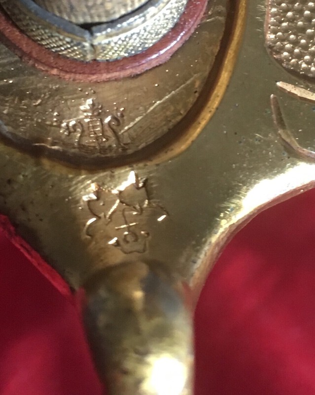

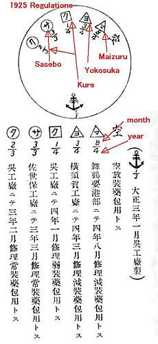

Bruce Pennington Posted October 21, 2021 Report Posted October 21, 2021 Think this is the same anchor as on this reg page? If so, what does the reg say about this anchor? ht Found by @Kiipu on this SFI thread. 2 Quote
Stegel Posted October 21, 2021 Report Posted October 21, 2021 That anchor is for the Kure Naval Arsenal Quote
PNSSHOGUN Posted October 21, 2021 Report Posted October 21, 2021 The mountings are Type 94 IMO, may help with date ranges. Quote
