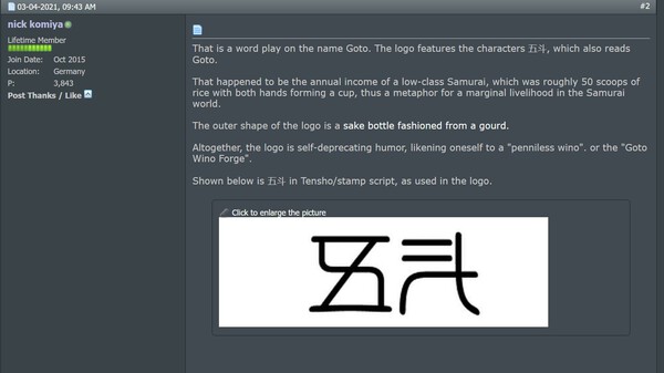

Bruce Pennington Posted March 5, 2021 Report Share Posted March 5, 2021 An update on the "5 measures" hotstamp identified by Richard Fuller, who said of the stamp: "(vii) ‘Five measures’ stamp. Literally Go (5)-To (measure of capacity. (1 To = 3.97 Imperial gallons). Significance unknown. Very rare." I ran into it going through the Cillo edition of Slough on a blade by Ogawa Tofuji 小川 外藤 . Knowing that some hotstamps can contain a kanji of the smith's name, I thought I'd run the item by @mecox and his lovely bride for an opinion. Mal's amazing research skills came through and uncovered the fact that Tofuji was a smith at the Goto Kaji-jo (Goto Sword Forging Centre) in Seki! Mal also pointed out that the stamp is in the shape of the old gourd sake bottles and the 2 kanji closely resemble a couple of sake volume terms: 1 gou 合 = 180 mL (0.1804 L) (a standard serve of sake) 1 shou 升 = 1804 mL (1.804 L) (1 shou = 10 gou) 1 to 斗 = 18040 mL (18.04 L) (1 to = 10 shou = 100 gou) He wondered if the image is a play on words between the Shop name and sake references. I then ran the whole discussion by Nick Komiya HERE at Warrelics, who agreed with Mal and added: Mal is looking for blades by Tofuji's teacher, who also worked at the shop, Koketsu Kanekami 纐纈 兼上, to see if he also used the stamp, but so far it seems that only Tofuji blades have the mark. It is quite possible that the stamp is a craftily made play on all the above, playing the shop name into a statement that he's getting paid like a low-class Samurai with 5 measures of sake! Quite brilliant! Mal has a brief article on the topic, that I've jumped the gun in quoting from. All of this info comes from his work and Nick's insight. Many thanks to both of them! I don't know how I'll amend this item in the Stamps Document. It practically will need a page of it's own! 3 Quote Link to comment Share on other sites More sharing options...

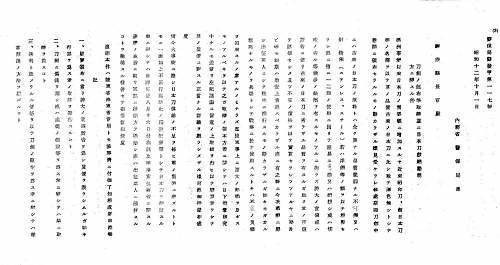

Bruce Pennington Posted March 29, 2021 Report Share Posted March 29, 2021 Another update on the background history: Nick's found an Police letter which addresses the concerns about gimei (mentioned by Keven Jones, Ryujin Swords) and poor quality showato (Seki City website) You can read his post (#36) HERE. Here is his post: Nihon-to 911 I earlier mentioned that Ohmura-san’s theory about the Ministry of the Interior imposing stamping on swords made by non-traditional methods was unfounded, as no such law was ever published in the government gazette. However, it is true that the Ministry of the Interior, responsible for policing was greatly concerned about the fraudulent manner in which “Showa-to” was being sold right after the China Incident of 1937. The following Police memo is from a police file containing all gun, sword and explosive control documents for the year 1938 and earlier. The APB memo is dated 1st October 1937, the entirety of which I translated below. It instructs prefectural police to crack down on certain fraudulent sales activities regarding Nihon-to, while they contemplate a more fundamental solution to the frauds occurring in the market. However, no further police documents got issued on this topic up to the end of 1938, which indicates to me that the fraudulent claims made to sell “Showa-to” ceased to be a police concern between October 1937 and December 1938. It is very likely that the police was agreeable to voluntary initiatives proposed by the cutlery industry to impose quality tests upon itself and stamp products with its seal of approval. It is also interesting to see that the police regarded the word “Showa-to” as a deceptive marketing gimmick in those days, equally misleading as the ridiculous term “Super Nihon-to”. I should also add that this was also accompanied by the leaflet I showed here calling for sword donations. Regarding policing of the sale of Japanese swords and encouraging citizen sword donations 1st Oct. 1937 Letter from the Chief of Police & Security Bureau of the Ministry of the Interior to the Police Chiefs of Prefectures. As the demand for Nihon-to has surged since the outbreak of the China Incident, recently, sales of swords claiming to be “Showa-to 昭和刀” or “Super Nihonto 超日本刀” have increased, promoting them as if they were comparable in quality to traditional Nihon-to. However, some such products are said to be of dubious quality, made of material totally different from traditional Nihon-to, out of such inferior material as stainless steel or western steel, which can easily bend or break only after being used a couple of times or poor in sharpness. These swords, despite such defects are being promoted and advertised in a way that mislead buyers into believing them to be equals of traditional Nihon-to, and at exorbitant prices. Such practices are harmful to social order and, in consideration of the fact that such defective products may end up in the hands of our soldiers called to the battlefield as a result of the Incident, they may even lead to casualties that become immeasurable military setbacks. Thus we are currently contemplating fundamental approaches to rectify this problem. In the meanwhile, we expect you to enforce order by focusing on the following three points, to prevent consumers from being deceived of the true nature and value of the products offered them. Additionally, as a means to offset the shortage of Nihon-to supply caused by this Incident and as a preemptive measure against the forgoing fraudulent sales practices, please call upon sword owners to encourage them to donate their swords to the military in the same manner as the 16th August memo regarding the transfer of pistols and live ammunition thereof. Lastly, please be aware that these points have already been discussed and agreed with the Army and Navy Ministries. 1. Crack down on those that engage in deceptive practices that misrepresent the true worth of the items being sold through exaggerated claims in promotions and advertising. 2. Crack down on those that apply Gimei to swords or provide false appraisals. 3. Inhibit attempted sales of swords at unjustifiably exorbitant prices . Police Letter.docx 1 Quote Link to comment Share on other sites More sharing options...

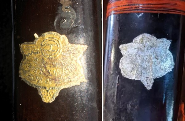

Bruce Pennington Posted March 29, 2021 Report Share Posted March 29, 2021 ANOTHER update! In discussing the foil labels: I realized the organization - Seki Cutlery Manufacturers Society - is the same organization mentioned in the Seki City website that was doing the showato testing and stamping! When and why they moved to foil labels rather than nakago stamps is unknown. I'm going to try to backtrack on these gunto to see if the blades were dated. If anyone reading this owns one like this, please post your nakago, especially if it's dated. Quote Link to comment Share on other sites More sharing options...
Bruce Pennington Posted March 30, 2021 Report Share Posted March 30, 2021 I did a survey at NMB and found 7 gunto with the blue sticker and 5 with the silver. None of the blue ones had dated blades, but they range in obvious fittings from high-quality kaigunto to low-end late-war army. A couple of the silver ones were on 1942 blades (one undated but with large Seki stamp; other dated Feb 1942). The rest were mumei or blades unknown. One was even found stuck right onto the outside of the leather saya cover. One had an old family blade in it. But 1942 is the earliest date found, which coincides with the Army takeover of the Seki logo. Maybe this was their initial response to losing the logo before adopting the Gifu? The one with the old blade makes me think the sticker was more of a "Final total package" approval, or even a koshirae inspection approval. Quote Link to comment Share on other sites More sharing options...
