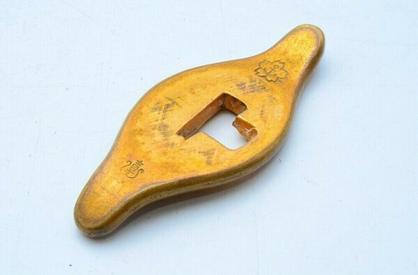

BANGBANGSAN Posted January 24, 2021 Report Posted January 24, 2021 I just saw this photo, noticed this mark on the Fuchi , don't think it is 家紋,what do you guys think? Is it mark mean to go through for the 駐爪 hole? Quote
Bruce Pennington Posted January 26, 2021 Report Posted January 26, 2021 On 1/24/2021 at 4:25 PM, BANGBANGSAN said: mark on the Fuchi Wow, that's a new one! Good catch! It's obviously manufactured into the design. So, I agree with you that it seems unlikely to be a kamon. Plus, I couldn't find a mon of this design. Similar ones have 2 horizontal lines, not 1. There's a Tsunemitsu shop that has an emblem very similar, but the line doesn't go all the way across: A real mystery. I like your idea about it marking where they want the chuso button. In English, we say "X marks the spot". Do you know if the Japanese have a symbol they use for "marking the spot?" Quote
Kiipu Posted January 26, 2021 Report Posted January 26, 2021 On 1/24/2021 at 3:25 PM, BANGBANGSAN said: I just saw this photo, noticed this mark on the fuchi, don't think it is 家紋, what do you guys think? Is it mark mean to go through for the 駐爪 hole? An interesting find and a sharp eye to boot. Do you have any other information on the sword, such as a mei or date? It looks to be army judging by the fittings. Quote
BANGBANGSAN Posted January 26, 2021 Report Posted January 26, 2021 3 hours ago, Kiipu said: An interesting find and a sharp eye to boot. Do you have any other information on the sword, such as a mei or date? It looks to be army judging by the fittings. I only have one photo of this sword, it should be Type 98.I will try and see if I can get more information. Quote

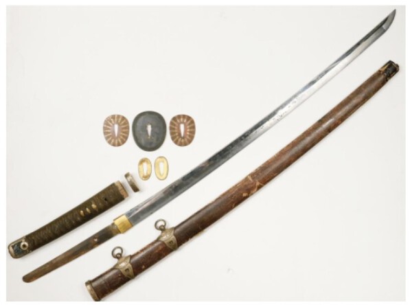

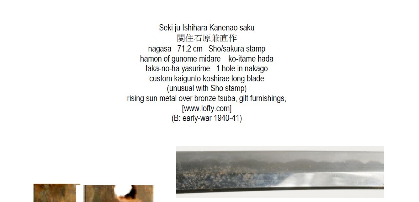

Bruce Pennington Posted January 27, 2021 Report Posted January 27, 2021 Once again, I'm reminded of the axiom "When it comes to gunto, never say 'never' and never say 'always'"! Reading Mal Cox' excellent article on "Seki Swordsmiths and Japanese Naval Swords", I came across this Kaigunto - Navy - gunto - with a Showa-stamped Kanenao blade. All sources up to now have always (ooh, there's that word!) said that Showa stamps are "ONLY" found on Army blades. And I've repeated that in the Stamps Doc. Well, I guess that is going to be changed to "predominantly" found on Army blades! The change will be in 7.4 when it comes out. Quote
BANGBANGSAN Posted January 27, 2021 Report Posted January 27, 2021 4 hours ago, Bruce Pennington said: Once again, I'm reminded of the axiom "When it comes to gunto, never say 'never' and never say 'always'"! Reading Mal Cox' excellent article on "Seki Swordsmiths and Japanese Naval Swords", I came across this Kaigunto - Navy - gunto - with a Showa-stamped Kanenao blade. All sources up to now have always (ooh, there's that word!) said that Showa stamps are "ONLY" found on Army blades. And I've repeated that in the Stamps Doc. Well, I guess that is going to be changed to "predominantly" found on Army blades! The change will be in 7.4 when it comes out. Yes that is a Showa stamp on the Kai Gunto, unless it's remount.Never say never to Gunto. Quote
Bruce Pennington Posted January 29, 2021 Report Posted January 29, 2021 I was also interested to read, in Mal's Seki/Navy article, that the Navy stamping doesn't seem to be present on their blades until 1942. I'll have to add that to my Stamps Survey. It brings up the question of "why not?" Did the Navy just thumb their noses at the law which required stamps on non-traditionally made blades, which started around 1938 (or sooner)? Does this indicate that the "law" wasn't a law at all, but an Army Regulation? I wish we had documentation about the stamping "law." This observation by Mal, that the Navy blade stamping began in 1942 coincides with the Army's assumption of control over ALL sword production at that same time. Quote
mecox Posted January 29, 2021 Report Posted January 29, 2021 5 hours ago, Bruce Pennington said: I was also interested to read, in Mal's Seki/Navy article, that the Navy stamping doesn't seem to be present on their blades until 1942. I'll have to add that to my Stamps Survey. It brings up the question of "why not?" Did the Navy just thumb their noses at the law which required stamps on non-traditionally made blades, which started around 1938 (or sooner)? Does this indicate that the "law" wasn't a law at all, but an Army Regulation? I wish we had documentation about the stamping "law." This observation by Mal, that the Navy blade stamping began in 1942 coincides with the Army's assumption of control over ALL sword production at that same time. Bruce, careful please I dont think I made that definitive statement. I did say "indicated' after 1940, and its referring to navy establishments and some later blades dont have it. BTW this is a compilation, it ain't the Bible. Quote
Bruce Pennington Posted January 30, 2021 Report Posted January 30, 2021 4 hours ago, mecox said: this is a compilation, it ain't the Bible. Fair enough Mal. I get excited sometimes and run my mouth before I dig into the facts! I'll start tracking the Navy stamps and see what develops. I think it's going to be a tougher study, though, as there are less Navy blades to tabulate and my rough impression of them is that more so than Army, they aren't dated very often. 1 1 Quote

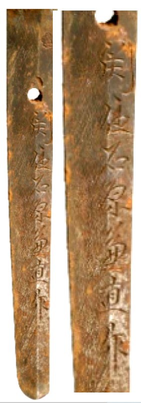

gustaf Posted February 16, 2021 Report Posted February 16, 2021 I was offered today this blade. It’s a true and verified bring back. Very interesting stamp that was already discussed here. Any thoughts on the added value of the stamp on otherwise ordinary showato? Quote
Bruce Pennington Posted February 24, 2021 Report Posted February 24, 2021 On 2/15/2021 at 5:05 PM, gustaf said: added value Carl, Sorry for not responding very quickly! I have read (don't remember where) that the stamp does indicate that the blade is made of tamahagane, and therefore could be traditionally made. So that can add value to a gunto for guys who want a gendaito. Quote

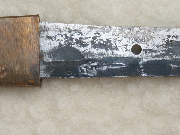

Bruce Pennington Posted February 24, 2021 Report Posted February 24, 2021 This is a new one, brought to my attention by @mecox and found on a Shigemitsu blade. NO idea what it's significance is. Kissing ducks? Big mustache? It's the forth blade found, now, with the Toyokawa anchor with another stamp underneath. It's not a kao, because Shigemitsu has a distinct kao, and they are placed at the end of the nakago, not at the top like this. Mal also notice (got by me at first!) that the anchor has no circle! Looking closely, I believe the anchor was hand-made, not a stamp like the norm. No idea of the significance of that, either, if any. (photo not of Shigemitsu, but simply for comparison) Quote
Kiipu Posted February 26, 2021 Report Posted February 26, 2021 (edited) On 1/24/2021 at 3:25 PM, BANGBANGSAN said: I just saw this photo, noticed this mark on the fuchi, don't think it is 家紋, what do you guys think? Is it mark mean to go through for the 駐爪 hole? 家紋 = kamon = family crest. 駐爪 = scabbard release button. BangBangSan, I have no idea what it is or what it is for but here is a link to another. Smallest mon? Edited February 26, 2021 by Kiipu Quote
BANGBANGSAN Posted February 26, 2021 Report Posted February 26, 2021 3 hours ago, Kiipu said: 家紋 = kamon = family crest. 駐爪 = scabbard release button. BangBangSan, I have no idea what it is or what it is for but here is a link to another. Smallest mon? I know what 駐爪 is.I was trying to say if that is "X marks for the 駐爪". That 80's photo George post looks like the same mark on the Fuchi I post. 2 Quote
BANGBANGSAN Posted February 28, 2021 Report Posted February 28, 2021 Got photo of other side handle of this sword ,it has 駐爪 already. So, what do you guys think this mark is?If not it's not "X marks for the 駐爪". 1 Quote
Bruce Pennington Posted February 28, 2021 Report Posted February 28, 2021 "Whoa Nelly!" Got a whole 'nuther ball game now. The mon experts haven't come up with anything on this, so my inclination is to think it's a shop logo. Hope we can find more. I'm posting the one @george trotter posted and @Kiipu posted the link to: Quote
