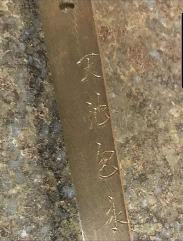

waljamada Posted April 28, 2020 Report Posted April 28, 2020 Whats this stamp? A swordsmith's stamp? Quote
waljamada Posted April 30, 2020 Report Posted April 30, 2020 BangBang. Oh, seems a mundane stamp. Thought it might be a bit more special. That blades in rough shape but in the silver gunto mounts that another discussion has been talking about. Quote
PNSSHOGUN Posted April 30, 2020 Report Posted April 30, 2020 Tan stamp, means it's traditionally forged from memory. 1 Quote
Bruce Pennington Posted May 1, 2020 Report Posted May 1, 2020 Both Trystan and John are correct. Fuller says of it: " ‘Tan’ or ‘Kitau’ stamp. Literally ‘to forge’ or ‘forged’. Very scarce." Don't know any more about it than that, though. Quote

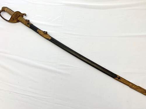

Bruce Pennington Posted September 11, 2020 Report Posted September 11, 2020 Forgive me if this stamp has already been posted, but a guy over on Warrelics has a nice navy dress saber with the "N in Diamond" stamp. Richard Fuller says it's been seen on navy dirks, but didn't know it's source. If someone has any insight on this, I'd appreciate it! found HERE Quote

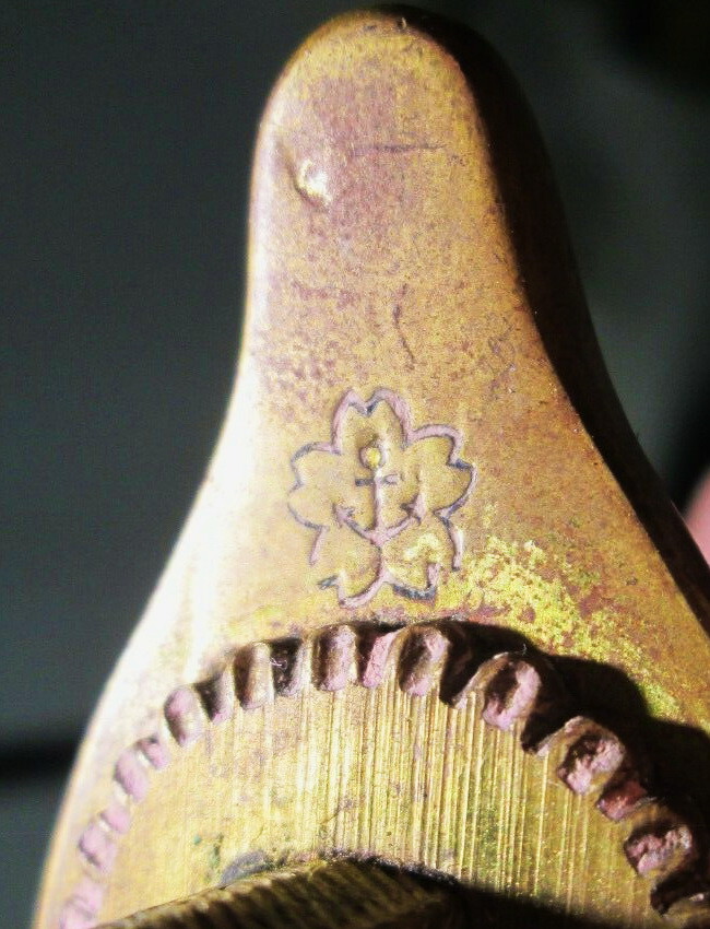

Stegel Posted September 16, 2020 Report Posted September 16, 2020 Here's one i came across just recently on a Navy dirk. Adding it here as i don't remember seeing it in this thread before. Toyokawa Naval Arsenal Stamp 1 Quote
Bruce Pennington Posted September 16, 2020 Report Posted September 16, 2020 11 hours ago, Stegel said: Here's one i came across just recently on a Navy dirk. That's a great example, Ernie! Fuller says that style stamp is found on dirks, but I had never seen an example. I have seen a couple on seppa, but that's my first dirk. Thanks! Quote

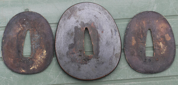

davidequis Posted September 19, 2020 Report Posted September 19, 2020 On 7/25/2010 at 3:28 AM, Ted Tenold said: Here is an example of the very curious "Matsu" stamp. It is a very rarely encountered mark, and its origin and purpose seems to be unknown. The pictured gendaito with this mark is a very nicely hand forged work by Munetoshi, who also signed Hidemune. He was a student of Kasama Shigetsugu. Other oshigata I have seen did not display this "matsu" mark, so it is inconsistently found on his works. My speculation is that this is an identifying mark for a particular shop or broker who may have ordered the blade on behalf of an officer. The mark is documented in Military Swords of Japan 1868-1945 by Richard Fuller and Ron Gregory. It is noted in this book that blades found with this mark were mounted in late 1944 Shingunto koshirae. This blade is indeed mounted consistantly. Another Munetoshi, October, 1942. carries the same matsu stamp. In addition, all fittings carry the same number as pictured. A final point of interest, there appears to be a set of marks that the experts may recognise (circled on pic) - probably originally ink or paint. Quote
