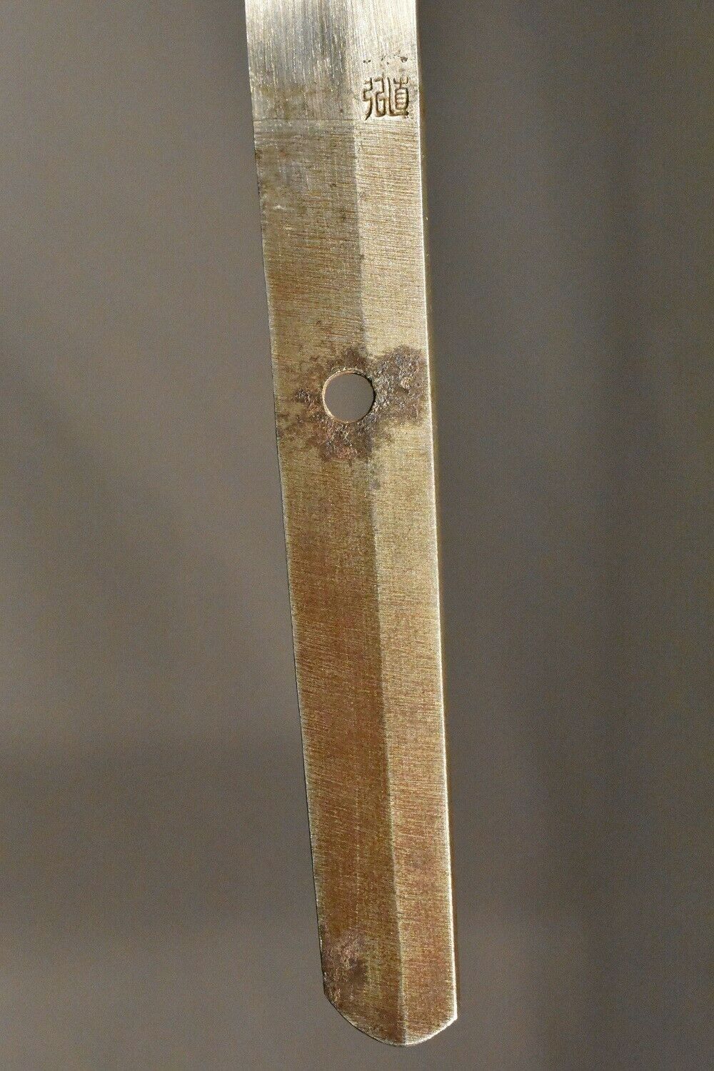

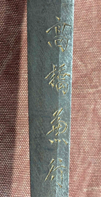

Kiipu Posted October 28, 2019 Report Posted October 28, 2019 (edited) On 10/28/2019 at 10:19 AM, BANGBANGSAN said: I rotate the second marke, it kind of look like 弘道 ,but I'm not very certain.There is a Showa smith name 丹羽弘道 Niwa Hiromichi though。 Or,from right to left could be 直弘,one Showa smith name 柳川直弘 Yanagawa Naohiro... let's see what Thomas think about this mark. Looks like this stamp is all sorted out now. As regards the first character, it appears to be another one of those old characters. A real stinker trying to get them to display properly too. If you cut and paste it, the character frequently defaults to the new one! Hopefully everyone can see it below but if not follow the link. 直 = 直 https://en.wiktionary.org/wiki/直 Edited October 28, 2019 by Thomas 1 Quote

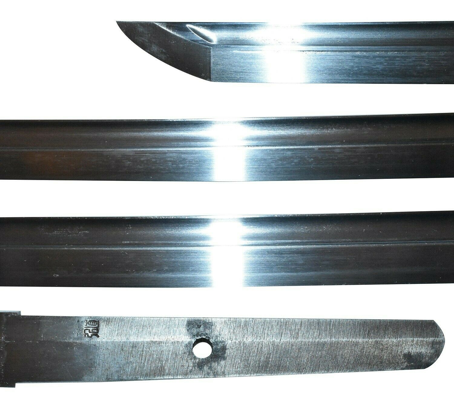

PNSSHOGUN Posted November 5, 2019 Report Posted November 5, 2019 Another sword with the Naohiro stamp: https://www.ebay.com/itm/MINTY-WWII-Japanese-Samurai-Sword-KYU-GUNTO-Shin-Gunto-KATANA-World-War-2/223736355853?hash=item3417b9dc0d:g:fyMAAOSwDMtdrRAC 1 Quote

Kiipu Posted November 9, 2019 Report Posted November 9, 2019 On 8/5/2010 at 11:14 PM, Lindus said: Attached is one I never did find out about, Unsigned Katana with full length HI and fine hanyaki hamon. Mounted in Kyu Gunto army mounts and with two Mon. Naohiro 直弘 stamp. http://www.militaria.co.za/nmb/topic/5999-arsenal-stamps/page-2?do=findComment&comment=58285 Stamp identified four pages later. http://www.militaria.co.za/nmb/topic/5999-arsenal-stamps/page-6?do=findComment&comment=109364 In my opinion, this stamp has been struck three times! 2 Quote

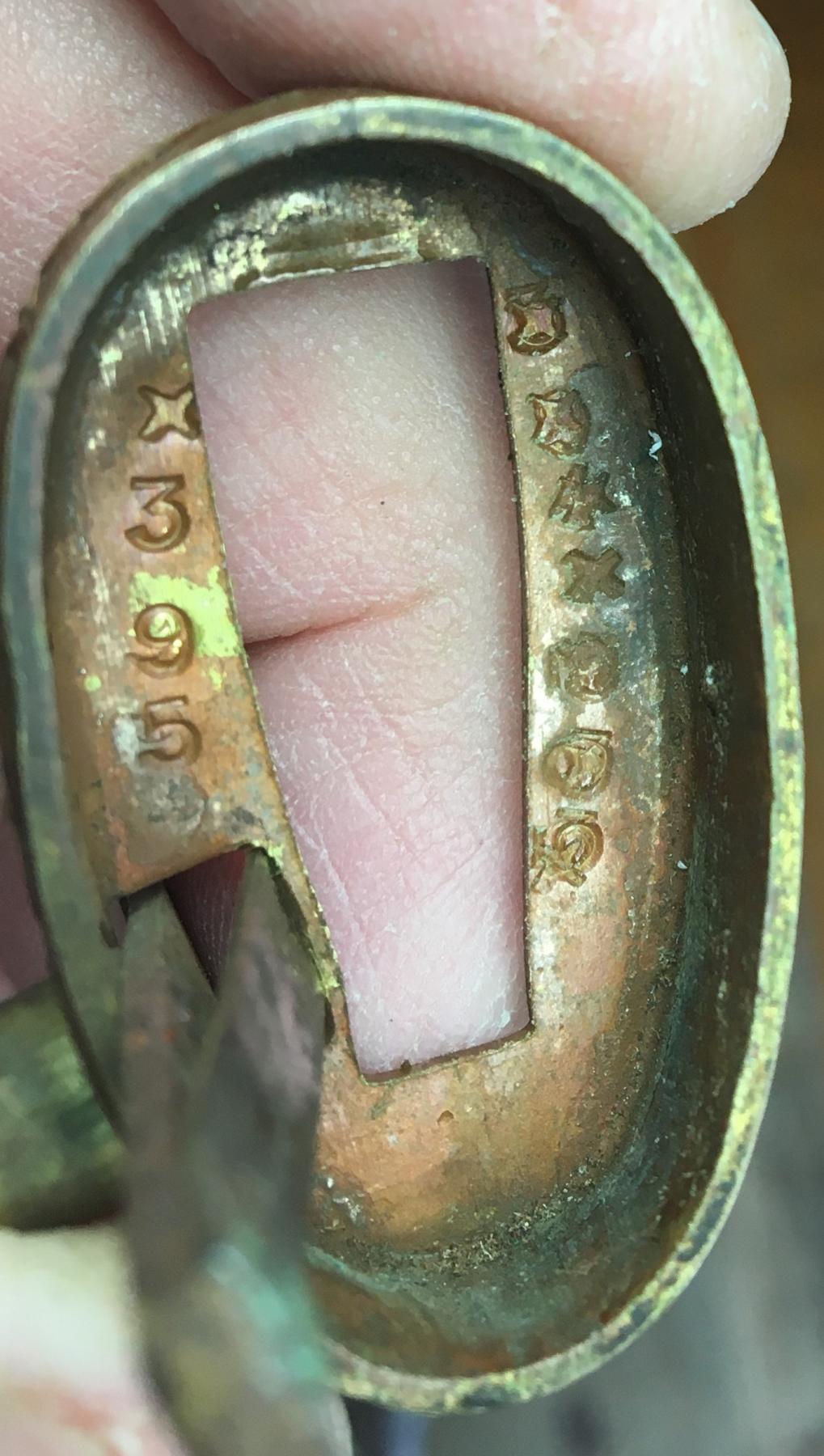

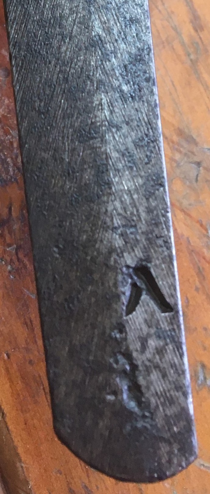

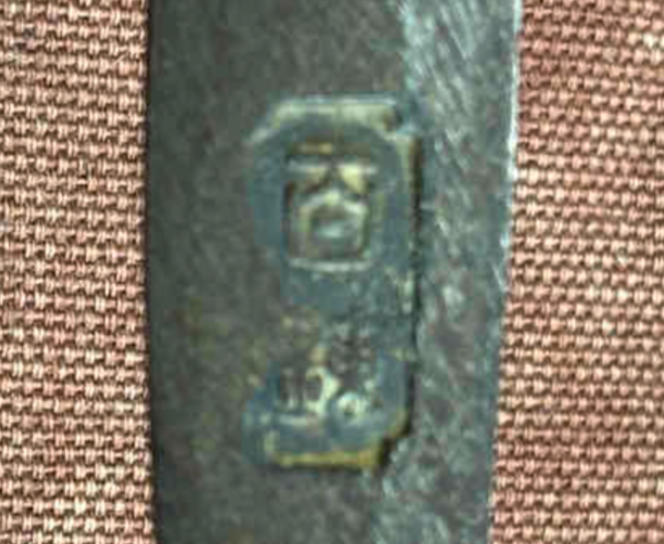

Alex Genikov Posted December 1, 2019 Report Posted December 1, 2019 Hello everyone! I am a new member here, but my interest in Nihonto goes back for a few years back. My ,specialization' is to repair and restor neglected blades and give them a new life where possible. I've completed a few projects by now with the good resalts recognised by the fellow collectors as well. Recently, by chance, I've became an owner of a few so called gunto swords and the quest for information leaded me to your wonderful site. A couple of hrs of research produced unswears on all my questions, thank you. To add to this topic I would like to post this picture of the nakago with the 'HE' stamp insp. mark of the Heijo factory Jinsen arsenal, which may help others to identify similar stamps as well. There is the only this stamp on nakago, it is mumei. I have another question or two, but it will be later on other topic. As for now all the best for All Alexander G or Alex Quote
Bruce Pennington Posted December 2, 2019 Report Posted December 2, 2019 Alex, Welcome! If you go to your personal profile page, you can set your first name into your posts so you don't have to type it in every time. That stamp is a new one on me! I am no Japanese language expert, but it doesn't seem the same as the "he" stamps I'm familiar with on the Type 95s (I'll post one for comparison). What kind of fittings are on this blade - army, navy? Quote
Alex Genikov Posted December 2, 2019 Report Posted December 2, 2019 Bruce, thanks It is a full set of army fittings numbered 395 on all pieces other side of nakago included. Beautiful blade with the straight hamon and fine jihada present. No arsenal stamps present either. You right this stamp looks more like hachi (eight) then anything. Maybe it is something different after all. I am surprised such a nice blade not signed! Maybe some kind of special order. Anyway, now it looks like it need more research. Lets see how it'll look like after polish, not soon though. Quote

Alex Genikov Posted December 10, 2019 Report Posted December 10, 2019 How about this one The left side is numbered and the right side... I'll let you geuss 2 Quote
Bruce Pennington Posted December 10, 2019 Report Posted December 10, 2019 On 12/10/2019 at 2:14 AM, Alex Genikov said: How about this oneThe left side is numberedand the right side... I'll let you geuss Alex, Haven't EVER seen anything like that! But since we're in the guessing mode - looks to me like there were numbers on the right side that have been "x"ed out with the same kind of X seen at the top of the numbers on the left. I've seen numbers filed off of saya drags by factory repair teams, then a new number re-struck. Maybe this is what we're seeing, but I can't see why fittings would be re-numbered. But then, as I wrote that, I realized the piece may have come from an original gunto that was damaged, and as they were being re-fitted onto a new blade, the fitters wanted to number it accordingly to the new pieces during assembly. Just an idea. 1 Quote
Alex Genikov Posted December 10, 2019 Report Posted December 10, 2019 Bruce, You are right about the "x'ed numbers on the right. What I can see on the left is 'x'ed number 394. My guess is its been struck wrongly by someone(not 395 as the rest of the parts) Then its been ordered to restruck on the left and save the already fitted part. Here you are the history on the run. Quote
