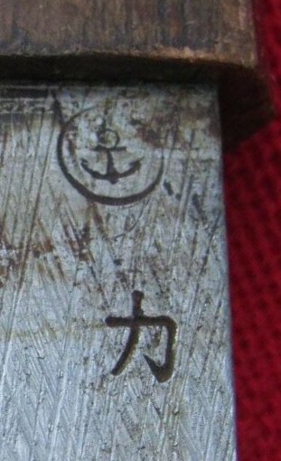

BANGBANGSAN Posted September 27, 2019 Report Posted September 27, 2019 Looks like ku for 9 Not 九,it's 力 Quote

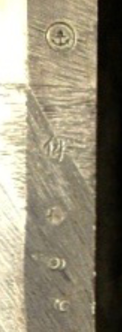

BANGBANGSAN Posted September 27, 2019 Report Posted September 27, 2019 Trystan, Do you have the smith name on that blade? I have in my files another kai with the identical styled Toyokawa stamp and it, too, has a kanji stamped below the arsenal stamp. It is the first kanji of the smith that made it. Could this be what we are seeing on yours? Bruce This is NOT my sword,and I don't think it has signature on the tang.Give another thought,力 means Power,you can see that kanji on some flag and sennienbari. Trystan 1 Quote

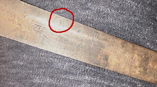

BANGBANGSAN Posted October 7, 2019 Report Posted October 7, 2019 Bruce found a 松 mark on Gunto Tang.It's in the Stamp chart. viii. ‘Matsu’ stamp found associated with tang batch or issue numbers. Significance unknown. Appears limited to blades (both signed and unsigned) found in 1944 pattern Army mounts. Rare. I saw this mark on some Type 30 bayonet.I think maybe it's from 松下電器 NATIONAL DENKI under TOKYO KOKURA ARSENAL's inspect. 1 Quote
Kiipu Posted October 7, 2019 Report Posted October 7, 2019 (edited) Encircled 松 matsu This marking has come up several times in this forum. A hurried search yielded the following. Survey of Gunto contract numbers. http://www.militaria.co.za/nmb/topic/8546-survey-of-gunto-contract-numbers/ Assistance Needed With Mei. http://www.militaria.co.za/nmb/topic/24992-assistance-needed-with-mei/ Arsenal Stamps. 松11. http://www.militaria.co.za/nmb/topic/5999-arsenal-stamps/page-1?do=findComment&comment=57724 Arsenal Stamps. 松61. http://www.militaria.co.za/nmb/topic/5999-arsenal-stamps/page-1?do=findComment&comment=57754 Arsenal Stamps. 松97. http://www.militaria.co.za/nmb/topic/5999-arsenal-stamps/page-14?do=findComment&comment=304770 My 1942 Munetoshi. 松443. http://www.militaria.co.za/nmb/topic/21367-my-1942-munetoshi/ Edited October 8, 2019 by Thomas 1 Quote

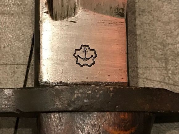

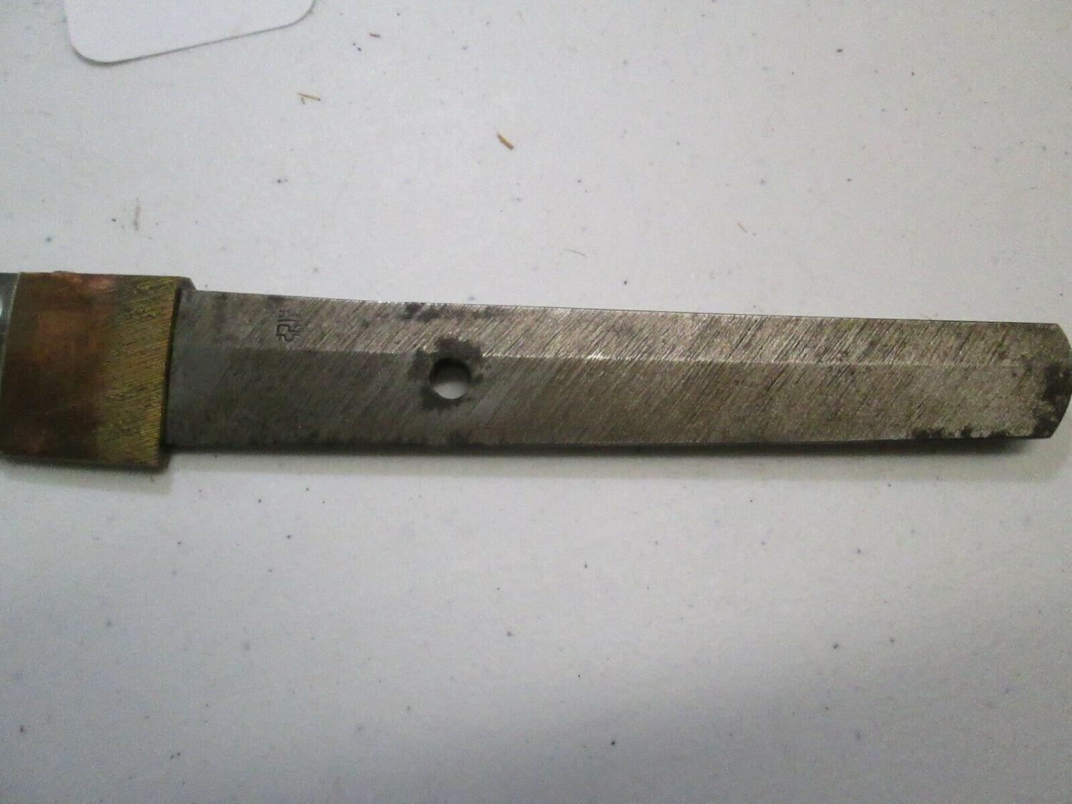

Kiipu Posted October 10, 2019 Report Posted October 10, 2019 Two KaiGunto for review #sword 2 - Double ashi http://www.militaria.co.za/nmb/topic/29929-two-kaigunto-for-review/ The second sword has a Toyokawa Naval Arsenal 豊川海軍工廠 logo. Toyokawa Naval Arsenal was officially opened in December 1939. On 1945-08-07, the arsenal was bombed and a week later all production came to an end with the surrender. The reason for posting is that I have been unable to locate this stamp in this thread. Edit: Looking at the stamp with a magnifying glass, it appears to be a Tenshozan stamp. There is another anchor mark but it has a different meaning and the discussion can be found in the War Relics thread below. http://www.warrelics.eu/forum/f216/showa-dept-interior-stamp-662590-post1693771/#post1693771 As to the origins for the mark, I understood that there were many cases of such mass produced blades snapping in the freezing cold weather of Manchuria. So the people in Seki decided to do voluntary impact testing on their products to ensure quality on blades for use by the military. They stamped blades that passed this test initially with the Kanji for Seki 関, signifying the guild. But later, one of the army arsenal factories happened to adopt the same kanji for marking, so the Seki people deferred and changed their impact test mark to the 昭 in cherry blossom mark for army orders and an anchor mark for navy orders. Anyway, that was what I took out from other sites. 1 Quote
Bruce Pennington Posted October 11, 2019 Report Posted October 11, 2019 Thomas, That reference to an anchor stamp is a mystery to me too. The only ones I know of are referenced in Fuller & Gregory's book, and can be seen in his chart: Quote

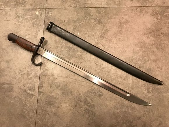

BANGBANGSAN Posted October 17, 2019 Report Posted October 17, 2019 Bruce Here is one rare arsenal mark for you.It's on a Navy Type 30 bayonet,some says it maybe made in Toyokawa Naval Arsenal (豊川海軍工廠) or Yokosuka Naval Arsenal (横須賀海軍工廠). 2 Quote

Bruce Pennington Posted October 17, 2019 Report Posted October 17, 2019 Fuller said both of these are seen on bayonettes and sword fittings but not seen on nakago, and are of the Toyokawa Navy Arsenal. Thanks for the great examples. I'll fit them into the Stamps doc. I haven't found any thing that identifies the T.E.C. markings. May be pure coincidence, but seem interesting that something starting in "T" is on Toyokawa marked items. Quote

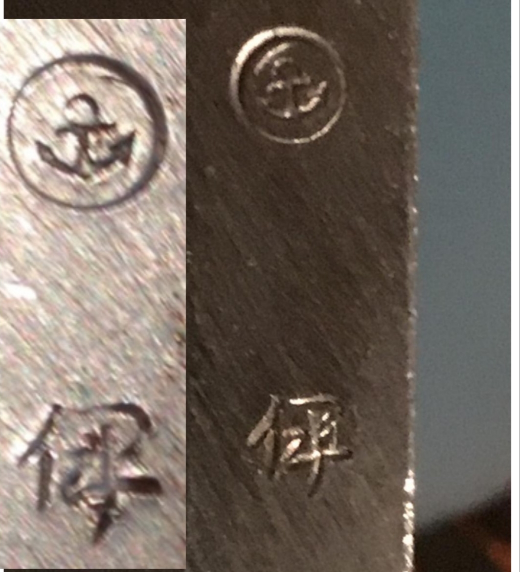

Bruce Pennington Posted October 19, 2019 Report Posted October 19, 2019 Small update on Toyokawa Arsenal blades with a second stamp: We now have 3 (thanks to Thomas!) blades made by "Inaba" with the same kanji stamped below the Toyokawa stamp. It is the first kanji of the name. Now we have a Toyokawa stamped blade with a "Ko" below the anchor stamp. Unfortunately, the blade is mumei. If anyone finds more like this, I'd like to see them, thanks! Quote

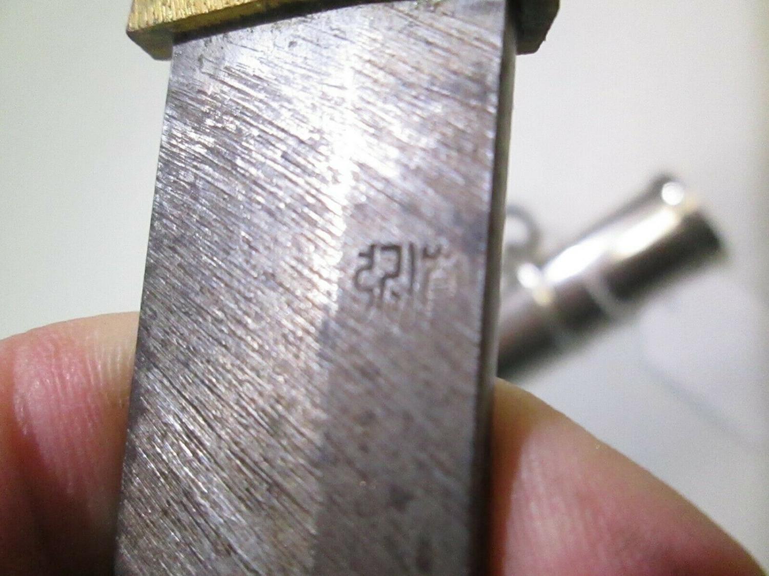

PNSSHOGUN Posted October 27, 2019 Report Posted October 27, 2019 Another unknown, found on a Kyu Gunto with what appears to be a traditional blade. Maddeningly I remember seeing another one a few days ago that I cannot find now. ebay link: https://www.ebay.com/itm/KYUGUNTO-RUSSO-Japanese-OFFICERS-SAMURAI-SWORD-WITH-SCABBARD-GROOVED-BLADE-N46/401933298387?hash=item5d95176ad3:g:TukAAOSwZTldsb4~ Quote
Bruce Pennington Posted October 27, 2019 Report Posted October 27, 2019 Here is a more clear picture of that one. Hopefully someone will be able to translate! Quote
Kiipu Posted October 27, 2019 Report Posted October 27, 2019 Another stamp example for the archives. I acquired a very nice Kongohyoe Minamoto Moritaka this past weekend. On the mune are two KUMA stamps. This is also the first Moritaka I have seen which did not include a kao. Photo below... - Ray A Japanese army inspection mark used by the Kumamoto Supervisory Unit 熊本監督班 of Kokura Army Arsenal 小倉陸軍造兵廠. 熊 = kuma http://www.militaria.co.za/nmb/topic/5999-arsenal-stamps/page-4?do=findComment&comment=85298 2 Quote
Bruce Pennington Posted October 28, 2019 Report Posted October 28, 2019 Thomas, It's tempting, but I just don't see it. See comparison below. I have a vague memory of an older Japanese wrtiting style (started with an S, I think) that was often used on older blades. Might have been religious based. I think this writing is of that style. Quote
BANGBANGSAN Posted October 28, 2019 Report Posted October 28, 2019 I rotate the second marke, it kind of look like 弘道 ,but I'm not very certain.There is a Showa smith name 丹羽弘道 Niwa Hiromichi though。 Or,from right to left could be 直弘,one Showa smith name 柳川直弘 Yanagawa Naohiro... let's see what Thomas think about this mark. Quote
PNSSHOGUN Posted October 28, 2019 Report Posted October 28, 2019 Yes, this is the stamp of Naohiro: http://www.militaria...l-stamps/page-6 http://www.militaria.../16356-showato/ And Chris Bowen writes: Quote Someone recently pointed this out to me...Stamp is indeed double struck. It is the smith's name: Naohiro. Remember, Japanese is read right to left traditionally.直弘Family name is Yanagawa. From Saitama.大慶直胤--直弘[初代](土野留助)--直弘[二代](柳川才次郎)--直弘[三代](柳川昌喜)-- 直弘[四代](松原英一)(埼玉県大宮在住)This is most likely the work of the second generation. During the Meiji and Taisho periods, he worked at the army arsenal in Tokyo making blades for sabres and other western style swords. He also made razors and the like. I have seen this stamp before on a razor as I recall.... 2 Quote
BANGBANGSAN Posted October 28, 2019 Report Posted October 28, 2019 Yes, this is the stamp of Naohiro: http://www.militaria...l-stamps/page-6 http://www.militaria.../16356-showato/ And Chris Bowen writes: Quote Thanks John for clear that. Quote
