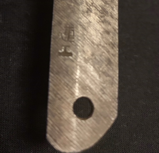

Bruce Pennington Posted January 15, 2019 Report Posted January 15, 2019 I don't think this one has been posted yet. It's a single kanji used for "Good Luck". Quote
BANGBANGSAN Posted January 15, 2019 Report Posted January 15, 2019 I don't think this one has been posted yet. It's a single kanji used for "Good Luck". GoodLuck.png Bruce Cool stuff there! I think this 福 maybe means 福岡(Fukuoka)or 福島(Fukushima)instead of 福(Lucky)。 Both福岡(Fukuoka)and 福島(Fukushima)has few 陸軍受命刀匠(Rikugun Jumei Tosho) in WW2. Quote
Bruce Pennington Posted January 15, 2019 Report Posted January 15, 2019 Hm, I may have to amend my comment on this on my Stamps document. Are those smith names or factories? Quote
BANGBANGSAN Posted January 15, 2019 Report Posted January 15, 2019 Hm, I may have to amend my comment on this on my Stamps document. Are those smith names or factories? Both 福岡(Fukuoka)and 福島(Fukushima) are the name of city. 1 Quote
BANGBANGSAN Posted January 15, 2019 Report Posted January 15, 2019 Smith from 福岡(Fukuoka) 小山信光 小山信房 田中正國 田中一切 武藤光弘 武藤秀弘 守次則定 守次行宗 末次繁光 小宮國光 竹原宗光 梶原廣光 河村幸光 野田吉國 古賀久國 柴田一祐 松永光保 瓜生信廣 井上信行 Smith from 福島(Fukushima) 關本頼正 日下部重道 塚本正和 猪狩保一 渡邊保定 2 Quote
Bruce Pennington Posted January 16, 2019 Report Posted January 16, 2019 Ok, and update on Fuku: From Chris S. (Vajo): According to Marcus' book, the blade was made by "Morimitsu for Fukuoka". So, it's looking like other municipalities, like Seki, Gifu, etc, were using stamps (Ok, I know Seki was a Guild, and the Nagoya Arsenal hyjacked it a bit too, but it was still a province). Quote

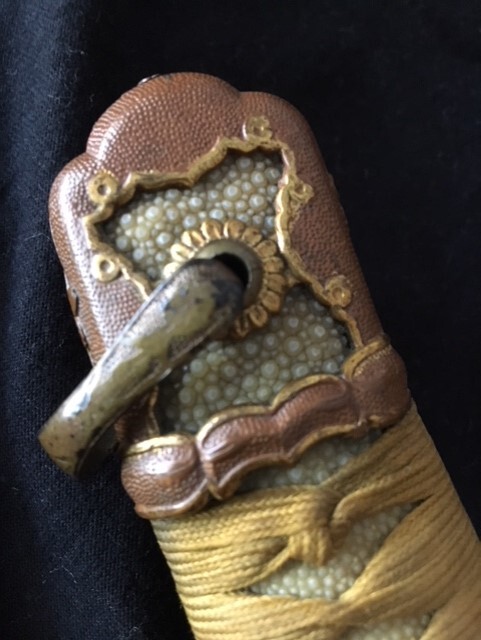

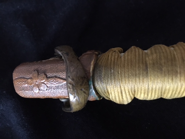

IJASWORDS Posted January 22, 2019 Report Posted January 22, 2019 Any idea on the markings on this sarute? It looks like an eagle with a rising sun flag behind it. Quote
vajo Posted January 22, 2019 Report Posted January 22, 2019 Eagle with swords or flash. Paratrooper sword? http://www.militaria.co.za/nmb/topic/25059-airborne-sarute/?fromsearch=1 Quote
