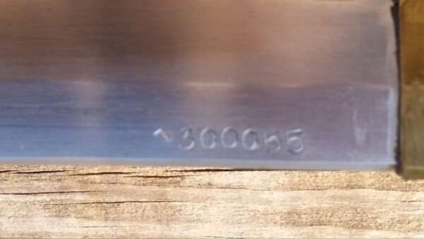

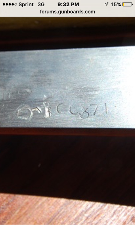

Bruce Pennington Posted August 4, 2016 Report Posted August 4, 2016 Thanks John! Here's a couple of Incheon Army Arsenal Pyonyang Factory "He" stamps, thanks to Matt (msam74) and "silverfox48" at Gunboards. Both are from late-war Type 95 gunto: Quote
SwordGuyJoe Posted August 4, 2016 Report Posted August 4, 2016 Bruce, Are you sure those swords are legit? I'm not on gunboards otherwise, I'd look for myself. 1 Quote
Bruce Pennington Posted August 4, 2016 Report Posted August 4, 2016 Here's the discussion. http://forums.gunboards.com/showthread.php?567201-Last-of-the-Late-War-NCO-Swords-with-a-serial-number You got me, though, I was so excited to see the Incheon stamp, I failed to look into the authinticity of the blades. With the sparse pics initially, one has very fresh ito and an officer tassel (which F & G, or Dawson, speculates means the ones with ito might have been made for officers), a seemingly brass tsuba, and a habaki that doesn't fit precisely. The other one looks normal, and has a "patent pending" ishizuki, though the number stamping looks poor. Concerning both, it is well known across the board that these late-war gunto were poorly made. I've asked them both about it and will update when able. Quote
SwordGuyJoe Posted August 5, 2016 Report Posted August 5, 2016 Someone would have to talk me back off the ledge, but I'd say fake. That said, these late war piece together swords always challenge me, so who knows? Quote
Bruce Pennington Posted August 6, 2016 Report Posted August 6, 2016 After looking over the pics of both gunto, I'm coming down on the side of "legit." Here's a link to the thread with discussion and pics, if anyone wants to investigate: http://forums.gunboards.com/showthread.php?567201-Last-of-the-Late-War-NCO-Swords-with-a-serial-number Quote
Shamsy Posted August 9, 2016 Report Posted August 9, 2016 100% genuine and known stamping. The late war Korean arsenal blades all have that large and shallow stamping (where they actually have the stamps). The over strike on the 3 is typical to. The 'tick' is the He stamp, the circle with two horizontal lines denotes a second class arms stamp and was also used on bayonets late in the war. I expect condition of these swords is good because these swords were made too late for most to reach the field. They are precisely made and standardized, crude by Japanese standard but certainly not jeep spring swords. They are too old and rare to be fakes or put together (remembering these were not even valuable 30 years back) but common enough to be a distinct pattern. Hope that helps guys! Quote
mauser99 Posted August 9, 2016 Report Posted August 9, 2016 that was my comment there. All I have seen are in the 300,000 range and have a larger font than the Japanese made blades and those are in the low 200k range. The one example with the cloth wrapped grip had the officers tassel and was for sale on ebay and realized 1850.00 The other wasn't for sale just shown as an example and was a wood gripped version. Quote
SwordGuyJoe Posted August 9, 2016 Report Posted August 9, 2016 Thanks for putting me straight guys - honestly. 1 Quote
Bruce Pennington Posted August 9, 2016 Report Posted August 9, 2016 Haven't seen that stamp before, Stephen! Is that off a shrine sword?! 1 Quote

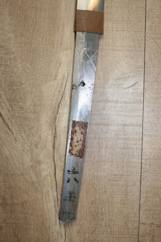

EdWolf Posted December 26, 2016 Report Posted December 26, 2016 This markings are found on the nakago of my navy sword. There is a naval mark near to the habaki, an unreadible label and some painted markings. Quote
Bruce Pennington Posted December 26, 2016 Report Posted December 26, 2016 Ed, the Anchor is the Toyokawa Naval Arsenal, the painted marks are for factory assembly, but the paper sticker is still a mystery. I have one that is just as unreadable, and have never seen one that is. Thanks for the pic! Quote
EdWolf Posted December 26, 2016 Report Posted December 26, 2016 Bruce, thanks for the information! Quote
