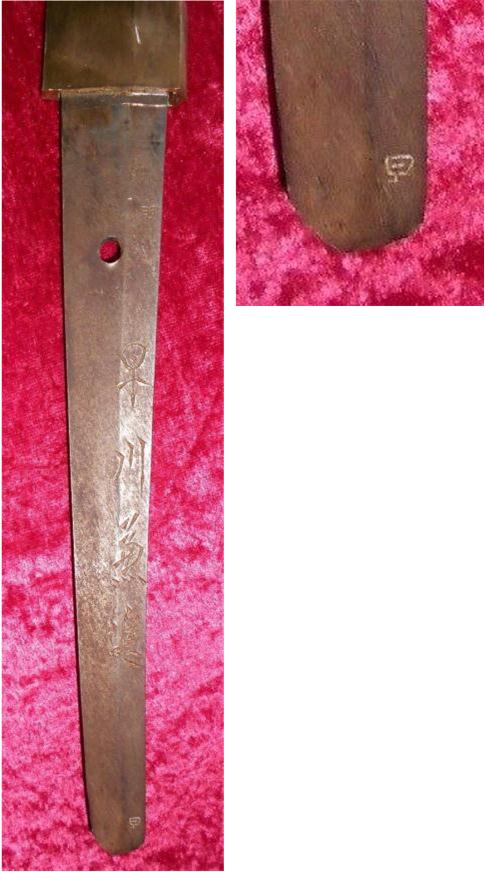

As George mentioned in another threat, attached the tang from Hayakawa Kaneyuki (including Seki and Haya stamp). Up to now I have no further information about this Haya stamp.... but will look for.

  george trotter said:
Klaus,
scroll back to page 12 of this thread...you will see the identical mark...I am sorry to say that the sword looks Chinese made to me.

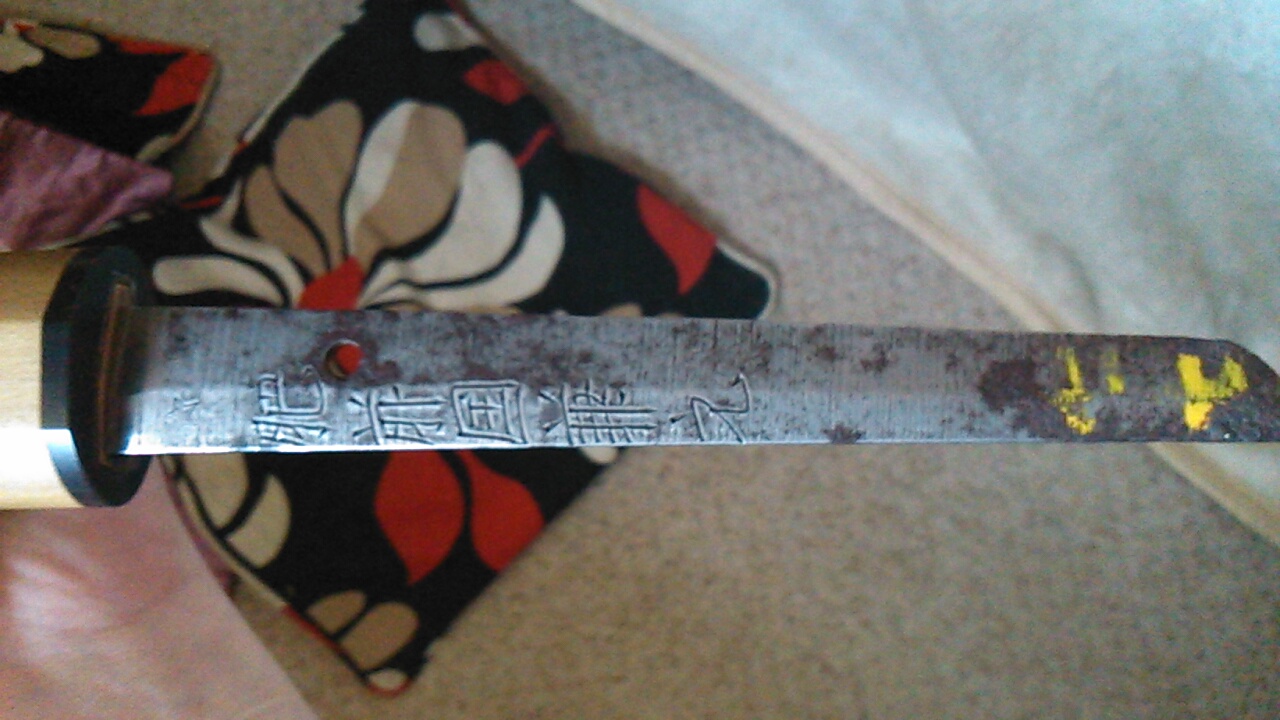

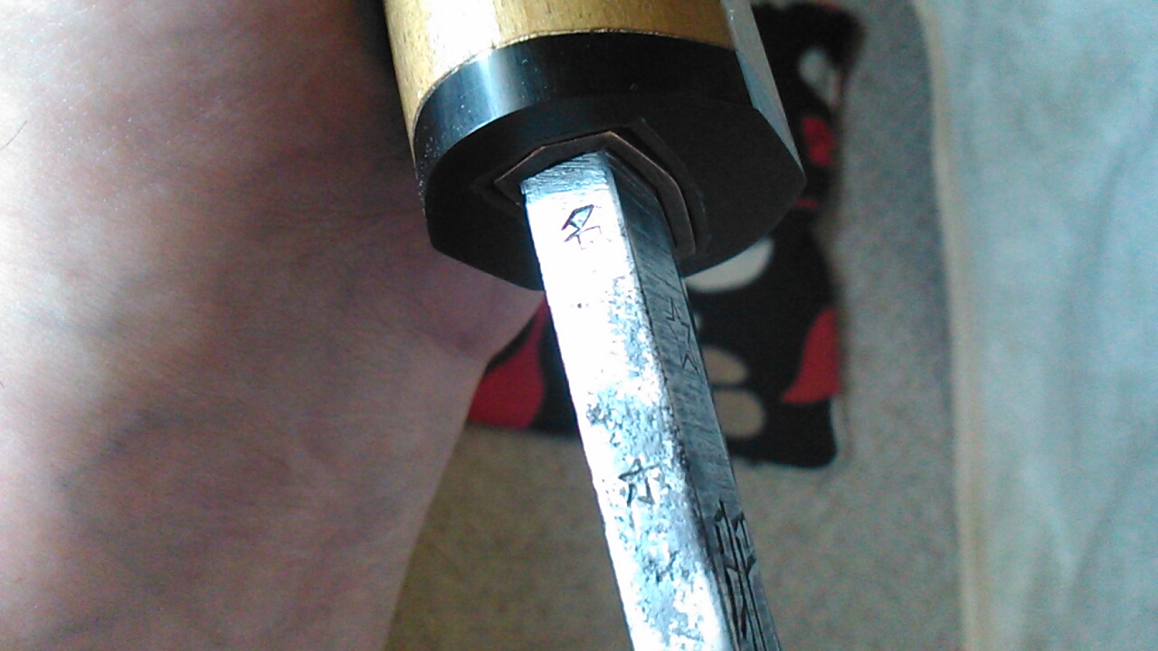

Thanks Ian,
The stamps on the mune of your RJT blade are "na" and "ho"...meaning Nagoya Arsenal and a second inspection mark.
FYI Motomura Kanemoto of Saga originally trained in the Muto School. I had a RJT blade by Muto Hidehiro (see this thread, page 1) and his mune had "ko" and "ho" indicating Kokura arsenal inspection.

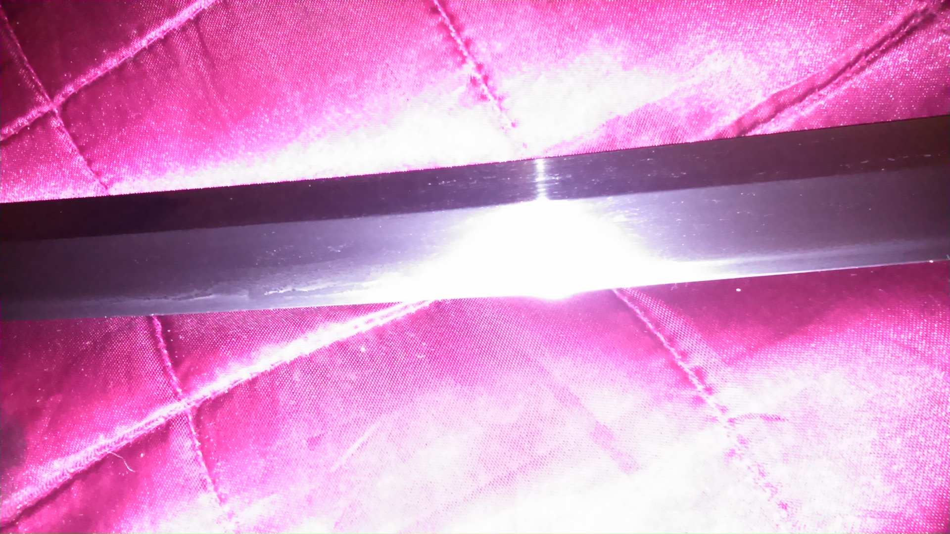

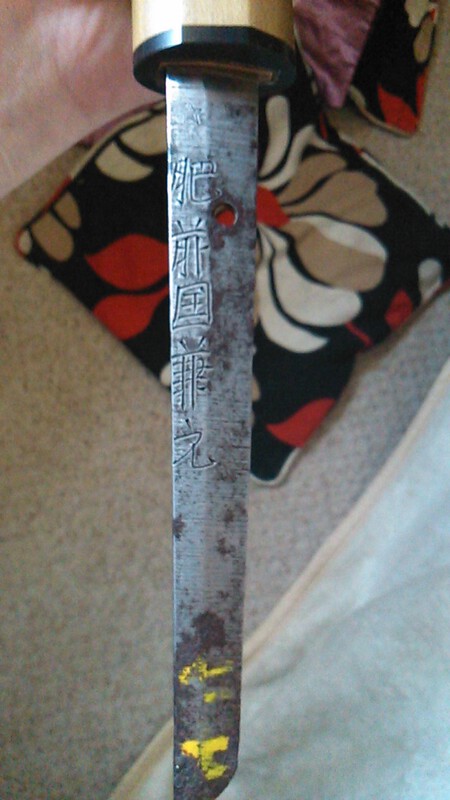

Pleasure George,tried to get a shot of the nie and activities, it is nicer in person,but the flash decimated the hada,what is this large piece of nie called,and the activity behind it.
The hamon is prickly with tiny Ashi all along,and two lines of nie in the kissaki,a lot of work for a showato, as some closed minded people still think.

Hi Eric,
This is not the place to ask kantei questions...Brian might move your hamon pic and question to the appropriate thread?
Just quickly, very coarse nie is usually called ara nie and "lines of nie" in the kissaki can be an indicator of masame hada.

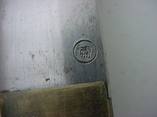

Hi All,
just an update on the stamp appearing on the blade near the habiki.
This came from a Japanese fellow on another forum by chance.
  Quote

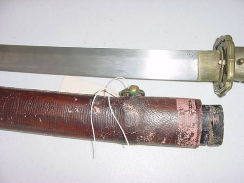

these 應 marked swords are late war lowered standard swords probably made in China for local and Japanese officers. The Kanji 應 is an older style of the Kanji 応 which is most likely a shortened form of 応急 meaning "emergency", like those similarly 応 marked emergency T-99 rifles.

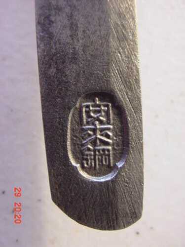

Hello,
does anybody know this stamp?
It´s not the Seki satmp, even the blade was made from a Seki smith.
Any help would be highly appreciated.
many thanks in advnace
Klaus
Search the forum for lots of info on Yasuki steel.
And don't forget to add it to the Arsenal Stamps thread in the military section.

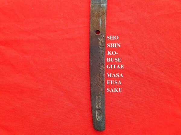

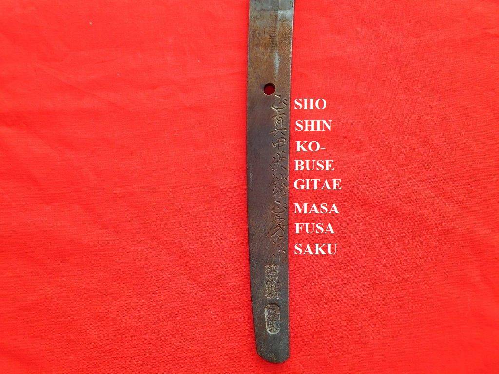

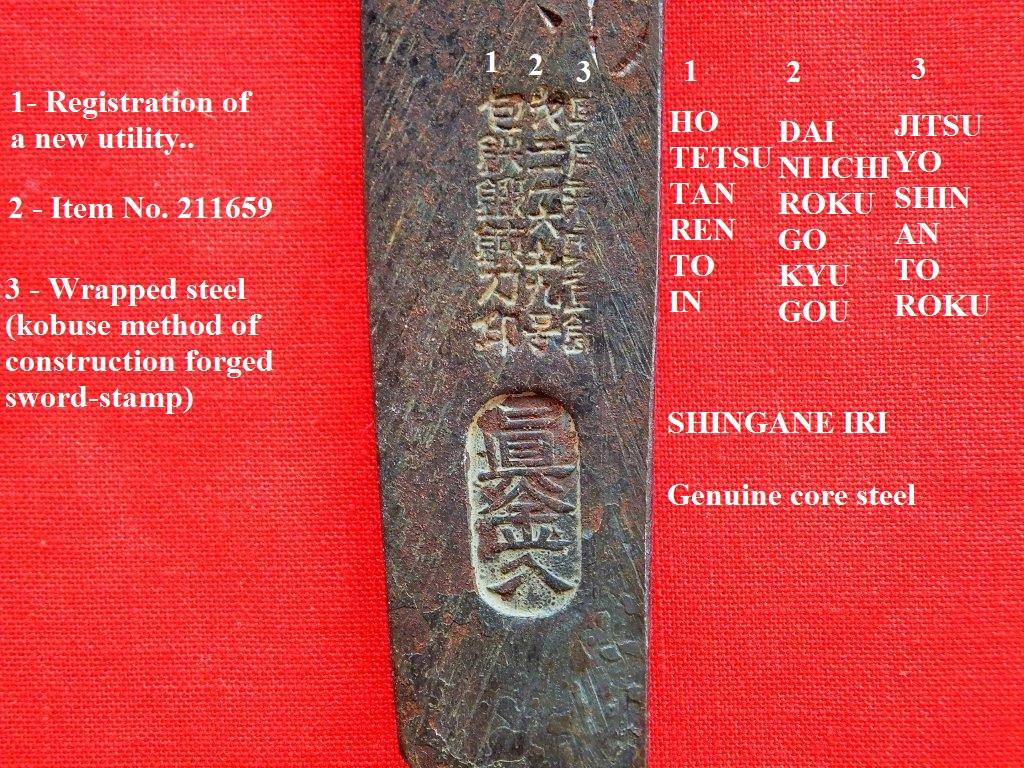

Translation isn't quite right...
" Shin gane iri" 眞金入 means something like "made with true metal" not "core steel".
包鉄 Ho-tetsu means wrapped steel but not necessarily kobuse construction.
Now that's one I have not seen before. Looks to be better quality production standards than often seen.
The K logo must be a manufacturer or sword shop. The kanji just say "sword steel".
Any chance of an overall pic and of the nakago?
