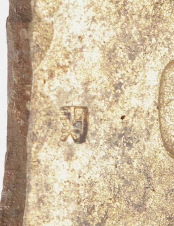

drbvac Posted July 21, 2010 Report Posted July 21, 2010 If for no other reason than to not let this die I will post these - only 2 pics I have of stamps and unfortunately one is - less than clear as it is only into the blade on 3 sides - must have been cold stamped ! I hope this goes on as a stickly under Military 1 is showa and I know there are hundreds better pics 2. is Gi gifu district from other members post Quote

quest44 Posted July 23, 2010 Report Posted July 23, 2010 A couple more better pics of the same Gifu stamp (on 1st page) Quote
