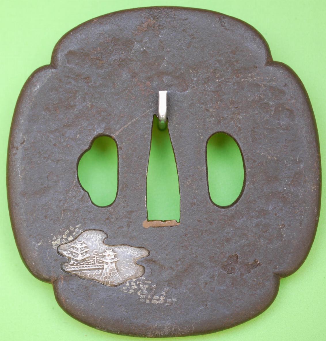

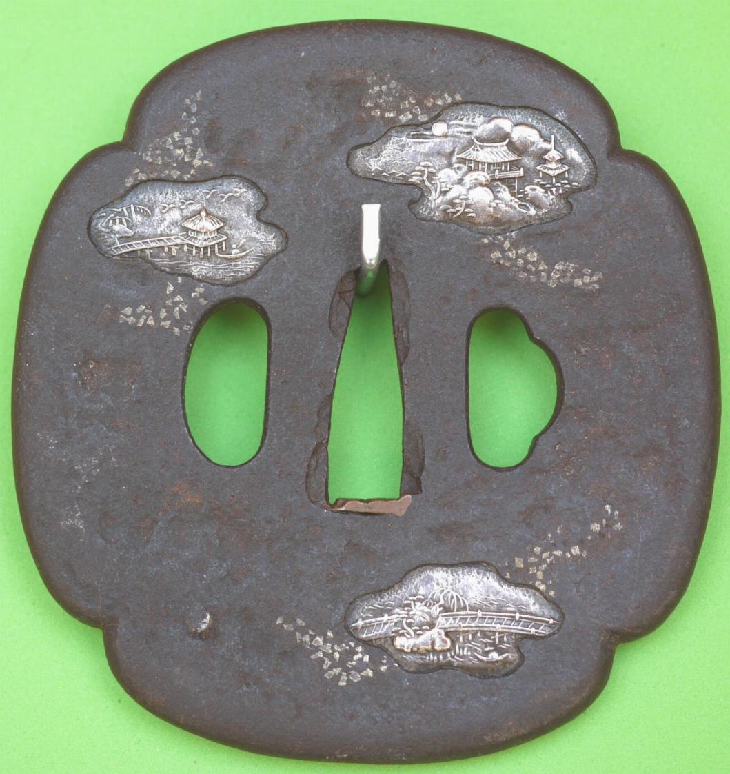

Ludolf Richter Posted July 8, 2010 Report Posted July 8, 2010 Hi,I have a typical Kaneie-II-Tsuba which has inlays in silver:4 of the famous 8 views of Lake Biwa.My believe is that these inlays probably had been added later (19th century?).What's your opinion?Ludolf Quote
christianmalterre Posted July 8, 2010 Report Posted July 8, 2010 Hallo Ludolf, well,hard to say as this kind of Tsuba is not in mine focus-but it looks like as you mention. Either way-very nice! Did you compare the silver-workmanship with this schools normal or if used typical workmanship? On colour you can´t fix it but on the line-drawing..... Christian Quote
Bob M. Posted July 8, 2010 Report Posted July 8, 2010 viewtopic.php?f=2&t=2636 Might the above help ? Regards Quote
Ludolf Richter Posted July 8, 2010 Author Report Posted July 8, 2010 Thanks!4 of the 8 (all 8 views of Lake Biwa) inlays of John's Tsuba seems to be identical with mine.That tells me,they were added to existing Tsuba (mine from Kaneie-II,exactly like Nr.T59 in Heckmannn,"Tsuba"),probably made by gold/silver-smith.Maybe because my Tsuba is relatively thin (0.25 mm) only 4 inlays were possible instead of 8.For me it's silver and not copper with silver.Ludolf Quote

docliss Posted July 8, 2010 Report Posted July 8, 2010 Dear Ludolf The consistent shape of each 'view' indicates that these decorative plaques were 'mass produced', presumably in the C19; I should, therefore, be very surprised if those on your tsuba are not, as are the others, silver plate on a copper disc. I think that the suggestion that your tsuba is the dai-tsuba of a dai-sho pair explains very neatly the presence of only four of the classical eight views. Why do you so confidently call the plate of your tsuba a 'kaneie II' plate? Kind regards, John L. Quote
Ludolf Richter Posted July 8, 2010 Author Report Posted July 8, 2010 Hi John,my Tsuba without the inlays not only has a similar surface structure like Heckmann's (all pieces in his book "Tsuba" are displayed with the original size!) T59 ("Kaneie-II") but is also identical in shape and the size/placings of the Ana:if I lay my Tsuba on his pic,nothing of the pic is to be seen.Sorry,I could have described it easier,if I had known (because not to be found in my dictionary) the English term for "deckungsgleich".Ludolf Quote

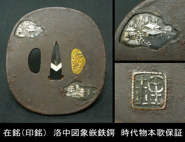

docliss Posted July 9, 2010 Report Posted July 9, 2010 Interestingly, we now have access to five tsuba, each with identical inserts of the Omi Hakkei, rendered in copper and with a silver plating, in an iron plate. These are: 1. A tsuba in my own collection, and illustrated in the thread viewtopic.php?f=2&t=2636 as noted above by Bob M. 2. Also illustrated in the same thread, Steve refers to a tsuba with similar inserts, but with a raised mimi, and with a NTHK paper attributing it (questionably?) to the Ichijō group. 3. On p.93 of Inami Tomohike’s Catalogue of the Fahrenhorst Collection is illustrated a very similar tsuba that is attributed to Satō Yoshiteru (H 12173.0), 1828-1902, and working in Kyotō. 4. On p.113 of the sale catalogue of the Collection du Docteur Mène is another tsuba. The illustration shows only three decorative inserts on the omote surface, and the gold hon-zōgan decoration present on the other tsuba appears to be absent here; it is described as having a seal for Tōu present on the ura surface. Is it conceivable that this is in fact a seal for Tōhō, a Satō artist (H 09713.0), 1824-1859, and working in Kyotō? 5. Finally that of Ludolf, with identical inserts on a (supposedly) Kaneie II plate. These tsuba raise two questions in my mind. Is there a common origin to all of them? The images were clearly ‘mass produced’, and were probably generally available for tsubakō to obtain, but was a single school of artists responsible for the end product? And were the ‘views’ silvered by a yakitsuke process, using a silver/mercury amalgam, or by an electroplating method, bearing in mind that electroplating with the noble metals was not perfected in the West until the 1840s? John L. Quote

kokyo jin Posted February 23, 2011 Report Posted February 23, 2011 This one may be of interest... http://page.auctions.yahoo.co.jp/jp/auction/145494323 Quote
