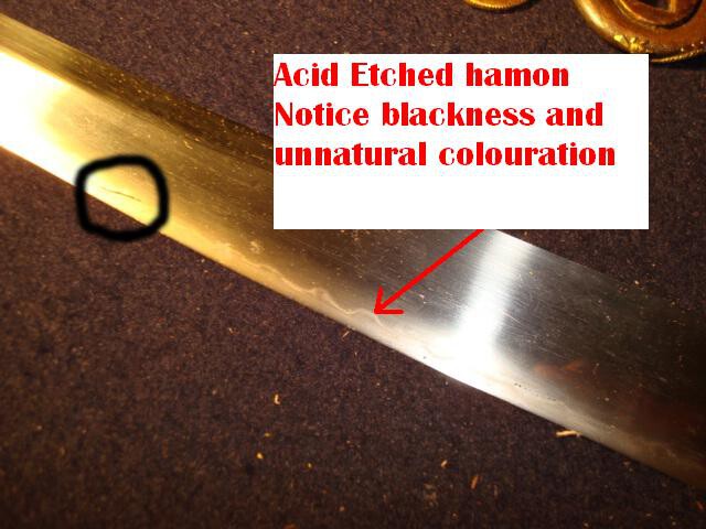

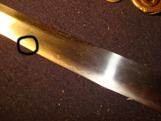

Sporkkaji Posted June 27, 2010 Report Posted June 27, 2010 Hello, I'm new to this forum though I've been reading through various threads for a while trying to learn what I can. I'm a complete novice, and on a whim I went ahead and made my first Nihonto purchase (not counting a naval gunto I've had for some time) on Ebay - a tanto from a seller who seems to have a positive reputation on this board. http://cgi.ebay.com/ws/eBayISAPI.dll?Vi ... 0623002613 I would be very interested to get honest opinions from the knowledgeable folks here about it, and will consider any mistakes I made as a learning experience. Did I pay too much? My bid was a dollar more than the next highest, as I have found that bidding one dollar above a round number will often get it. The seller's description states that there are no forging flaws whatsoever, but my untrained naked eye sees what looks to be very small hairlines along the hamon only on the left side of the blade. Sorry, the only pictures available are the ones in the listing as I don't own a quality camera. Is the ca. 1550 time period accurate and is the mei likely genuine? I'm assuming the koshirae is most likely from a later period? Is the blade an item which would benefit from papers at the upcoming bay area shinsa? Finally, the very detailed little dragon on the tsuba is reaching for a small round object (egg?), is there any symbolic significance to it? Any help would be much appreciated. Thanks! Quote
hybridfiat Posted June 27, 2010 Report Posted June 27, 2010 Im no expert but it looks good. Prices are going down unless Im very much mistaken. Yes showa22 has a good reputation. Ive had 2 swords from him and been happy with both. The last one he posted before Id had a chance to pay for it!? :D Quote

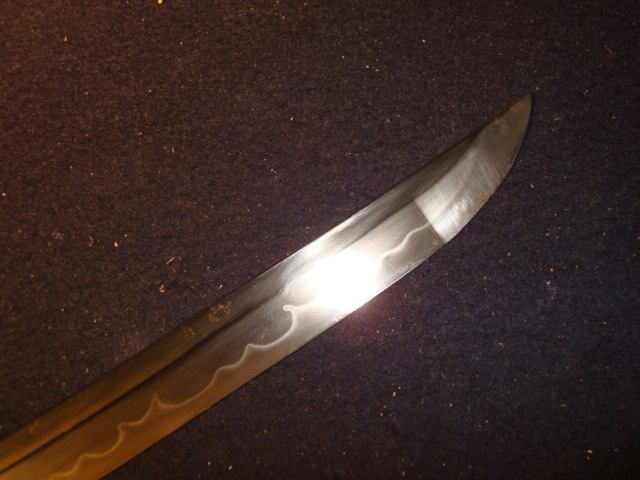

huntershooter Posted June 27, 2010 Report Posted June 27, 2010 Yuzo Maruyama (Showa 22) has been a good seller in my experience. The blade in question appears to have a "tateware" (beginning of grain seperation) at the hamachi, the hamon is thin and there isn't much hamachi remaining (which would indicate a lot of polishes in it's life). It is difficult to assess a blade from photos. Quote
loiner1965 Posted June 27, 2010 Report Posted June 27, 2010 agree with huntershooter...showa22 is an excellent seller and board member and any sword he sells as lots of pics so you can see any faults....on this piece i can see the hamon very close to the ha indicating many polishes and the ware fault near the hamachi......i would not hesitate in buying from this seller as he is as honest Quote
pcfarrar Posted June 27, 2010 Report Posted June 27, 2010 The tanto also appears to have had a "chemical" treatment to bring out the hamon. This seems to be the case on a lot of the stuff he sells. Quote
Sporkkaji Posted June 28, 2010 Author Report Posted June 28, 2010 pcfarrar said: The tanto also appears to have had a "chemical" treatment to bring out the hamon. This seems to be the case on a lot of the stuff he sells. What would I look for to spot this? Is that something that will continue to adversely affect the blade? I've given it a good coating of quality gun oil for corrosion protection, but is there anything else I need to do to protect it further? huntershooter said: The blade in question appears to have a "tateware" (beginning of grain seperation) at the hamachi All things considered I'm happy with the purchase, but that doesn't seem to jive with his claim of "There is no forging flaws, no opening, no crack temper". As well as the line circled in this picture, whatever it is. It definitely can be felt with a thumbnail, and there seems to be a hairline extending from it further toward the point, but it is too small to show in the picture. Quote
nagamaki - Franco Posted June 28, 2010 Report Posted June 28, 2010 Greetings, Sporkkaji said: The seller's description states that there are no forging flaws whatsoever, but my untrained naked eye sees what looks to be very small hairlines along the hamon only on the left side of the blade Well, the question is are you (name?) going to believe the written description of a seller or your own eyes? If its any consolation, sword blindness, a common ailment among beginning collectors shopping on ebay, which stems from desire and lack of knowledge, can also sometimes strike even the most experienced of collectors. The addition of a good helping of cynicism along with disciplined knowledge, aka kantei skills, applied when nihonto shopping is the cure. slightly huntershooter said: the hamon is thin and there isn't much hamachi remaining (which would indicate a lot of polishes in it's life) Not to pick on Todd alone here, , as I'm seeing this line of reasoning posted repeatedly here on the NMB, and while I'll be the first to fully agree with this line of reasoning in specific instances (perhaps even in the case with this tanto), I would point out that a thin hamon and a low or even a completely gone hamachi can be a direct result from a one time only chip correction. Which means the sword itself can be far from being polished down in the sense that the sword is tired from repeated polishing. Quote
Stephen Posted June 28, 2010 Report Posted June 28, 2010 IMHO id ask for refund or credit to trade up Quote
Eddie Posted June 28, 2010 Report Posted June 28, 2010 Mate for your first nihonto its fine, we all started somewhere. my opinion is enjoy your purchase, study it in person, learn what you can and enjoy the journey, when your ready to move up or when you find your tastes change you can resell to buy something else. p.s the hamon does not look " chemical treatment" to me, it looks to be in old polish, good enough to study. regards Ed Quote
pcfarrar Posted June 28, 2010 Report Posted June 28, 2010 Eddie said: p.s the hamon does not look " chemical treatment" to me, it looks to be in old polish, good enough to study. The hamon has been brought out using acid. It is quite clear from the unnatural colour of the hamon (dark grey/black ish). Quote
Eddie Posted June 28, 2010 Report Posted June 28, 2010 pcfarrar said: Eddie said: p.s the hamon does not look " chemical treatment" to me, it looks to be in old polish, good enough to study. The hamon has been brought out using acid. It is quite clear from the unnatural colour of the hamon (dark grey/black ish). sorry but i disagree the rest of the blade shows no signs of being acid etched maybe a experienced polisher might chime in with their opinion Ed Quote
pcfarrar Posted June 28, 2010 Report Posted June 28, 2010 Eddie said: sorry but i disagree the rest of the blade shows no signs of being acid etched Actually it shows all the signs of acid treatment I have the misfortune to have handled many acid polished swords (acid polishes are rife in the UK) so it really is quite clear. I agree with Stephen that the owner should ask for his money back. The sword was sold as having no forging flaws which it clearly does. Quote
Sporkkaji Posted June 28, 2010 Author Report Posted June 28, 2010 nagamaki said: Well, the question is are you (name?) going to believe the written description of a seller or your own eyes? If its any consolation, sword blindness, a common ailment among beginning collectors shopping on ebay, which stems from desire and lack of knowledge, can also sometimes strike even the most experienced of collectors. The addition of a good helping of cynicism along with disciplined knowledge, aka kantei skills, applied when nihonto shopping is the cure. Cory by the way. Well, the written description I guess since I didn't know what I was looking at in the picture - thought it might have been a smudge or something. Once I had it in my hand, the flaws were pretty obvious even to me. Another bummer in a recent string of them. I guess the question really comes down to whether I paid an exorbitant price for this particular piece considering the flaws and possible acid treatment. Assuming I don't demand a refund on general principle because of the misrepresentation, did I at least get an ok deal? Quote

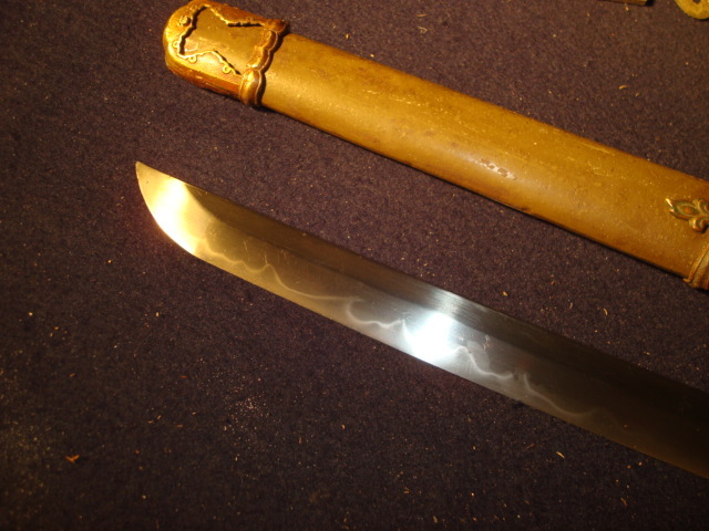

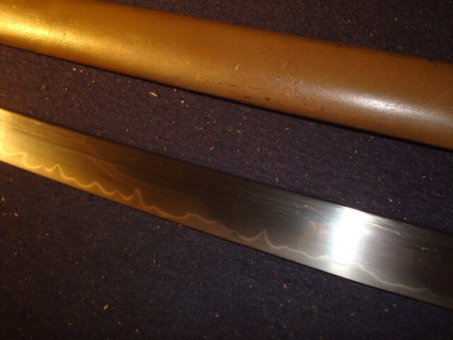

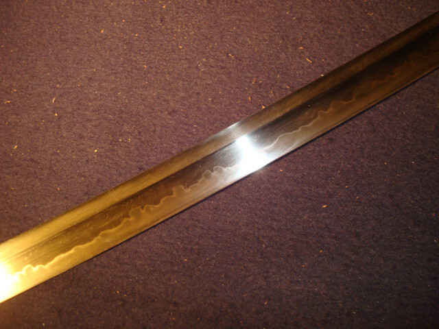

sturmbichon Posted July 4, 2010 Report Posted July 4, 2010 would thoses blade's hamons looks acid etched too ? Quote
nagamaki - Franco Posted July 5, 2010 Report Posted July 5, 2010 Quote "Heavens to Murgatroyd!", "Exit, stage left!" http://en.wikipedia.org/wiki/Snagglepuss All IMHO of course Quote
sturmbichon Posted July 5, 2010 Report Posted July 5, 2010 So thanks a lot to sporkkaji who started this post, otherwise i would have bought the first one thinking it was nice with such a great hamon. But after reading the post, i checked past auctions and saw many have this similar pattern. Which is too bad cause without thoses fake fancy hamons, thoses swords would be nice!! Thanks Namagaki Quote
pcfarrar Posted July 5, 2010 Report Posted July 5, 2010 sturmbichon said: fake fancy hamons You misunderstand they do not have fake hamon they have just been cleaned up using acid. When you get a sword in poor condition using acid is the quickest/cheapest way to bring out the hamon to make the sword more "commercial". It can cause serious damage as the acid gets into the core and begins to destroy it from the inside out. Quote
sturmbichon Posted July 5, 2010 Report Posted July 5, 2010 OK... I see, so thoses hamons are genuine, just enhanced by acid treatment. My concern was thoses sword all have "fancy" and very original shaped hamons, and I thought the acid treatment may have resulted in giving thoses nice shapes. Quote
