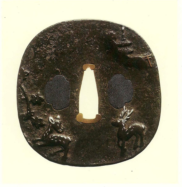

This is the Kaneiye Deer tsuba from the Hosokawa / Eisei Bunko Exhibit now touring Japan which Steven mentioned:
(please forgive a bit of distortion to the right due to proximity to the spine in scanning).
7/10: The second picture is from the NBTHK 1952 'Masterpieces of Japanese Sword Guards'. I am adding this to show the difference in patina which will be mentioned in following posts.
Hi Pete,
Many thanks, once again, for the visual aid... ;)
What's interesting is that this image doesn't really suggest much in the way of rust on the guard, right? Okay, now if one were to download this image to one's computer, and amplify the color saturation feature, one would then see quite a bit of redness appear. In the various crevices, this manifests as a lighter-colored and crustier-looking rust, while over the raised portions of the plate, the redness is darker and smoother. Could some of this be rust, while the other is wax remnant?
Cheers,
Steve
speaking as a total layman when it comes to this higher level of tsuba, it strikes me that even in the illustration kindly provided by Pete, that the accumultion of whatever it is around the elements of the design is rather disgusting considering the army of 'experts' available to maintain this piece and the collection it is part of. I would have thought this piece in particular would have been lovingly cleaned and preserved by its owners. I'm quite frankly shocked that it seems to have been so neglected. :shock:
Having said that, I of course would have no appreciation of the finer points and aesthetic value of accumulated crud and rust on such an artifact. I'm only a poor ignorant gaigin after all. :dunno:
Hi Keith,
Yes, that's just it. Clearly, such a guard as this Kaneie would rank at the top of the list of those tsuba to be especially lovingly preserved via the very best care/methods possible. And yet, it presents as we see it here. I am left with one of three conclusions (assuming what we see here is, in fact, active red rust): 1. rust isn't as bad as we think it is; 2. this sort of rusty accumulation provides an aesthetic plus to the tsuba's overall beauty, in the eyes of those who hold these pieces in their keep; 3. even the best and most experienced conservators are clueless about how to deal with rust, and so they leave the pieces in this condition. Of these, the third option seems the least likely (obviously), and so I'm left with one of the first two (if not both) to consider as the reason for the condition of this Kaneie as it appears here. Either way, the final conclusion I would have to draw is that the Sasano and Kremers exhortation to remove all traces of red rust with due haste is at the very least not shared by some pretty well-established and experienced conservators of tsuba such as this. Too bad we can't summon these conservators to "explain themselves" here; their views, whatever they may be, would be illuminating... ;)
Cheers,
Steve

An aspect of the case in hand..... I draw attention to the upper right hand corner of the Kaneiye Deer park tsuba in which a pagoda and rock are depicted with a section of the torii arch associated with a temple. In this case obviously Nara. The junction of rock and pagoda exhibit an encrustation which has separated from the plate and the design along an edge bordering the upper edge of the rock, and extending right to the upper part of the inlaid torii arch. To the left it borders upon the pagoda. This is obviously not part of the design but an encrustation of rust or some other material. Is this a part of the aesthetic appeal of the piece or merely an unremoved bit of crud that even the lowest level of maintenance would have identified and removed? :roll:
If this is rust then it threatens the surface beneath. Surely removal would reduce that threat.
If it is an accumulation of grime or whatever then surely as an unwanted part of the design it warrants removal. What part of rust and grime/accumulated wax, is historically and aesthetically pleasing or valuable? :?
Hi Keith,
We think alike, my friend.
I hear what Tim's saying (and Ford has said it, too) about the state of museum conservatorship and why this is. Still, there are many who would consider this tsuba to be THE most important tsuba extant in the world (Kaneie is regarded by many to be the greatest tsubako, and this tsuba is regarded as his best work by some). I'm not sure I can think of examples of any other art form where a given piece even might be considered the zenith of its species, and then neglected to this degree (if neglected at all). Lack of funding, minor art form, whatever. As far as I'm concerned, letting this tsuba languish in this condition is the equivalent of letting the Masamune Houchou tanto accumulate rusty spots and streaks on the blade, with maybe a pit and a scratch for good measure, and then displaying it for exhibition.
I wonder what Sasano would have to say if he were to see this Kaneie now.
Cheers,
Steve

It was mentioned above that the Kaneiye Deer (Kasuga-no) tsuba had been cleaned. This got me to thinking perhaps I could find a picture of the tsuba prior to cleaning which I was successful at. Please go back to page three where I have added it for comparison.
Hi Pete, it would appear to my eye that the Kaneiye has deteriorated since 1952 through not
cleaning or no maintenance while on exhibit out in open air even tho in a cabinet.
Alan.
