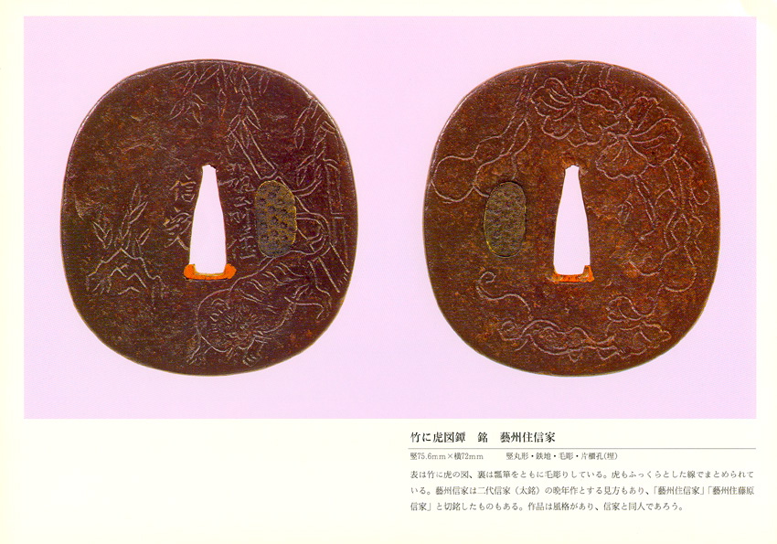

Steve Waszak Posted June 26, 2010 Report Posted June 26, 2010 Greetings, men... Having acquired some rather fine iron tsuba over the last few years, the question of the proper care of tsuba has become more pressing. Specifically, the issue of rust arises. Most of us are aware of Jim Gilbert's site on tsuba, which contains advice on the care and cleaning of tsuba. The advice is clear and detailed, and is to be greatly appreciated for these qualities. However, if one reads the advice on this subject offered by Sasano, Kremers, Sean Sweeney of the NCJSC, and others, the details in the language there would have it that the elimination of all red rust on a tsuba is essential; the advice even goes so far as to suggest that picking away at the red rust in the ana and sukashi elements is acceptable, if the rust is pronounced enough. Reading such advice after having read Jim's presents one with something of a dilemma, as his words make it clear that the cardinal rule is not to overdo it. Describing below the part of the process of cleaning where one has successfully removed the most egregious of the red rust on the plate and rim of the tsuba, he then states the following: "If you think you've got the rust under control, take your tsuba out in the sunlight and have another look. Most artificial lighting hides red rust somewhat, but sunlight will reveal all. You will probably find that there is still more rust there, but don’t get carried away with trying to remove every trace. Don't over do your cleaning. The idea is not to make a 500-year-old tsuba look new. Older tsuba can have quite a lot of oxide build up that is best left alone. The idea is to remove any active corrosion and restore the beauty of the surface, not to fundamentally alter it. An over cleaned tsuba is always worse than an under cleaned one." Remember, the words of Sasano, Kremers, Sweeney, et al have it that removing all traces of red rust is vital. So, now what? I think the matter is confused, perhaps, by the lack of full clarity I have of what, exactly, constitutes "red rust." One question I have is this: does ANY rust-COLORED tinge on a tsuba constitute ACTIVE red rust? I see many tsuba with bright orange, crusty rust spots, and these, to me, do seem to be evidence of rust activity. But what about those tsuba whose "red rust" is describing only thin hints of washed-out maroon or coral colors, areas on the guard where the "rust" is only suggested, looking more like a remnant of rust or like some sort of rust "residue" than actual, active red rust? Or those spots we often see on tsuba that appear more like rust in "arrested development," dark, reddish/rusty-brown? Is this the sort of "red rust" that Sasano and his team would see as requiring removal? Personally, I am much less bothered by the presence of red rust on a guard if I know it is not active, so I ask again: does ANY rust-COLORED tinge on a tsuba constitute ACTIVE red rust? One final thought here. I have gone through my library, attempting to find examples of iconic, superstar-type iron tsuba, to see whether they present with any traces of red rust. After all, as Sasano and Kremers would have it, to allow these icons from Japan's past to suffer the neglect that the continuous presence of red rust would constitute is tantamount to a cultural crime of high order. And yet, I can find Kaneie, Nobuiye, Myoju, Jingo, and others whose tsuba exhibit red rust ranging from the merest echo of rusty coloring to fairly pronounced patches of reddish-orange/brown. In some cases, this manifests only in the various interstices on the guard's plate (due to tsuchime, bori, etc...), but in others, nearly the whole of the plate is covered in this "film" of rusty breath. If one wants to see the degree to which this exists in these tsuba, try amplifying the color-saturation mode on your computers as you're viewing the images. Sorry to have gone on so long. But I find it frustrating that this subject does not appear to have been dealt with as fully as it should be. Too many ill-defined terms and meanings, too many pieces of contradictory advice from very experienced, knowledgeable scholars and collectors. As I get more deeply involved with the holding of these pieces for a time, I want to know more definitely how to deal with the matter of "red rust." Below, please find examples of great, iconic tsuba, each of which exhibit clear red rust. Please note that I have amplified the color saturation in each image to show more clearly the presence of this red rust. Cheers, Steve Quote
Grey Doffin Posted June 26, 2010 Report Posted June 26, 2010 Hi Steve, When I think of active red rust I think of something building up from the surface of the tsuba. In the 3 examples you present I see nothing of concern. At most, I see a red tinge that is likely just the color amplification you mention. In deed, I often find when I photograph iron tsuba, that they appear redder in the pictures than in life. When I clean an iron tsuba I try to remove anything on the tsuba that appears built up, obviously red, and/or crumbly and easily removed. Once I'm down to the original surface I can figure that the tsuba is stable and that the patina will take care of itself. This is oversimplification, I know, but not far off what usually happens. Grey Quote
Curran Posted June 27, 2010 Report Posted June 27, 2010 The Kaneiye Daruma tsuba has no red rust in other post year 2000 photography of it sent to me a few years ago. I doubt it did prior and suspect you are dealing more with photo quality in the three examples provided. Some felt Sasano overdid the cleaning on his tsuba. Not to the point of damage, but rather that they were just pristine and polished / brushed to a point at the edge of what others liked. I passed on one a few years ago after seeing it in hand and thinking it had been polished too porcelain clean for my liking. It is probably one of only 3 or 4 that I sincerely regret passing on in the last decade. My deep regrets to the former owner, who is on this list. Overcleaning is another issue. Do enough low level tsuba as hobby or learning experience and you will eventually decide/learn when you have gone too far. Definitely teaches you about a feel for iron. My 'too far' was an edo Tosho tsuba that I overdid a bit and spent the next few years trying to get the chemistry of patina to start naturally healing in. Feel a bit of guilt on that tsuba that it was a good one (not a great one) in that I took it from where it was to a healthy point, and then past that too much. With the exception of one extreme rescue tsuba that needed removal of considerable rust, I've never done it since. As for doing it within the sukashi. That is a harder lesson. But I agree. If you don't intervene on those with it in the sukashi... what you get is the Boston Museum collection..... Go and look at the iron ones in person some day. It saddened me to finally get to Boston. couldn't arrange a meet with Mr. Earle, so went with a college friend to the museum. A fair number of the beautiful tsuba are rusted through in the walls of the sukashi, though you wouldn't know from looking top down on the tsuba. Like a nice house where you lift up the siding and find the supports eatten through by termites. I regret to end it on that visual image. caring and cleaning for tsuba goes well beyond Jim Gilbert's article and there are 1 or 2 individuals who have accumulated decades of knowledge in it. But the ones I know don't "do the internet thing"... Curran Quote

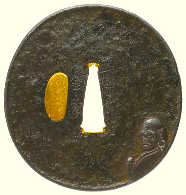

Ford Hallam Posted June 30, 2010 Report Posted June 30, 2010 Here's an example of what I consider a fairly straight forward clean up. Here's a link to the large image I removed the surface rust residue, neutralised the surface and touched in the patina where the corrosion damage demanded it and re-waxed. I can't be 100% certain the final result is as the maker intended but I feel reasonably confidant it now looks far more like it would have done when initially used than it did before my intervention. Quote
Curran Posted July 1, 2010 Report Posted July 1, 2010 Ford, Looks like a tough job for the folksy way I work on the the occasional tsuba. The moat around that tsuba would have taken me forever, and I confess to once giving up on a basketweave Bushu tsuba with a spray of rust on it. Keith- Ford or someone like Boris (Denizens of Vahalla, Boris is less frequent) will be quicker on the inorganic chemistry lesson. Cliff notes version: Magnetite is good. Rust is bad. Now go learn how to make magnetite Quote
Steve Waszak Posted July 1, 2010 Author Report Posted July 1, 2010 Ford, Thanks for that example of before and after. Now, did you remove that rust by simple ivorying? And could you elaborate on what you mean by "neutralising"? Finally, a word or two on how one goes about "touching in" the patina would be very interesting to hear (if that's not a trade secret, that is... ;o). Keith, many of your questions here echo my own. Your observation that tsubako of old knew, of course, that their guards would rust to some degree is a good one to keep in mind. My question, as a follow-up to yours here, would be how the Japanese dealt with/cared for these iron guards over the course of centuries. Did they clean them? How? How often? To what degree? How was it known to what degree they "ought" to be cleaned? I mean, some of the tsuba we have are a good 400-500 years old (or more). Without care, they'd have rusted to dust long before now. So clearly, they received some attention. But what kind? How often? ) Cheers, Steve Quote

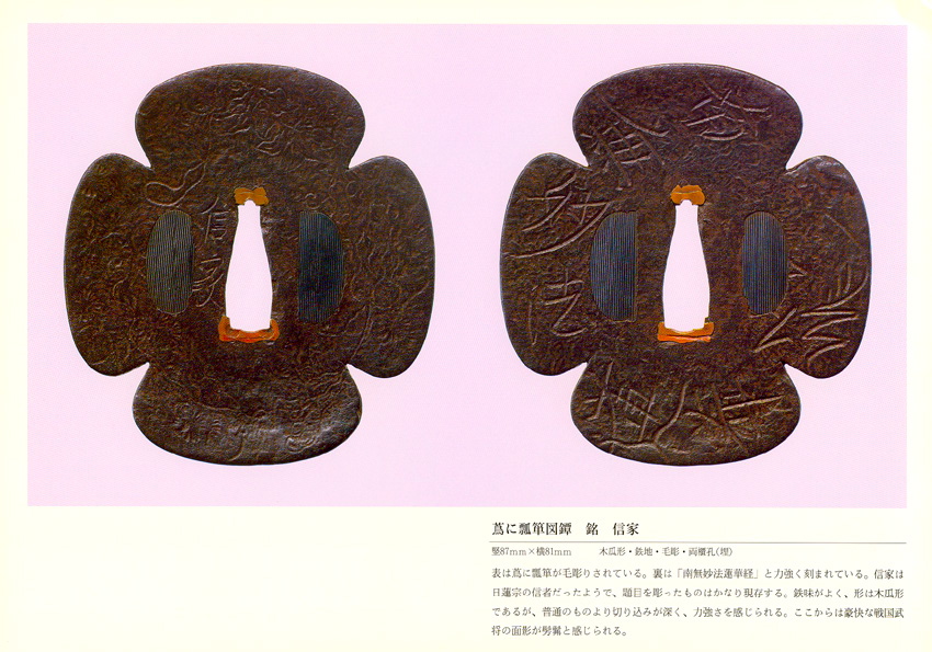

Pete Klein Posted July 3, 2010 Report Posted July 3, 2010 From the original Sasano Sukashi Tsuba, 1972, Japanese text, pg. 245: From the Masterpieces/Sasano Collection, 1994, pg. 296: This is a good example of what Steven was referring to above. Quote
Steve Waszak Posted July 3, 2010 Author Report Posted July 3, 2010 Pete, Yes, thank you for this illustration... ) See, for me, this raises question about how reliable Sasano's opinions on tsuba care and maintenance are. I realize the example you provide for us here is a rather extreme one, but nevertheless, it does beg the question: if not this degree of "cleaning," what degree is ideal or "proper." Of course, with this example, we see (I think) Sasano going well beyond his own advice in his earlier book on sukashi tsuba: this piece is evidence of much more than removing red rust and then simply wiping the guard down from time to time to allow the black rust to take hold and develop. Was Sasano just over-zealous, then? Thanks again Pete for the photos... ) Cheers, Steve Quote
Curran Posted July 3, 2010 Report Posted July 3, 2010 Steve, Not pro or con on the Sasano advice. Please don't forget Peter's perfect example in the context that it was questioned who cared for his tsuba later- before the second book was produced. Peter, Interesting example. The Sasano Hirata I passed on purchasing had this same sort of micro dotting that can be seen on the c.1994 tsuba you posted. Not on the earlier one. Strange and wonder what did this. Quote
