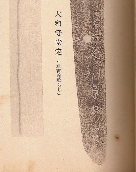

Toryu2020 Posted June 18, 2010 Report Posted June 18, 2010 Definitely Shintô - An excellent finish on the nakago and a practised hand in the signature - My reading would be Yasusada (安定) of the Edo Yasutsugu school - an important smith if indeed this is he... -t Quote

Toryu2020 Posted June 19, 2010 Report Posted June 19, 2010 From the Shinto Oshigata Shu, the Shodai at least did Sosho mei - Yasusada is well published, will look at other references tomorrow to see if I can find some other Sosho mei for this group of smiths... -t Quote
