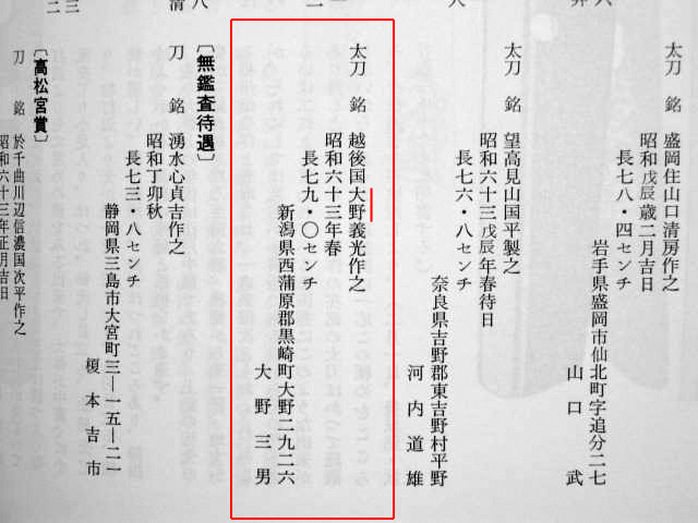

k morita Posted June 18, 2010 Report Posted June 18, 2010 Hi Mike, "Ono mei" appears on [Token Bijutsu]#377, name list of 24th Shinsaku-to Exhibition. Quote
Nobody Posted June 18, 2010 Report Posted June 18, 2010 Thanks Morita san, the mei/date also shows that there was no character after “Haru (春)”. Quote

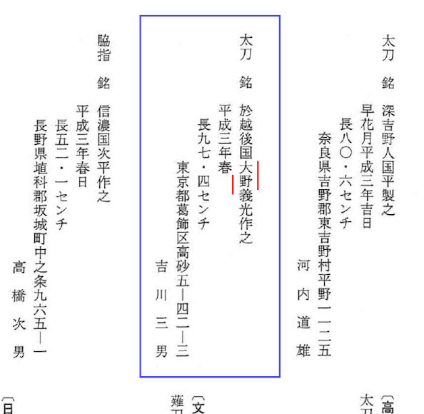

Nobody Posted June 18, 2010 Report Posted June 18, 2010 I found the “Ono mei” in the list of the 27th Shinsaku-Meito Exhibition in 1991 (= 平成三年). The sword may be the same one on the Token-Sugita site ( http://www.token-net.com/katana/3k600-y ... mitsu.html ) which I referred to in my previous post. Ref. http://www.tousyoukai.jp/rireki/data/h3.pdf The mei includes “Ono (大野)” part and does not include any characters after 平成三年春. It is exactly the same description as the example A. So, the theory about the example A (so called fake) is incorrect. Quote
outlier48 Posted June 18, 2010 Report Posted June 18, 2010 So, it seems that both "A" and "B" are genuine Ono blades? :? Charlie Brashear Quote
Nobody Posted June 19, 2010 Report Posted June 19, 2010 So, it seems that both "A" and "B" are genuine Ono blades? :? To be accurate, the example A as well as B is not explicitly proved to be genuine yet. But at least the two out of three reasons to believe that the example A is a fake are denied, I think. Quote
