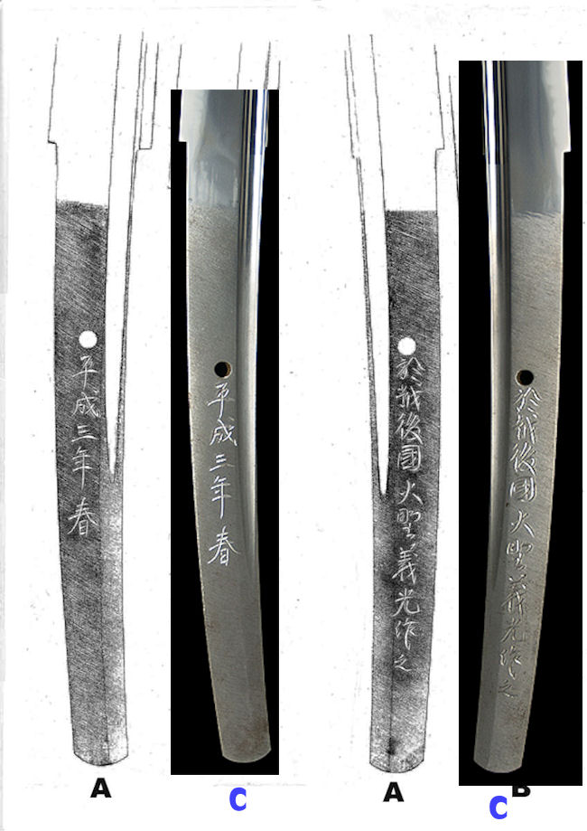

Based on the way the kanji were formed in the pic Eric posted I am going to guess "A" is legit and "B" is gimei.
Whatever the correct answer, I think we are all going to learn quite a bit when Mike reveals the "why's and wherefore's" on this.
Charlie Brashear
I hadn't commented as my answer has already been given.
A is real.
B is real but Yoshimitsu makes copies of older works and I think this is an example, hence the 'shortened' nakago that still looks pristine.
However, now knowing there are convincing fakes of his out there, I'm not so sure. ;)

Oh do you guys want the answer? Sorry just had to do that! :) Also in MOST cases, Ono's nakago jiri is usually done in the osuiage style. Sometimes it is done in the normarl kuri jiri fashion, and almost always kuri jiri when doing wakizashi and tanto.

Unfortunate indeed. Ono-san is a truely a gem of a man and to say that he is a talented smith is a great understatement. He also holds his work to a very VERY high personal standard. Any work out there with even minor kizu should be considered forgeries as he does not allow them out of his shop. Any sword that does not meet his approval for high quality is broken over the anvil. I examined one of his Yamatoriige utsushi at a past Dai Token Ichi. It was gorgeous, but not for sale. I assumed it was perhaps just the dealer's personal blade on display. Later I asked Ono-san about the sword and if it belonged to someone, and he said basically "yes, it's mine". I asked if it was for sale and he replied he could not sell it because during the polishing a small ware had come up. I had looked at the sword for quite a long time and did not notice anything and told him so. He replied that it was very small and not conspicuous, but still not acceptable to send to a customer. By the time it came up it was too far into the polish so now he just keeps it for himself and for display only and it will never be for sale.
So as much as looking at mei is good exercise, again I just want to point out that the work must confirm the mei. In the case of Ono Yoshimitsu, if the work looks shoddy, it is not his blade.

To be 100% clear, I understand the date variation and the 'Ono' variation, but the chippy 'Yoshi' is actually the correct one?
Usually a bad sign on soft metal fittings signatures, but correct in this case?
Working from the examples Eric or someone else posted, I would have thought that A was a better match (being more relaxed) would have been more likely to be correct.

And Curran yes the "chippy" one is the real one. I will foward your comments to Ono san if you wish - This is a rare situation in which the faked artist is still alive and things can be verified for sure, not like the numerous Gassan School fakes of Takahashi Sadatsugu and Kiyomaro that are shinsakuto by lower smiths that have been appearing on ebay for the last 2-3 years by a dealer that will be not named by me. Beware, study!

There is a mei which is very similar to your fake example A. I found the similar mei on an old page of a known shop in Tokyo, though I doubt that the page is still valid.
Ref. http://www.token-net.com/katana/3k600-y ... mitsu.html
I show the mei© along with the example A in the attached picture. The mei also includes “Ono”, and the date does not have anything after “Haru” either.
Is it also a fake?
B- According to informtion from Japan,When Ono san signed a sword,
he never uses formal name "Ono" as part of the signature.
The mei also appears a photo of Tachi-sword " Ono " on page 130 on [Modern Japanese swords and swordsmiths: from 1868 to the present] by Leon Kapp.
And He used "Ono" on Tachi sword on Shinsakuto Exhibition.
http://www.tousyoukai.jp/19th/index.shtml
The example that was posted by morita san has been sent for verification. I just advise all to be cautious until things are sorted out, they are working on this in Japan,and I was asked to warn the western collectors. I do not doubt that some forgerys have slipped by many a shop when sold as used second hand swords.

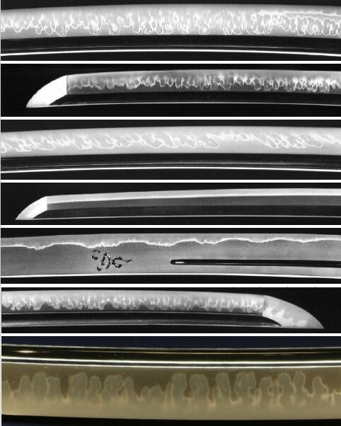

I suppose that the forgers identity at present is unknown. Well, the Nakago test gave evidence of the forgers skill, but how about the characteristics in the blade?... Hada, Hamon, Hataraki and so on...and how many blades approximately are proven to be gi-mei?... or have we to think of one blade? I can imagine to forge Yoshimitsu's characteristics must be very difficult.
Some examples of Yoshimitsu's Hamon.
Eric
I just looked through the book, "Ono Yoshimitsu's World of Juka Choji" which is a catalog illustrating 12 of his works. In every single example, including 2 wakizashi, the season noted is followed by "kichi jitsu", and none of the examples carry "Ono" in the inscription.

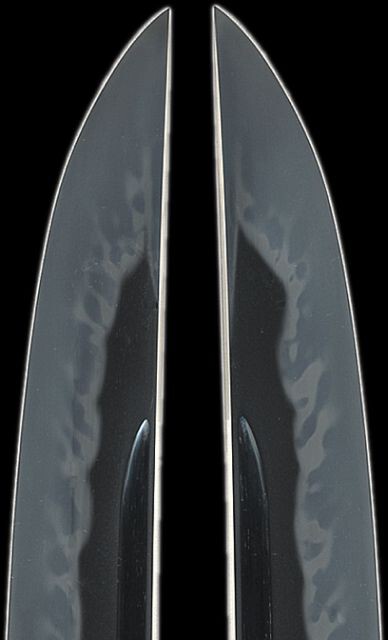

So far I have heard that the image is not too clear for detail in the mei. but it was advised to advance very cautiously in regards to the blade on the Token Sugita site. Remember there are some politeness issues here in regards to saying things about someone elses listed items. But from the pics listed, the deki doesn't seem to be as good as other Ono I have seen.........
And logically, that proves nothing.
Mike, it would be great to know the sources of the info about absence of "Ono" and how the date is signed or to have such information confirmed by Ono himself thru another post of yours. These important details seems to be a little confusing at the light of other posts in this thread.
[attachment=0]setsume.jpg[/attachment]

Nearly all the references we use are "old data". :lol: Never-the-less, they are the data we employ regularly in our studies. Also the data I provided is very close to the same period of which the blade in question is dated, and thus is fairly concurrent.
Just as logically, it dis-proves nothing either. Again, it was only a contribution of more data, and since one cannot prove a negative, I cannot prove that Ono Yoshimitsu did not do something.
I will also say that the catalogs I have of the Shinsaku presentations for the years 1998, 2001, 2005, and 2006 all have examples of Ono Yoshimitsu swords and all have "Ono" included in their mei. So perhaps there was a transition in his career where he began to include it? I think this needs further validation from Ono Yoshimitsu himself.
