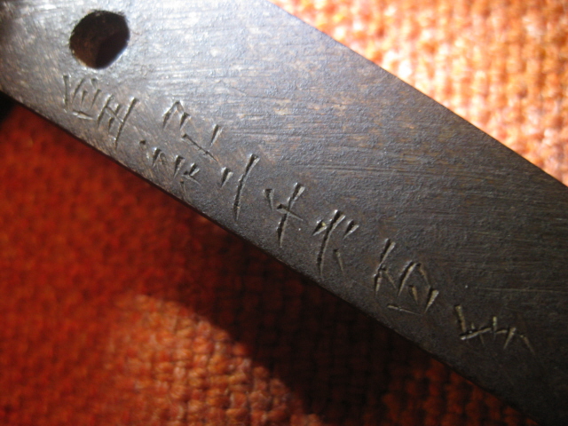

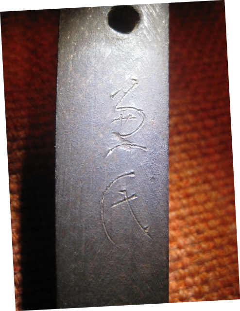

Can anyone translate the writing on the tang or have info on the mon?

I think Stephen is on the mark here...A WWII blade by a Seki (town) swordsmith, Kojima Katsumasa (sword signature says Noshu Seki Ju Kojima Katsumasa saku..."Kojima Katsumasa a resident of Seki town in Noshu province made (this)). The little seki stamp indicated manufacture as a war time sword, so most likely not traditionally made or tempered. The sword is nice condition, the scabbard is aluminium because it was (probably) a weight saving device....original paint has flaked off...quite common for this type of scabbard. The colour of binding is unusual...can't comment on whether it has been re-bound. I have seen original period dark green and various brown to pinkish colours...(just can't say). I haven't got my mon book handy, but someone will know.

Hi Stephen...it is hard to read I agree, so I checked all the Seki gunto smiths named Kojima and there is no Yoshimasa, but there is a Katsumasa...

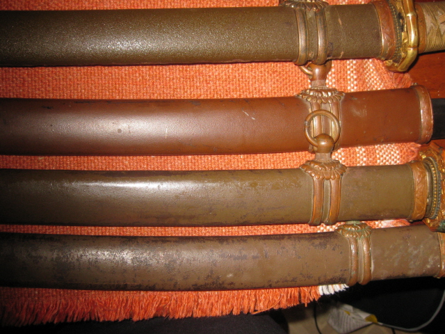

what it may have looked like....

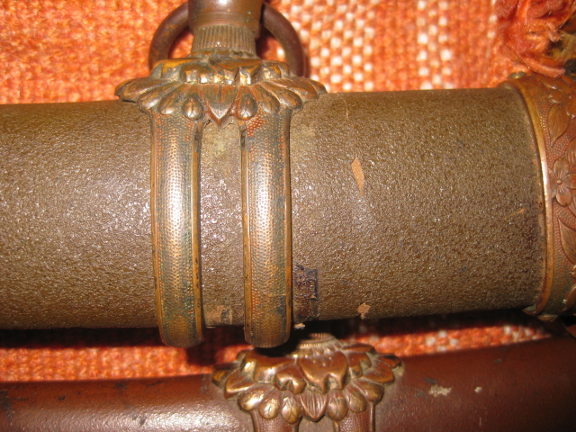

The saya at the top aluminum,the rest are steel,notice the finish.The aluminum has more of a stippled finish,and is over a fabric wrap(prob.had trouble getting the paint to adhear to the alum.)
Greg
Greg, that fabric wrap over the aluminium is not a treatment I have seen before...I have only seen linen or similar over wood and then lacquer on top...these are usually superior quality mountings. Are you sure there is aluminium under the linen? just asking...
Greg
Greg,

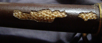

I would opine that the "paint" is in fact urushi, real lacquer. The fabric wrap (hempen cloth??) is I believe a typical underlay for lacquer even on old koshirae, and indeed I have seen cloth under lacquer on an antique saya with lovely decoration - regrettably, like yours, this knowledge came only because the lacquer had suffered damage. I imagine this gunto saya lacquer was quite expensive at the time, as good lacquer is today, and as it always has been in quality work. What blade is in this koshirae?? Can you post some pics of the nakago??

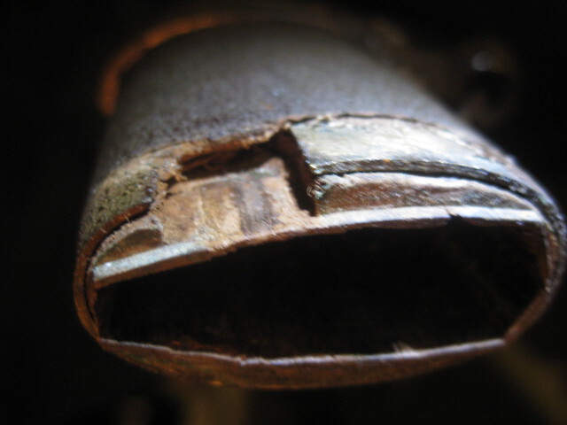

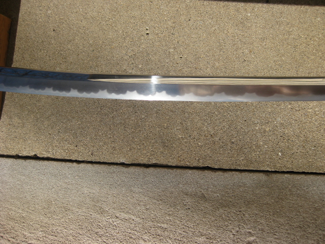

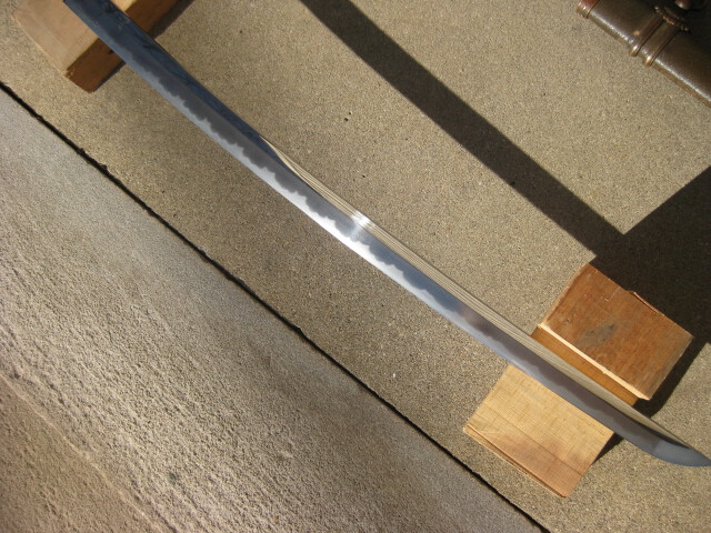

This is the opening without the koguchi,definatly a metal sleeve.I examined it a few months back to see if could make a new liner for it,now after reassessing (and looking at the material it is made of)it may only go back a few inches.It looks like it is made of brass,as such,if it were the whole leghnth it would probably weigh as much as a steel saya. I oridginally thought the coloration was an "iridite" coating(a protective used on aluminum that is easy to chemically apply)And as far as refering to the finish as paint I sometimes generalize to simpify a statement.A few years back i found out how this "irushi" surface was produced after removing layers of black and red paint from a '44 pattern saya (similar or the same texture)---lets put it this way,I used laquer thinner and tricholrethane 1,1,1,(did test area first)it didnt harm the oridginal finish at all.When i enquired about it I was told it was probably irushi mixed with a filler material(wood pulp).That said-here are some pics of the rest of the sword.
Greg
Yes, you are right, either a metal collar for strength or linen over aluminium...I've never dismantled a urushi saya so don't know if a metal collar is present or not...interesting.
Geo.
PS...it is doubtful that you will ever find a "first name" for Maeda and it is not even sure that that was the officer's name. After 1911 or thereabouts, anyone could use any mon they liked (except Imperial mon) so...?
Have you ID'd the maker and date yet?
