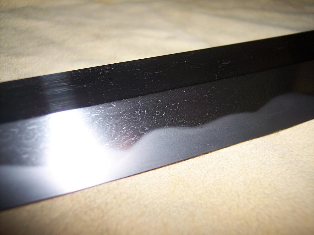

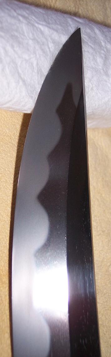

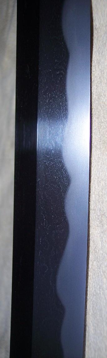

sanjuro Posted May 31, 2010 Author Report Posted May 31, 2010 I thought a couple of images might be of interest...... (Try and stop a new dad from showing baby pictures). Quote
